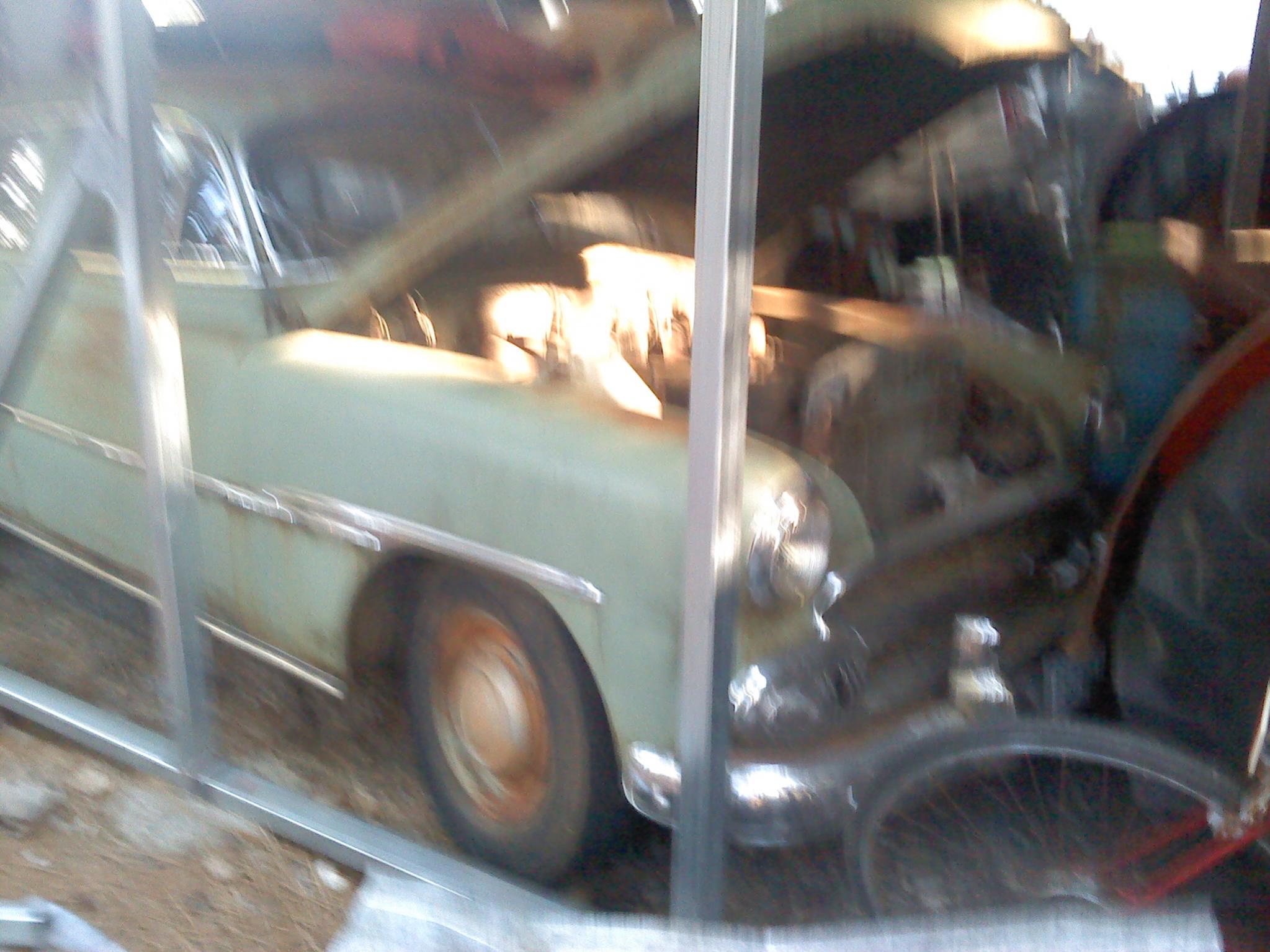

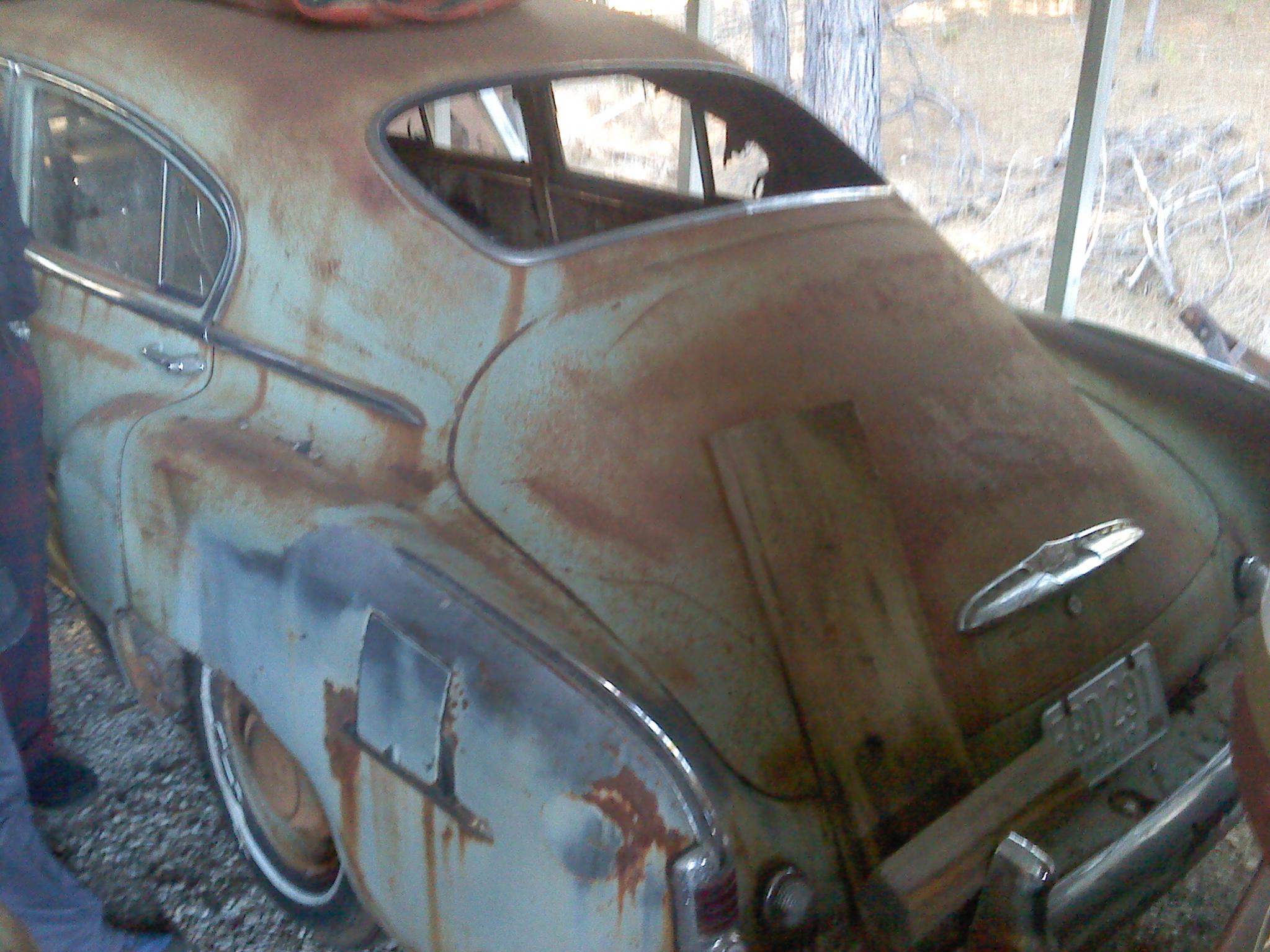

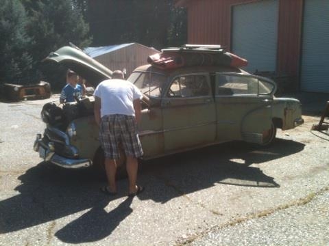

    My apologies for ****py cell-phone pictures but it gives the story some illustration. So here is this beat down '51 Fleetline. Floors half gone, every piece of gl*** is either chipped, cracked, or delaminated to a serious degree. Not a single piece of this car is free from either a dent, a crease or some rust, maybe some of the stainless is undamaged...

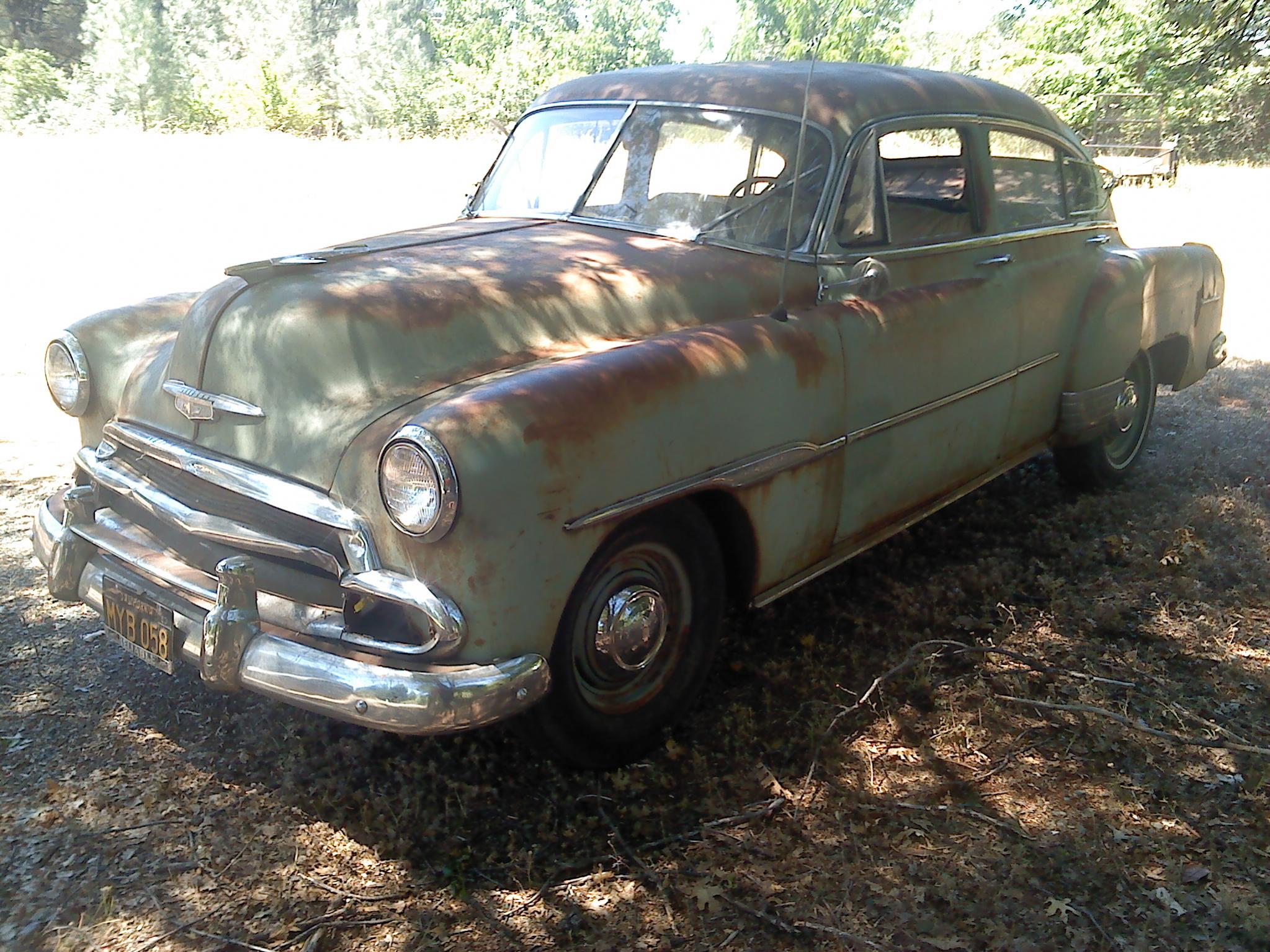

    But it runs. Quite nicely, to be honest. Temp holds perfectly at 170 or so and oil pressure sits at 20 pounds 'til I tap the throttle. The fuel guage reads at a 1/4 and the amp guage indicates all is well. No smoke, no lifter ticking, no warm rattle from down low. When I push the clutch in, I hear nothing and the old column shift slides thru all the gears like ****er. When I pull forward and then back it back up, the clutch engagement is smooth with no chattering or shuddering.
    Here's the story Floyd tells. The ***le I got indicates that his folks got a bank loan and financed the Chevy in 1959. Floyd can't remember what they paid for it, but the mileage was pretty low, and he remembers that it was like new, very clean. Sometime in the '60's, the old 216 went down and the 235 was bought from a repair shop in the Bremerton area and installed. ID pad is stamped GAA655240. Carter carb and full lifter cover looks more like a 216 to me, but maybe the early 235 had the 2-bolt valve cover and full-length sidecover.

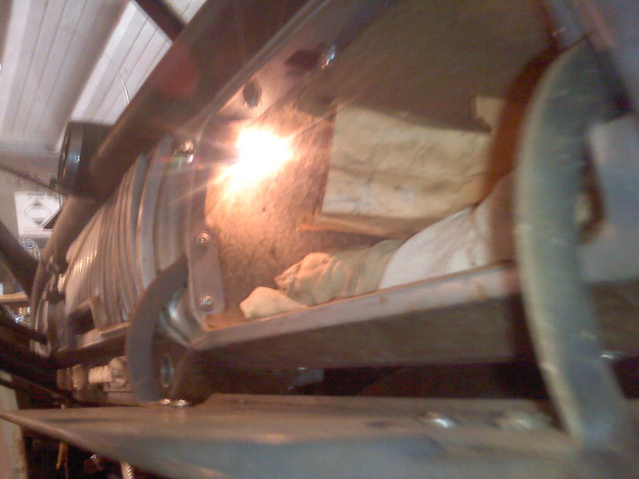

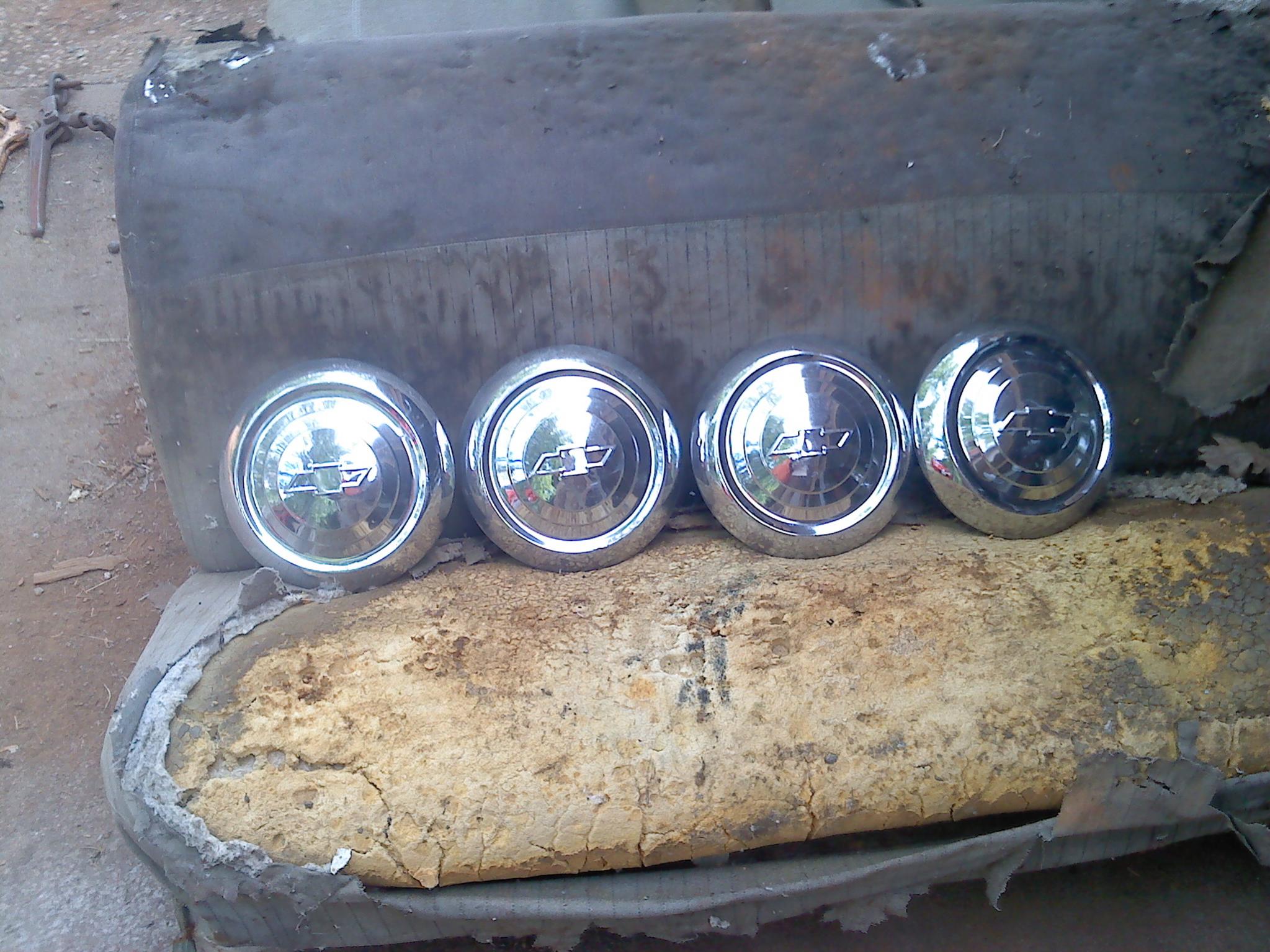

    Still has the original rims with bias ply tires and tubes. All 5 rims. Still have all 4 caps. No broken clips. Weird. Dropped the tank tonight. No broken bolts or stripped threads or hardline fittings. About 3 gallons of turpentine in there, but not rusted out, no water and 6 rinses or so with the filtered turpentine got the tank pretty clean. Going to buy a battery on Friday and order a headlight/turnsignal harness from Chev's of the 40's. Old cloth wiring is pretty toasty! Will keep ya'll updated.. my current (OT)daily driver goes to my almost-16 years old Princess on August 30th, so that's my time schedule to get the old girl driveable and current with DMV.

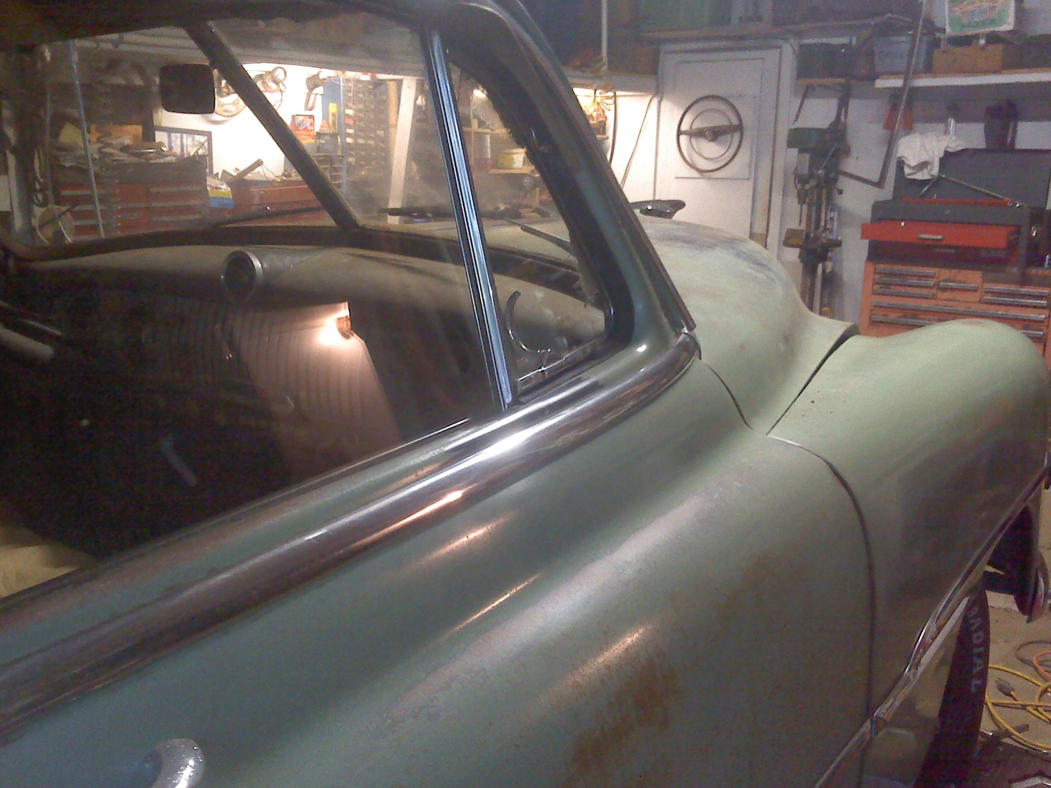

    A lot happens in a week. Father's Day was awesome for me, spent about 6 hours in the garage and got a lot done. My almost-16-year-old-princess has been coming out to the garage and hanging out. She textx her friends and asks questions about what I'm doing and seems pretty interested. I let her change the station on the shop stereo to Top-40 country ****, and once in a while they play "oldies" from the '80's and '90's and I laugh and feel old.
    hemiboy- when were you ripping up Walla Walla? Went to school in College Place from '89 to '92 then came back to California. Had a '46 GMC I drove around for a little while. Former dogcatcher's truck for College Place... bought it from a retired judge in 1990 for $100. Different story tho... got the ****** for it for $50 and a 5th of whiskey off of an old gal with a "closed" wrecking yard on the Oregon side south of town. Good times! Drove that ****er down I84 one weekend to see friends... 50mph in the slow lane with that old 228 humming, hand throttle set and windshield cranked open..
    So a couple of hours each day after work and about 50 bucks in parts and we have brakes! Good brakes too, lots of firm pedal. Pulled the drums one at a time and cleaned/inspected/replaced when called for. So impressed with how well-built something like a simple Chevy from a different era is when compared to newer "improved" stuff. I love my wife's 2013 Civic SI. 200 hp, 6-speed, HUGE brakes .... and no soul. Fun to drive and easy on fuel, but I am not attached at all.
    Showed Jazz (aka "princess") how the column shift works last night and that turned into a reminder about the starter ****on on the dash.. memories of my mom leaving me (4 yrs) to watch my sister (2 yrs) in the '51 sedan at the BofA parking lot in '73. I hit the starter ****on "p'tending to drive" and jumped up on the curb. Don't recall a c****at or any seatbelts, that backseat was like a warm cave, loved the smell of old horsehair and cloth and stroking that fuzzy yellowed cloth headliner. Slept back there a lot on trips, hanging on the seat back while pops drove and my mom would read a book to us, 'cause there was no radio out in the hills and she would sit sideways, leaned up on the door a little so my sister and I could follow her finger and see the words.. f*@kin' eyes... (missin' mom now...)
    So.. trunk floor in and POR 15'd and seam sealed, gas tank cleaned and inspected, ready to re-hang, brakes gone thru and serviced and bled, now the wiring has to be gone over, lots of bare copper under the hood from heat/age. One last shot... car came with no keys, pulled out my "lifetime" collection of NOS gm keys last night and found one that actually works in the ignition switch! None would work the doors/glovebox/trunk... but the ignition switch! A good sign for sure! Off to work now....

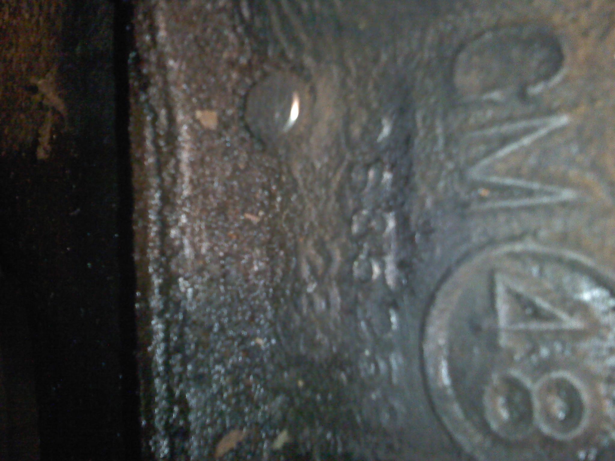

    Oh, here's that block casting "money shot". Sheez, what a hillbilly ******** this is turning into, huh? Have to confess tho, it's like therapy. Coming home after work and hiding out in the garage with this BigGirl... its all basic repair/replacement and m***aging old metal. Lots of scrubbing... Got the dome light working with the bulb that came in it. The door jamb switches needed cleaning and a spot of dielectric grease.. I love that ****. It makes my heart happy and I remember old times when stuff was simpler and made more sense. Got a warm fuzzy when I pulled the cap off the distributor tonight and it says made in the USA inside. When was that made? Kinda sad reminder about this brave new multicultural/outsourced/borderless experiment we got talked into. Sayonara for now...
