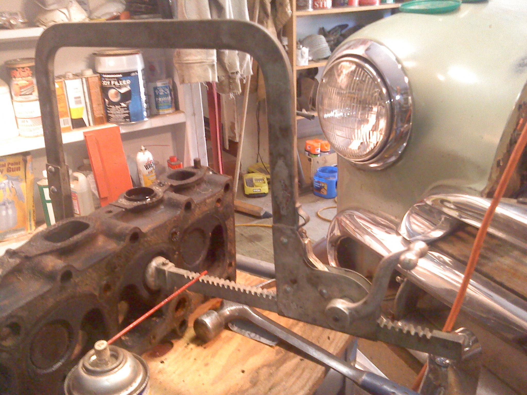

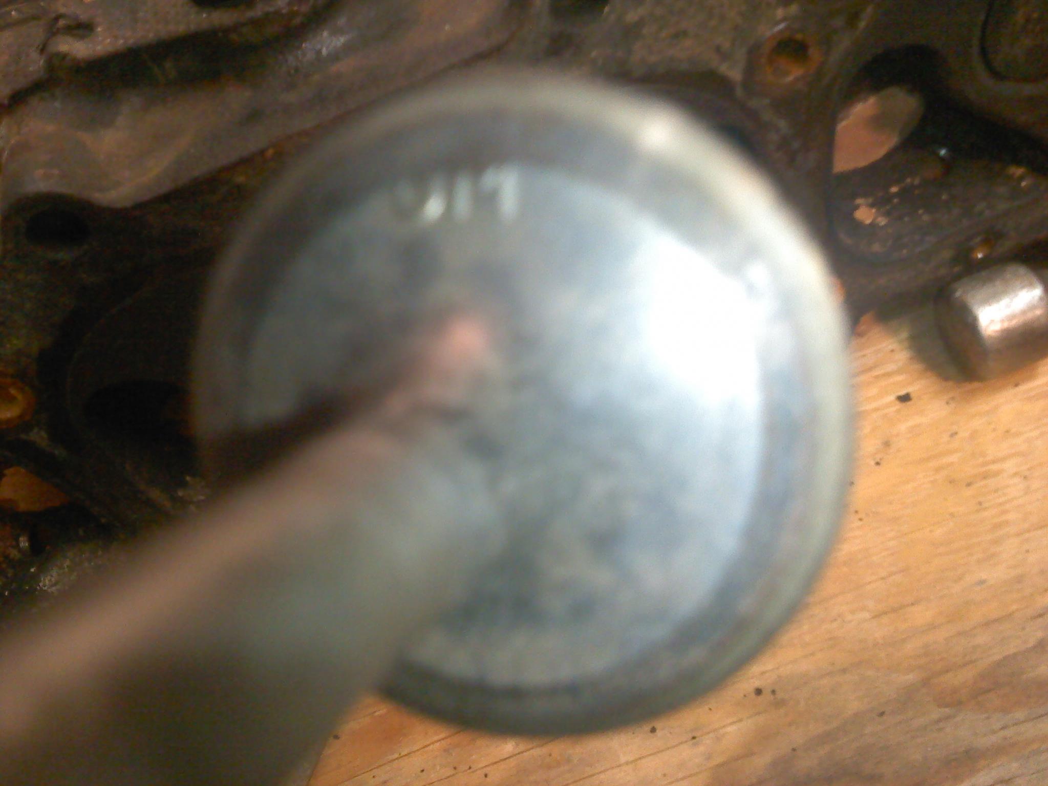

    Got the head off yesterday and cleaned and re-installed the intake valves. Exhaust look great. Kind of heavy white deposit built up on the faces on exhaust side. Intake was a gooey black mess, ports all full of varnish and stems badly stuck. Got out the trusty valve spring tool (can't honestly remember where that came from.. yardsale maybe?) and in about an hour had everything right. Intake valves were fresh cut, seats were good, and guides are tight. No sludge-like deposits anywhere. Recently rebuilt as Floyd said. Gaskets were in good shape and the piston tops and cylinders are gorgeous. All the pistons are numbered and stamped with "J". So now I will clean everything up and wait for a little cash to buy some gaskets with and put it all back together. Pictures...

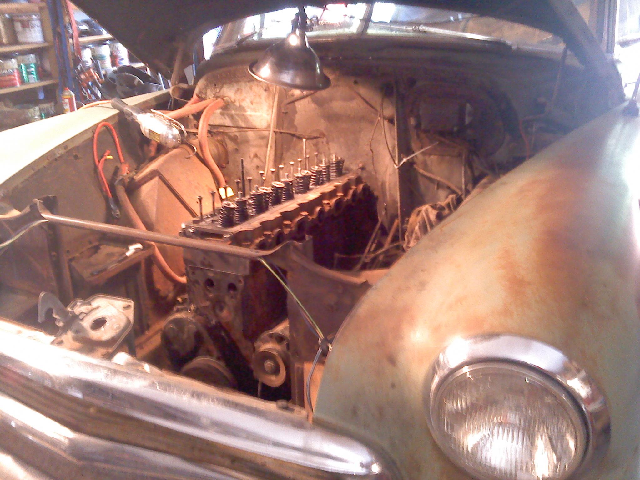

    Dang! Been 2 weeks and I am just plugging away since the last update. Local NAPA got me a headset for $65 and I have been getting an hour or two in the evenings. Football started for my 9 year old and so that takes time, as it should. Too much fun watchin' youngsters learn the game!
    Slowly getting motor back together. Rocker ***embly cleaned and put on last night and right rear floor is patched and seamsealed. Left rear remains to be done and finish putting the motor back.
    Then it is back to finding all the little gremlins in the heater/defroster, the wipers, the turnsignals...
