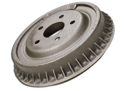

    there was one guy that found out brake drums had missing balance weights causing vibration?

    Those coil springs around the outside of the brake drum? There aren't any on this car, but now that you mention it, a lot of the older rigs I've owned had them.

    The spring around the outside of the drum is to cut down harmonic resonance aka squeaking during braking.
  16. 2racer
    Joined: Sep 1, 2011
    Posts: 959
    2racer
    see the weight welded on drum, if missing will be out of balance

    I read somewhere that the drum spring was to help cooling. I'm not sure how much credence to put behind that though.

    Little spot welded weights, huh? I will check. Just had the wheel off last night... stuffed a deflated basketball and some lumber up under the front fender and used a rubber mallet to work a big dent out right above spindle centerline. A few little dimples to hammer-and-dolly out later.. not great fenders anyway... rust out on the bottoms in the back and near where the grille bolts on.
