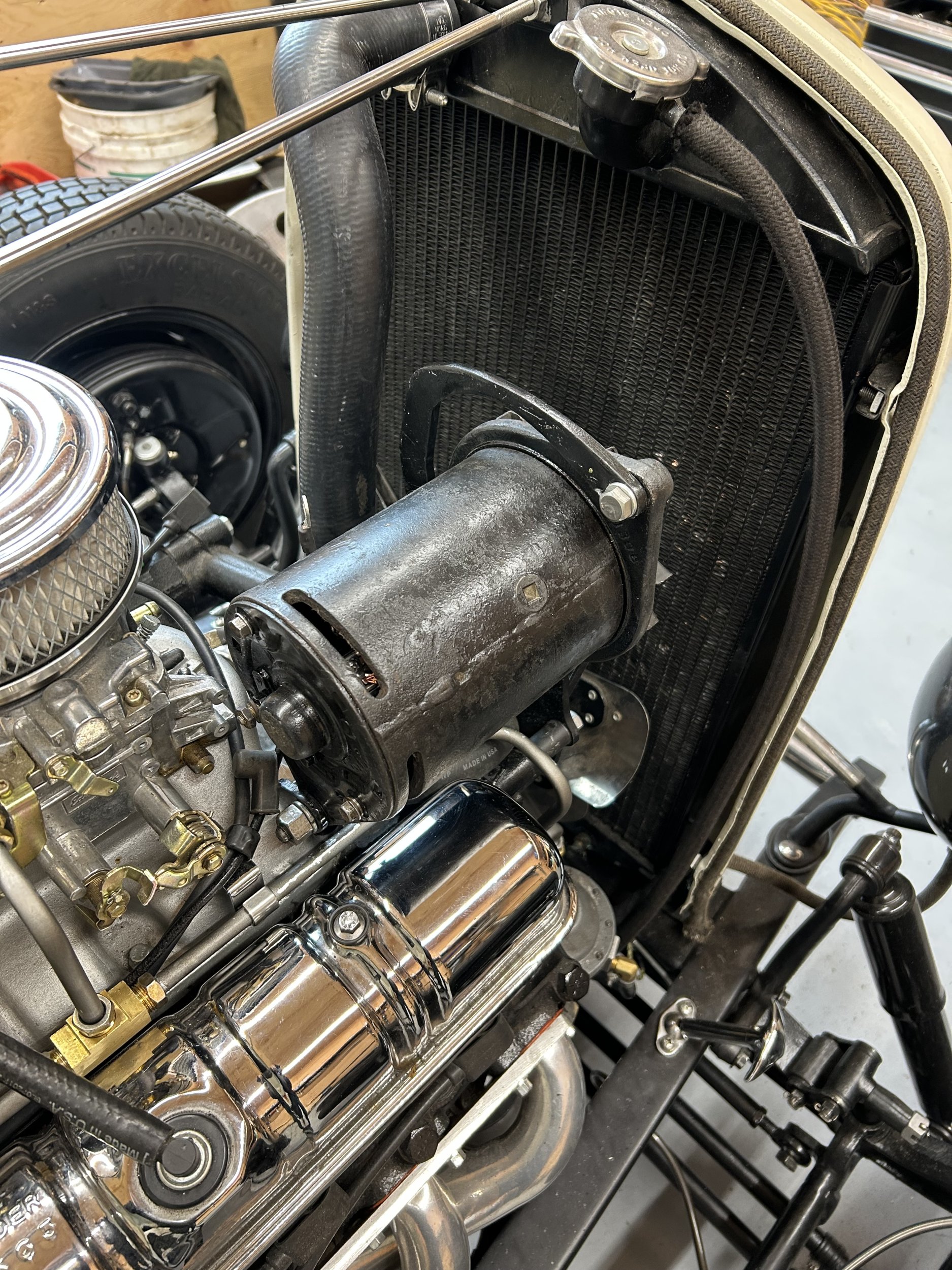

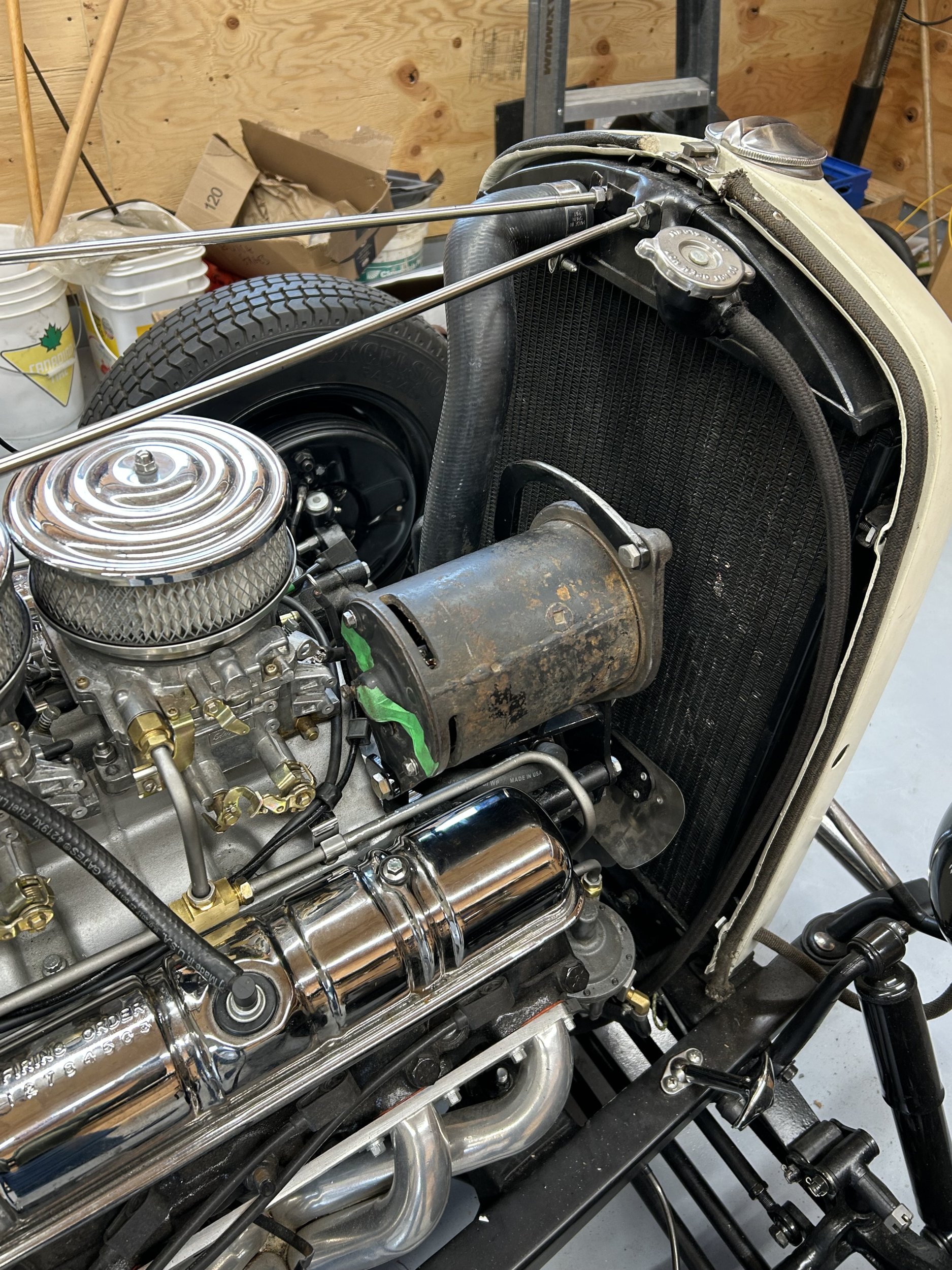

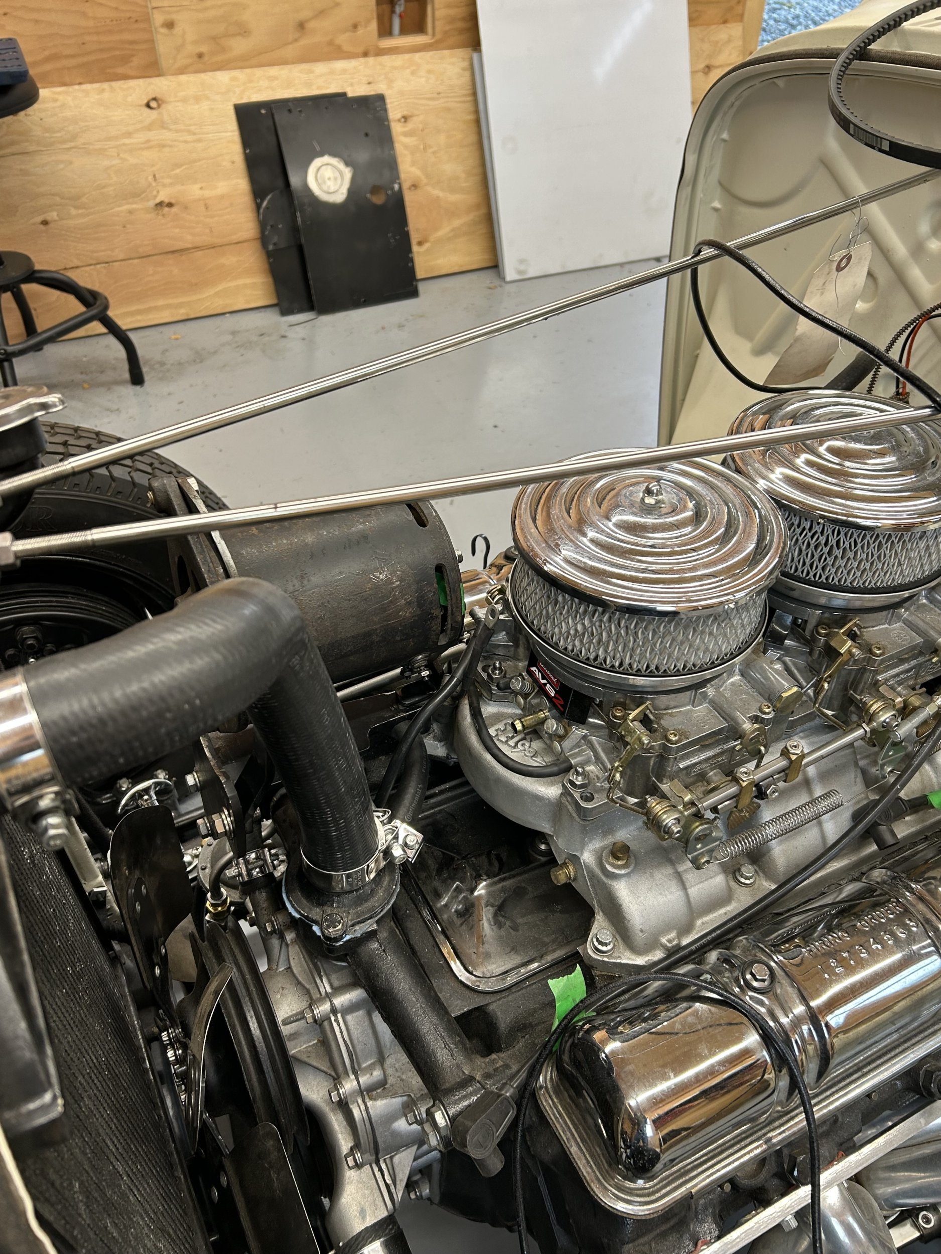

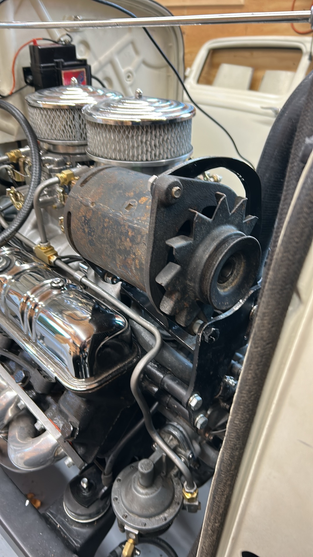

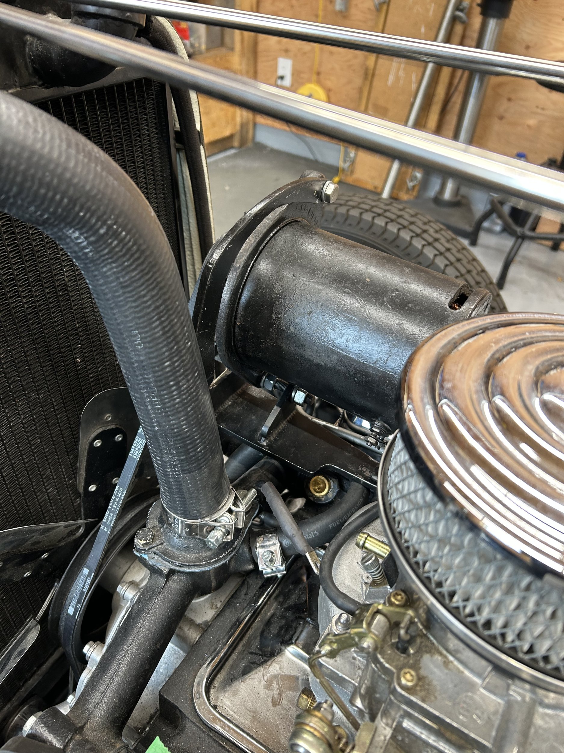

  1. Spent the last couple of days getting an early 60’s Ford gen fit in place of the alternator. The alternator mounting bracket with some modifications is going to work out in my favour. Awaiting a friend to repair the armature and then I can dial in the belt alignment. In my opinion the generator fits the look better than the alternator.

  2. Better pics

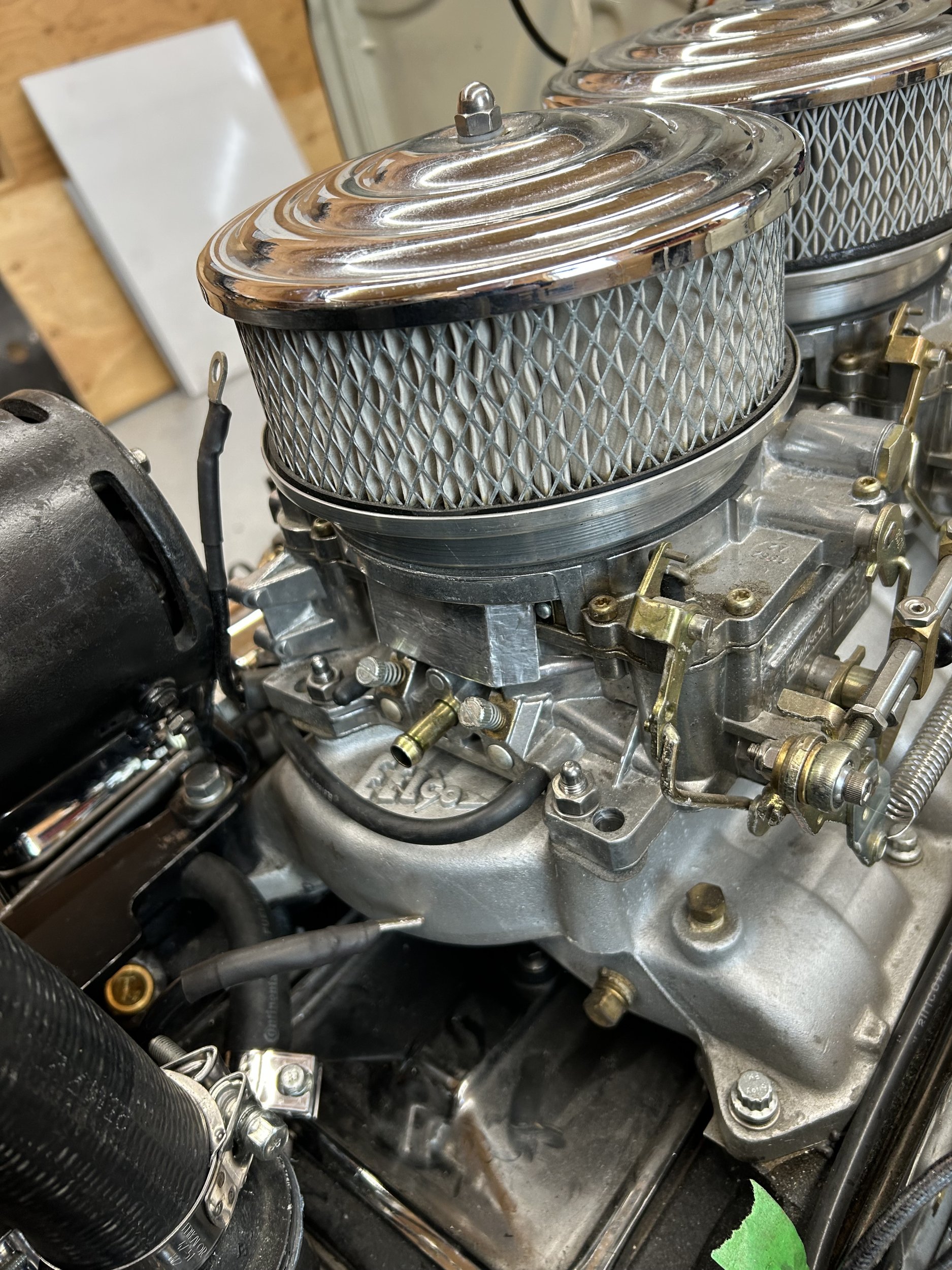

  5. Finished the install and wiring to follow. Also covered up the advertising on the carbs until I get a chance to remove the drive rivets. IMG_9481.jpeg IMG_9480.jpeg IMG_9479.jpeg IMG_9482.jpeg

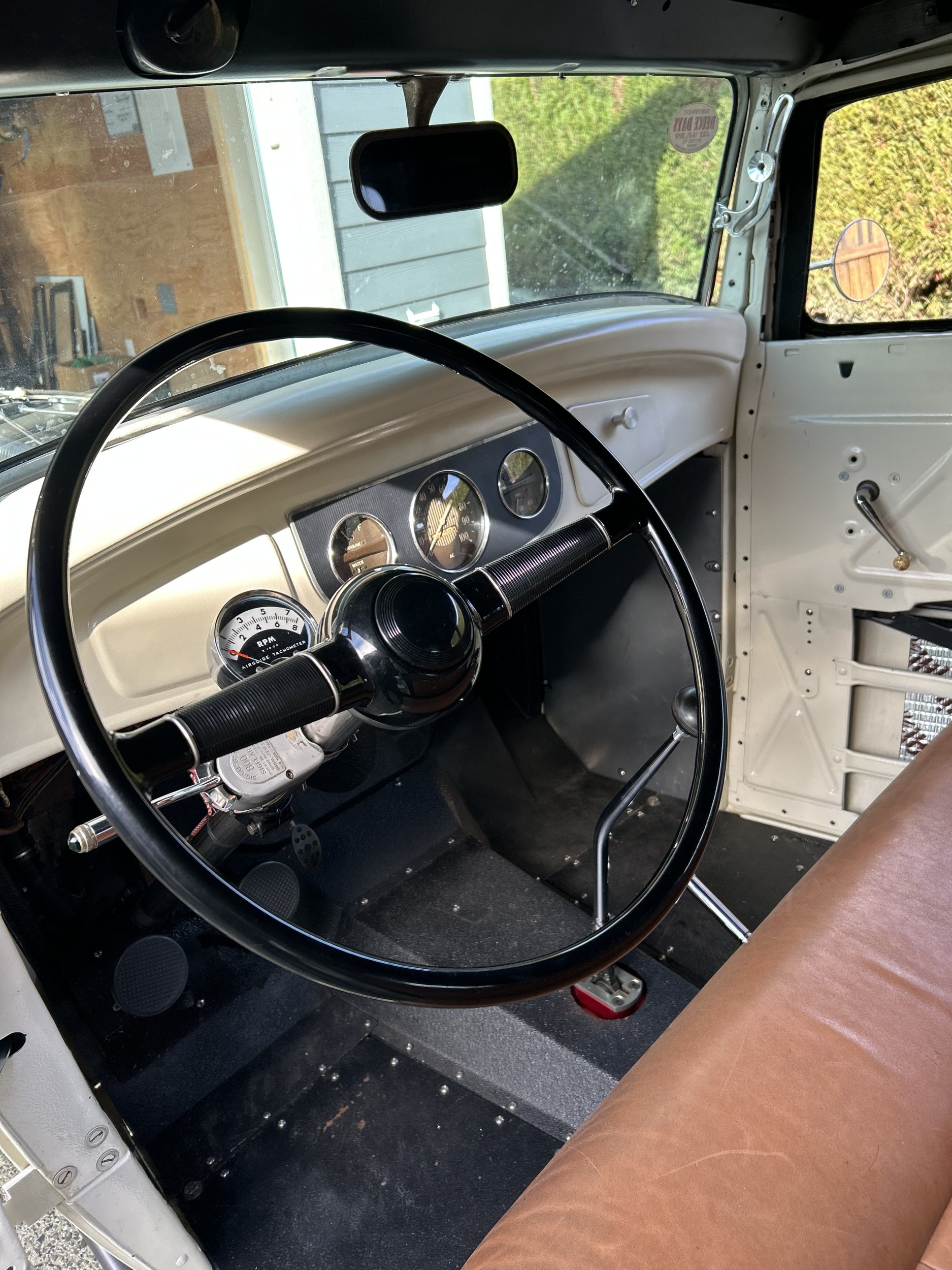

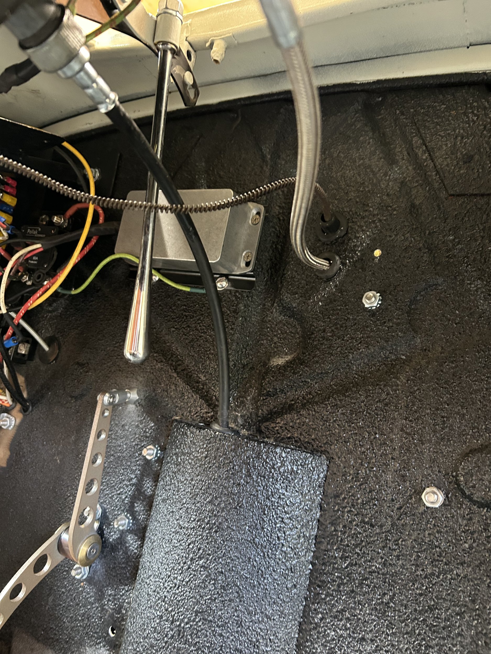

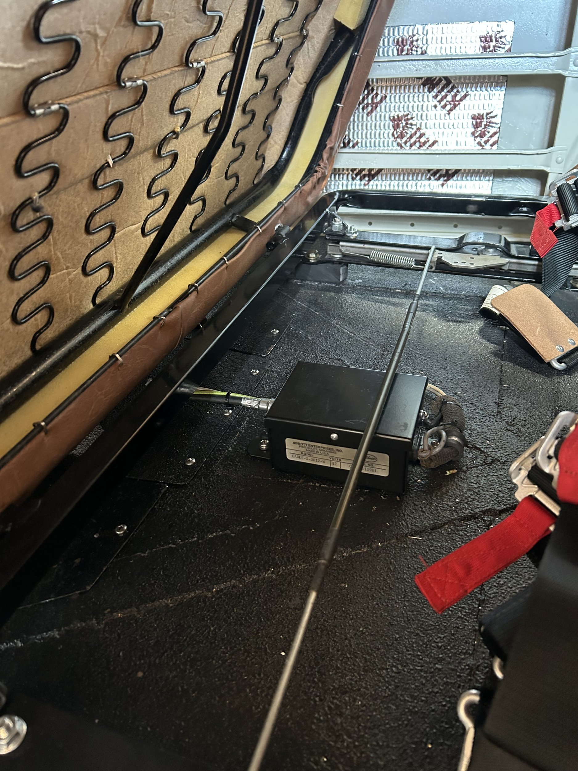

  7. Finished the install on the Cable X speedometer drive. It is converting the VSS signal from the Tremec TKO 600 to the mechanical 1934 Buick speedometer. The space to connect the cable to the transmission was limited. It would have required an angle drive plus the right gear for tire size and rear diff ratio. This makes it so much easier.

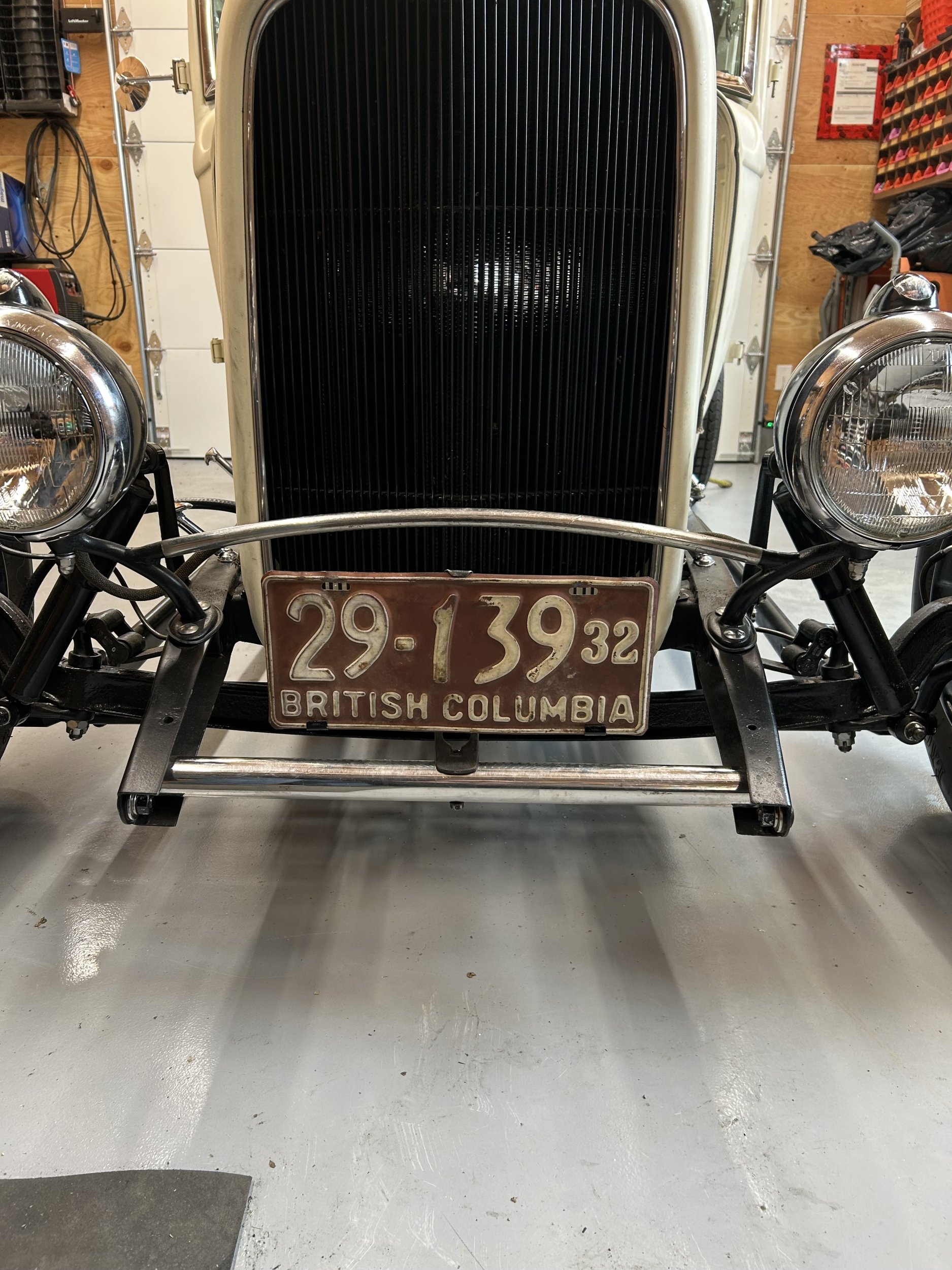

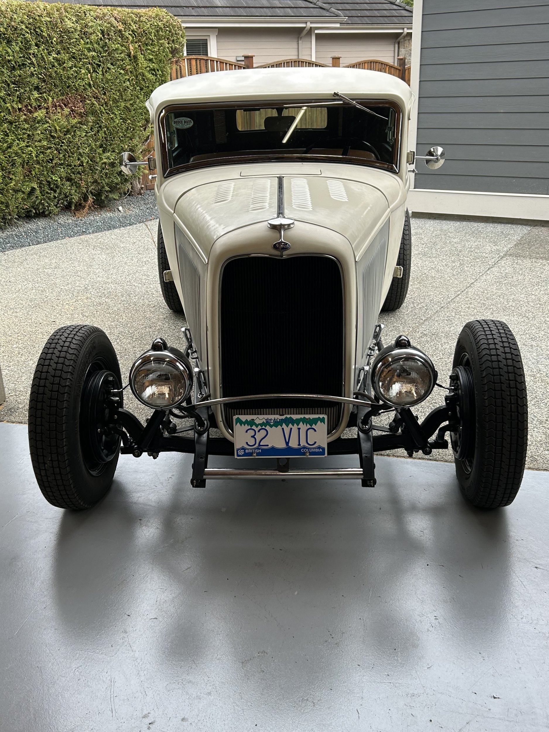

  8. I didn’t want to run a front plate but our province says different. The bracket is another piece that Henry made for 1932.
    bchctybob, woodz, Hot Rod Ron and 3 others like this.

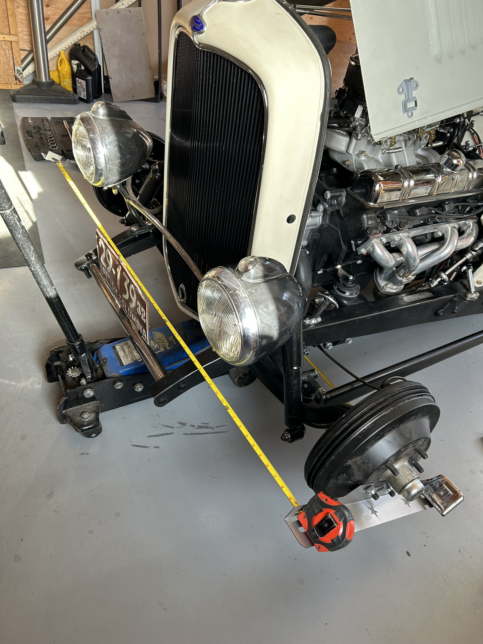

  12. Dialed in the alignment on the Vicky this evening. Ordered these online from offshore and they sure make it easy. I am sure there are simpler old school ways but this was vey accurate and easy.
  13. I installed a 1934 Buick instrument panel, gages and a 3 window dash in the Vicky. The speedo was a bit of a challenge for several reasons, the cable end at the speedo is not like anything I had seen plus it’s mechanical. Utilizing a cable at the transmission was difficult due to interference with the exhaust. My solution was the use a Cable X system which converts an electronic signal via the VSS on the Tremec TKO 600 through a motor in the box. With the use of dip switches, calculating wheel diameter, rear differential ratio and pulses from the transmission a chart is used to determine position of the switches. It took me several attempts to get it right but it is bang on. Cannot hear anything under the seat coming from the box.

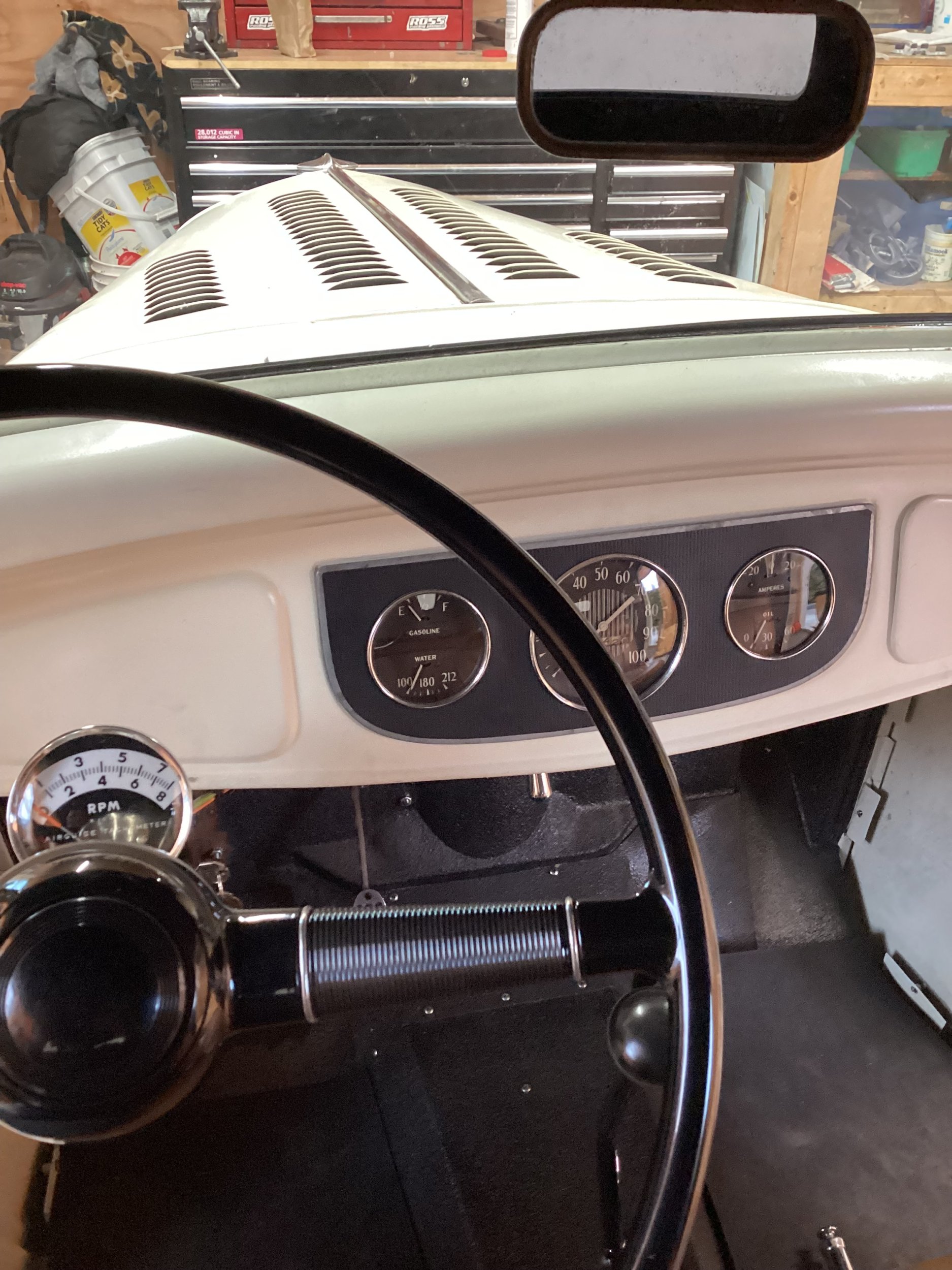

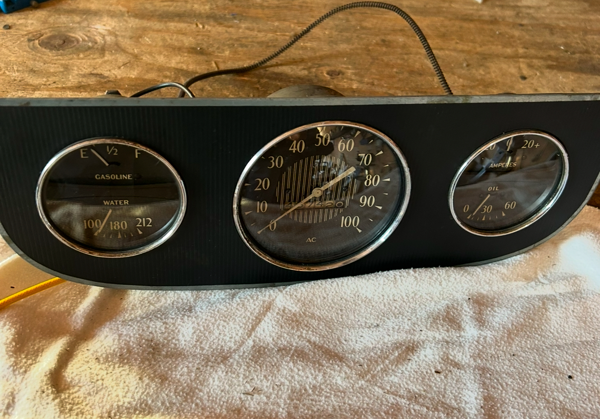

  18. A better pic of the 34 Buick instruments and panel. Bonus that all gauges work. It was a bit of a challenge but got the Airguide tach working as well. Need to deal with the poor illumination of the gauges at night. IMG_4873.jpeg

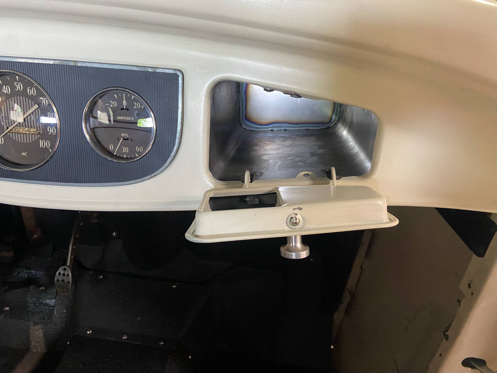

  19. The 3 window dash in my Vicky needed a glovebox and the Brookville version wasn’t in my budget or an original. Charlie’s Rods & Customs Speed Shop on Vancouver Island made one. Very impressed with the results
    att.Kd-XV1Fqh2joyMhLstsfh-vdH2Zsqv_XAr5P1fB5mLQ.jpeg att.yvVmLBqtP-iauOjIiIzO7xkHNIbIDQSVvkEqobHQQH4.jpeg att.BwDA1qdmiGsHt0TxyIfZzsc-D2G3Vhgp76zs52UviZI.jpeg

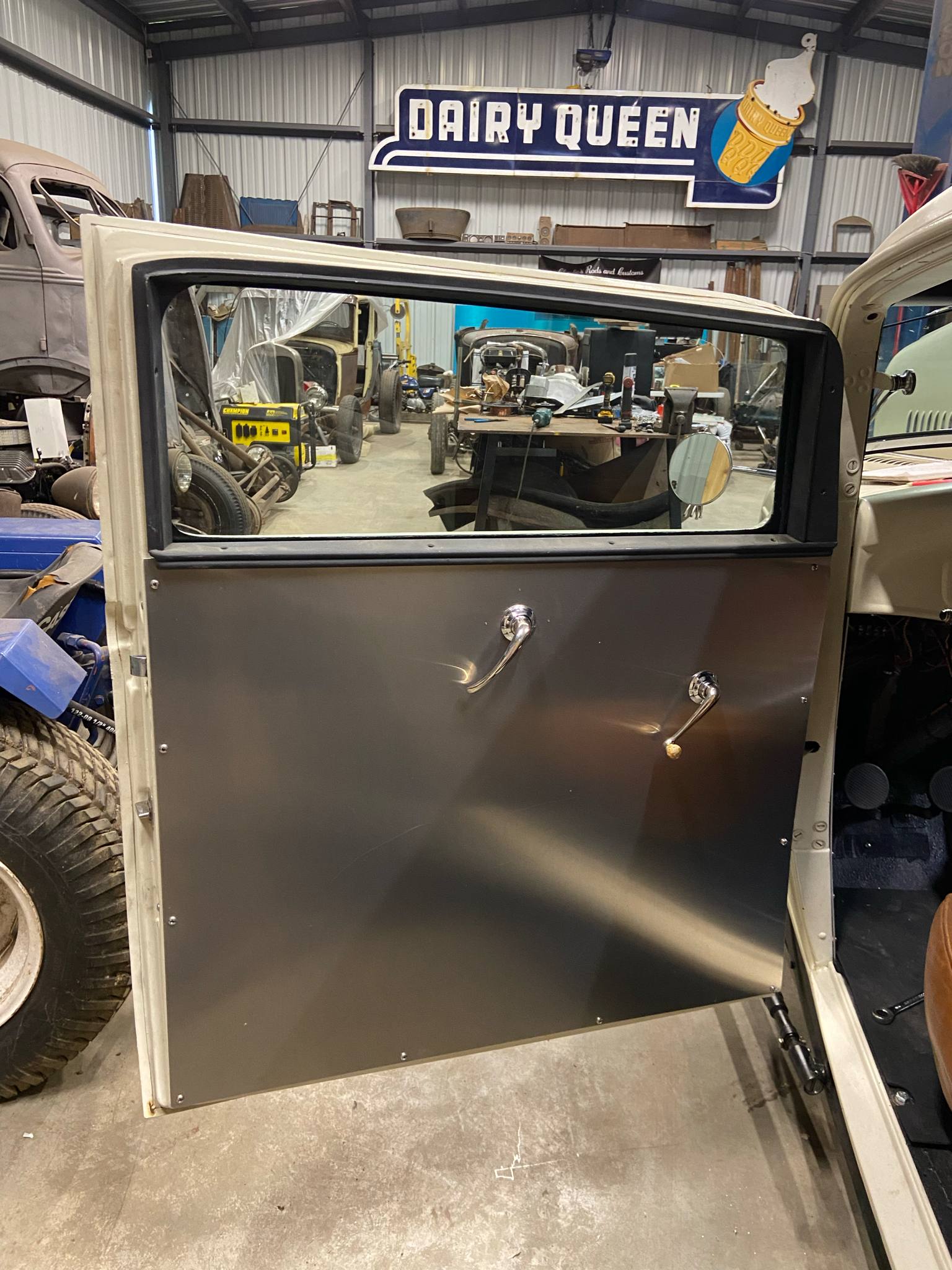

  20. Door panels fabricated and installed in the Vicky. Just to be different, they are aluminum. att.JwGcNAOpS8Vb1rOjurYqlofx0Hg2UEa5qXvNcFU2Qn0.jpeg

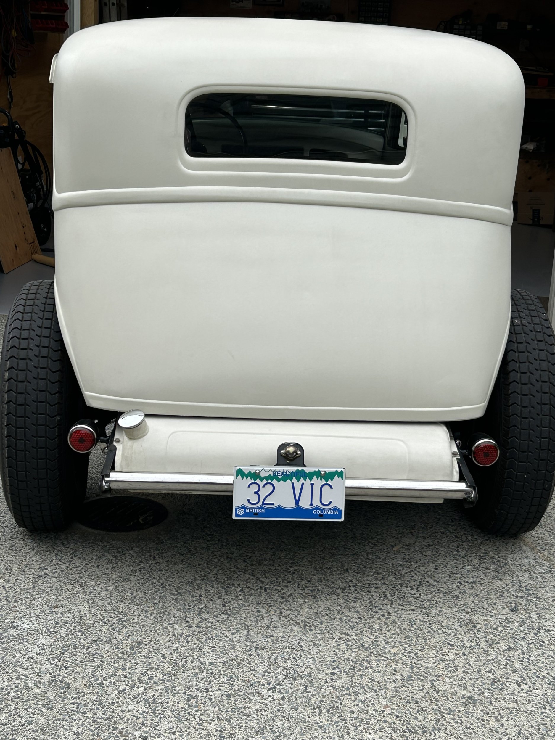

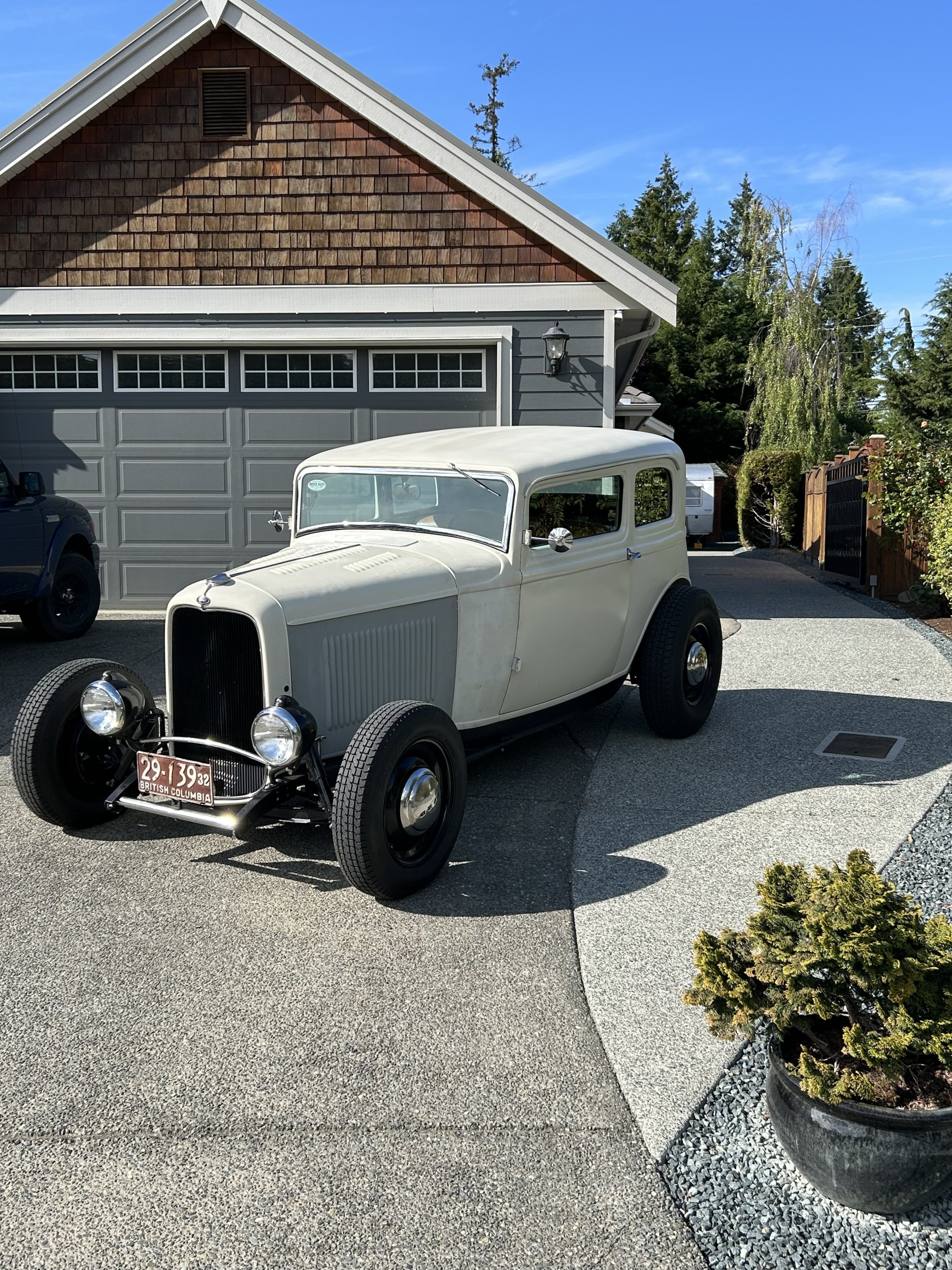

  23. Personalized plates arrived today. This should end any confusion.
