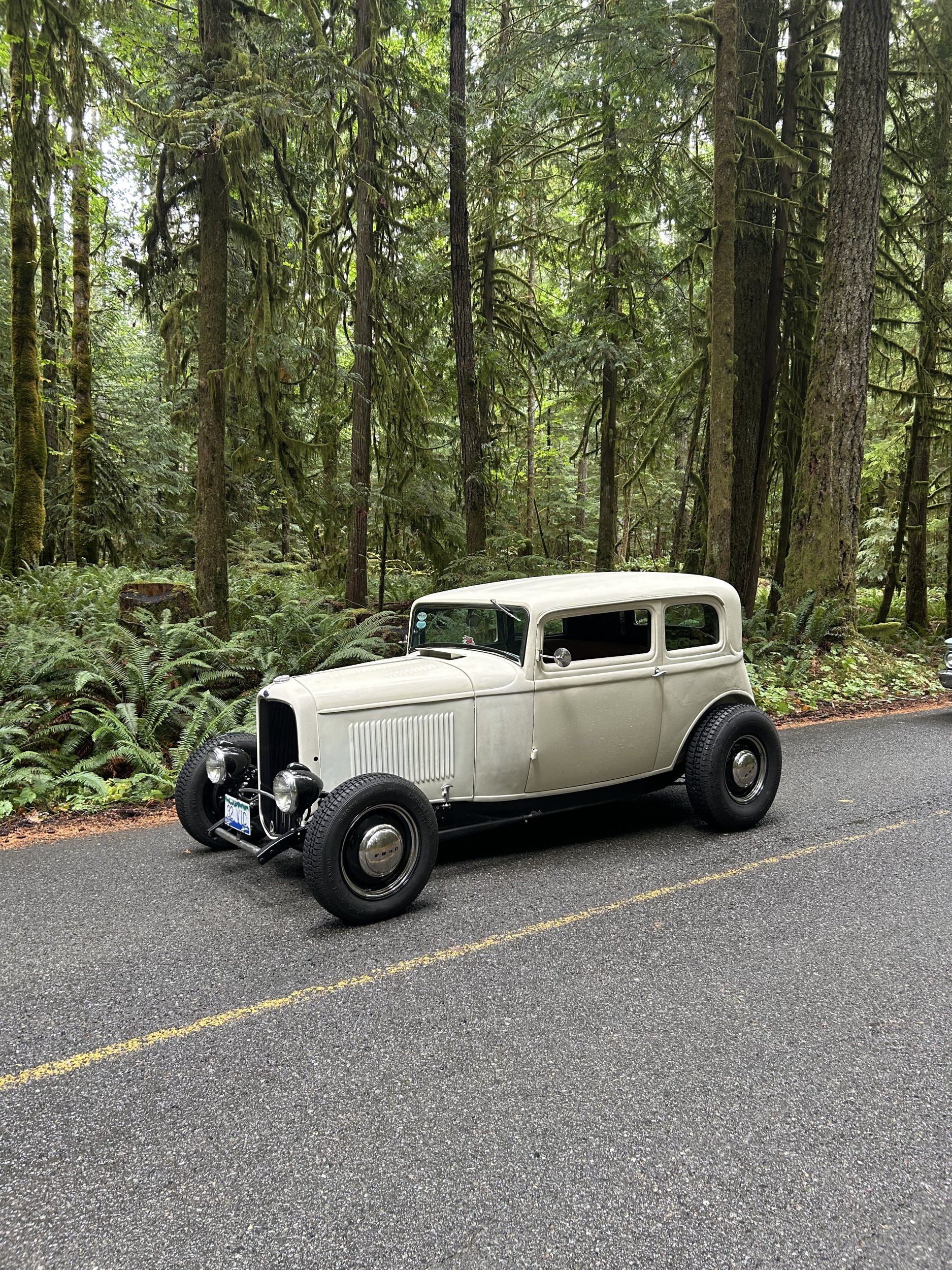

  4. Took the Vicky to Mill Bay on Vancouver Island Saturday morning for the LG Speed and Kustom reliability run. Raining when I left Parksville and cleared up for the day on the drive. The Buick nailhead is running fantastic with no complaints.

    Roger, How was the turnout for Lee’s run? Also I have found that when the differential vent is in the center close to the ring gear it will fling off the ring gear and be a problem. If you find that the catch can fills up try moving the vent fitting to one of the axle tubes.
  6. It was a great turnout and definitely a lot of cars that I have not seen. Each year is definitely getting better. There was a pickup from the mainland and a car from Salt Spring Island.
    Thanks for the tip and I haven’t checked it since install. I was more concerned with the pressure buildup and that is no longer an issue.
    The car is running fantastic and since resolving some steering issues, it’s really nice to drive. I need to reroute the exhaust further back as it presently dumps before the diff which is basically behind the seat.
