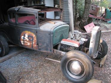

    Here are some pictures of the first time I saw my new project. The car was previously owned by my friend Tim's son, Bob, who needed some cash. Now, the car is mine and the cash is his (in several payments). Tim is letting me do the major build stuff in his garage.

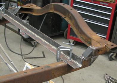

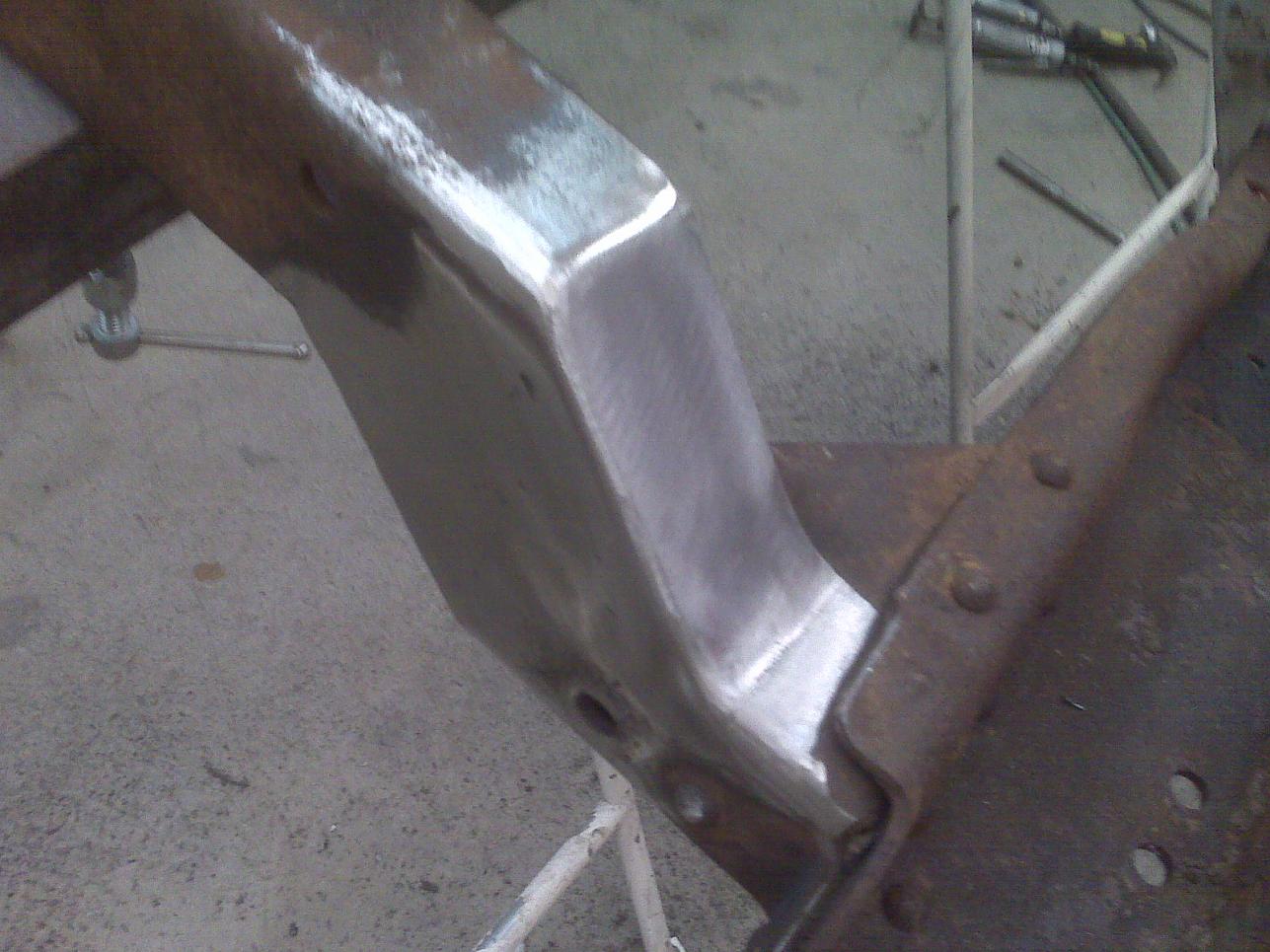

    We updated the brakes (thanks Jim and Tim) and the now moved on to the frame. We made the step the height of the frame. Thanks for the guidance Vern and Mike. It's a good thing my friend Tim took some welding courses, the JB weld I had in mind would have been a rough haul.

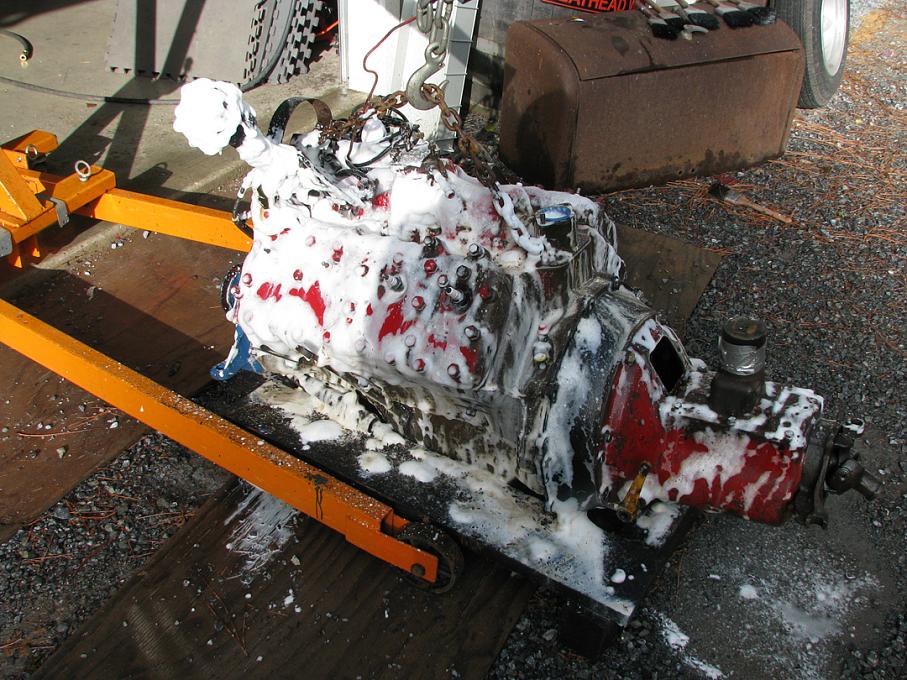

    Finally it it time to try and start stuffing in the mill. This is all a learning process, so we are modifying things as we go. At each step we get giddy and throw the body back on and jump in. This time without the body but the seat and motor in, we feel like we are sitting in "THE BUG". We are switching from the car water pumps to truck water pumps so the 8BA can fit between the rails and not get hung up on the mounts. Next week we will actually clean the motor -- we plan on selling the vintage grease we scrape off to our buddies over in Europe who are in need of vintage stuff.

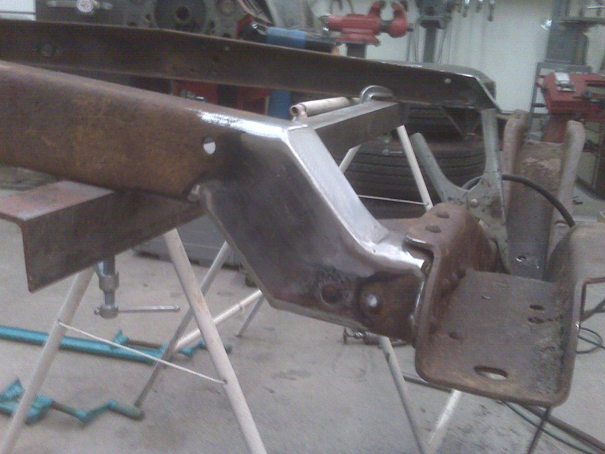

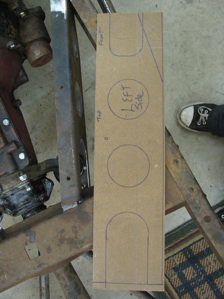

    Eden Valley Garage works on a Gennie '34 Henry steel crossmember while the rest of us sleep. This gives me the tranny mounts AND the ability to mount the '34 pedal assembly. When it is all done, it should look like Henry built it this way (or should have).
    Thanks again to Tim (working like an elf on a sugar high at the north pole).

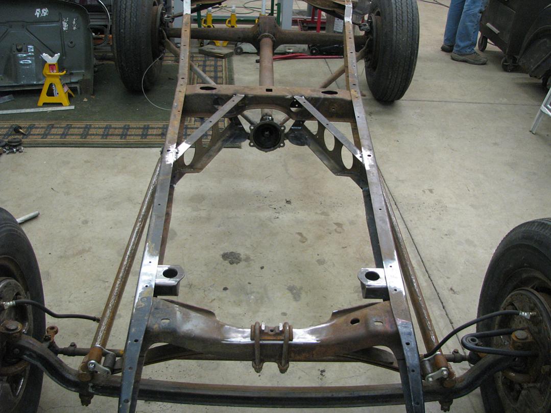

  26. Some more progress today. Finished up the k-members and made up a cross support from parts laying around. This will go up inside the original cross member and tie into the rear of the k-members. Brent will be here tomorrow and we'll get lots done and drink more Mtn Dew. More pictures tomorrow...

    All of the mounts are now in, the forward supports that Henry would have been proud of are hooked up (thanks to Tim's Eden Valley engineering) and the mill is sitting right where it should (matched up perfectly).
