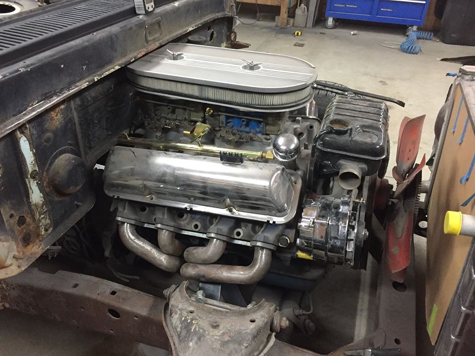

    No such thing as "numbers matching" in the Ford world. The closest you will get is date codes being in acceptable windows.
    Keep the FE. My current project has one and they are good engines. Watch for oil leaks at the head/intake junction and the back of the intake.
    SPark
    54 ford coupe and loudbang like this.
