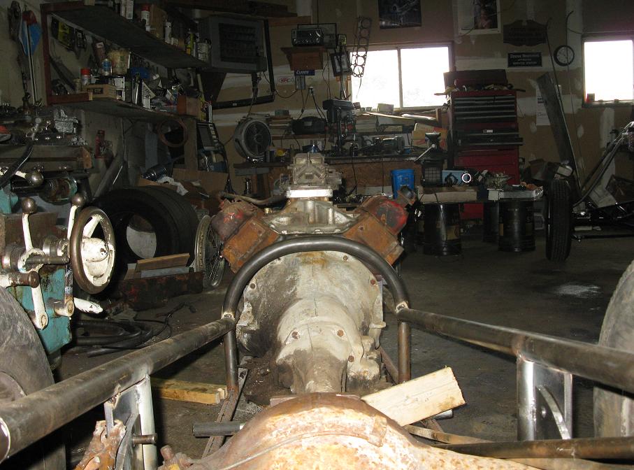

  3. Since the rail was designed originally to take a Jag six. I was concerned that I would have trouble fitting the 318 and trans. I did some minor mods to the design. removed all the bracketry from the trans and cut off one boss intended for 60s style kickdown linkage and it now fits with even a bit of wiggle room. The starter (which is always a h***le on a V8 Mopar rail ) sits ahead of the upright right out in the open and should be no trouble in looks, service or operation. The block is about 3/4" narrower then the trans bellhousing and the rails have enuf linear distance at that width I believe it will fit with no further mods. I will try it soon. My Roll bar bender guy just phoned . He has all my hoops done and the ones over and under the trans too so I can have a good solid foot box as well. $10 per bend, which is fine with me.

  10. today because we were rained out two of my pals came over and worked on the rail while i flogged a piece for one pals engine.They popped the block between the ch***is, dumied up the heads and intake. Everything lines up. Might need a 1/2 wiggle or something but pretty good. Headers will just clear the frame rails about about 3/4" . Trans output lines up directly with the Diff driveshaft flange. Everything close but nothing tight.
    Good pals because I cant manhandle this stuff anymore. It is a great day when everyone wins. I am liking the basic look.

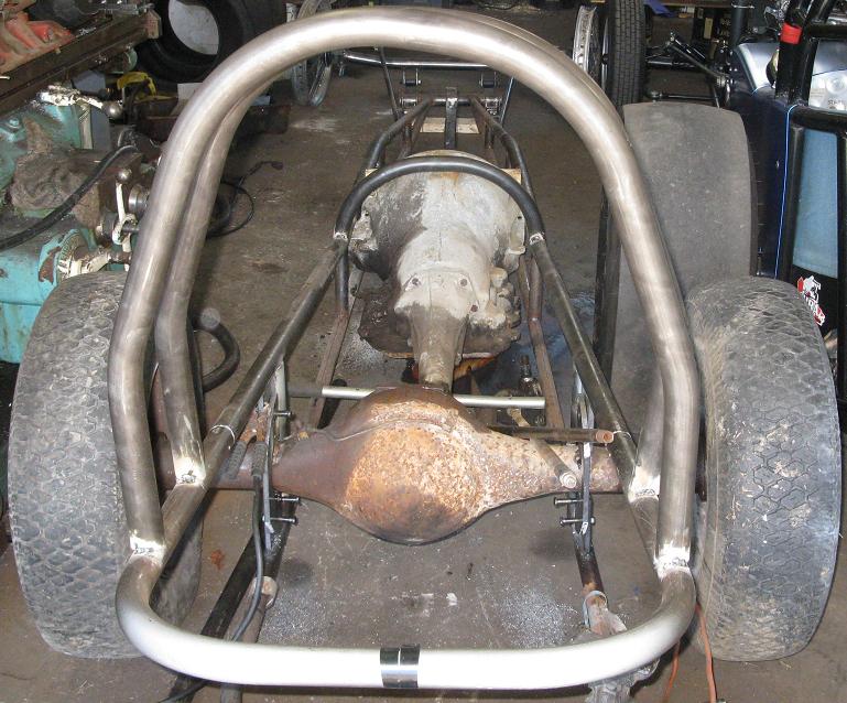

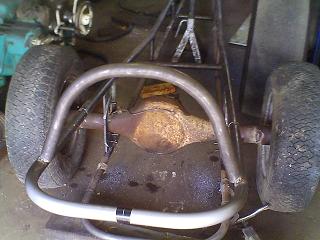

  25. With the big airfield race behind me I am back at the new FED. I spent this afternoon and part of yesterday working on the roll bar. First I made a cardboard me from an old box. I made sure he fit the Sr Dragster first then installed him in the new FED and began final fit and cut of the roll bar. I have the back bar and the rear hoop in. I should have the front hoop done by tomorrow. Since I lay down a bit in this car the wind profile will be lower. Pics tomorrow.
    Don

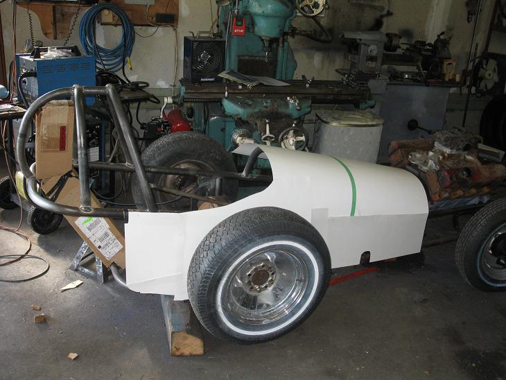

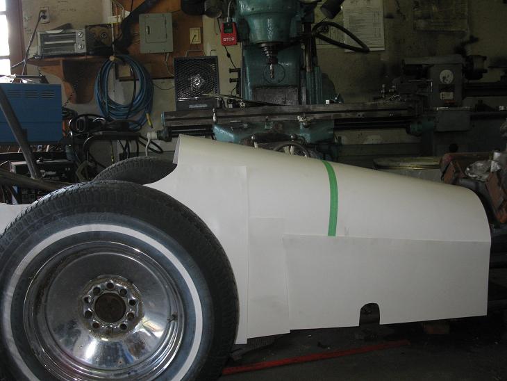

  27. So far.
    I ve been doing a bit of body mockup too, before I get anything fully welded. At this point I am liking it. Mrs D gave it the ok as well (said it was cute) but asked "Are you sure you can get in there?" Somehow I know she wasnt referring to my height. I think I can. I can get in the jeep and it is the same dimensions widthwise. Once I get the lower braces in I will scab up a seat and make sure before pushng on. The long cardboard box a.k.a. "Igor, The Magnificent" is exactly the same dimensions as my torso length. The bar conforms to the helmut rule for depth. (I checked it with my helmut.) I have to get some helmut bar steel next trip out.

    It's shaping up, "Viva Igor", LOL, are you going to use the chromies or are they just for mock-up? You know whitewall Bruce slicks and chromies would look good! How's the weather?
  29. The Chromies and whitewalls are on loan from Mike Sietsma so I can mock up and move it around. I did think the same though. Hard look to resist.
    The weather has been great till now. Going down to 34F tonite the TV says. This will be the first cold nite for where I am although a bit north of us they have had frost already overnite. This is our Thanksgiving , this weekend so not too unusual. I have one more thing to do on the Sr dragster before I put it to bed for winter. I will probably do it Monday (which is a holiday here )
