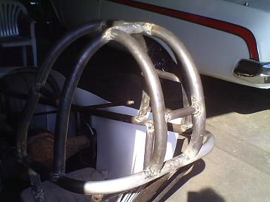

  4. Earlier it came up "would I fit in there?" Today after making and tacking the kidney bars in place I dropped a seat in the spot and climbed aboard. Actually ,not too bad
    Lots of head room and leg room. My legs are close to the top rail so I will put in some curved saftey rails to match the body curve back from the dash. Just so I dont have any "at track discussions" on saftey regarding my legs. Shoulder are a bit squeezed but not unduly. When grasping the steering wheel they are normal. Shifting might be a problem but it always is for me anyway. I made a govenor kit for my 63 max wedge that goes off at exactly 6500 RPM. I have an A&A gov kit in the senior dragster that is good for 6200 RPM. Probably I could make a kit for this trans (727) to get it above 6500. Or I could ask the lads at A&A for some special magic. Up to 6950 would be wonderful. Yeah I know I could get a CO2 bottle and a RPM switch all that stuff but it aint a gonna happen. It is after all an AUTOMATIC trans so I never understood why we make it manual and the install a 12 volt auto shifter. Maybe 6950 RPM isnt practical with hydraulic control? Anyway that is the current thought. For now I have had it with cutting fitting and tacking. I need a break! Engines are what I love. This is purely out of necessity. I was tacking with the mig and ran out of wire on the very last tack. Good time to quit for a month or so till I get my groove back.
    Don.
    PS I was also able to get up and out on my own.

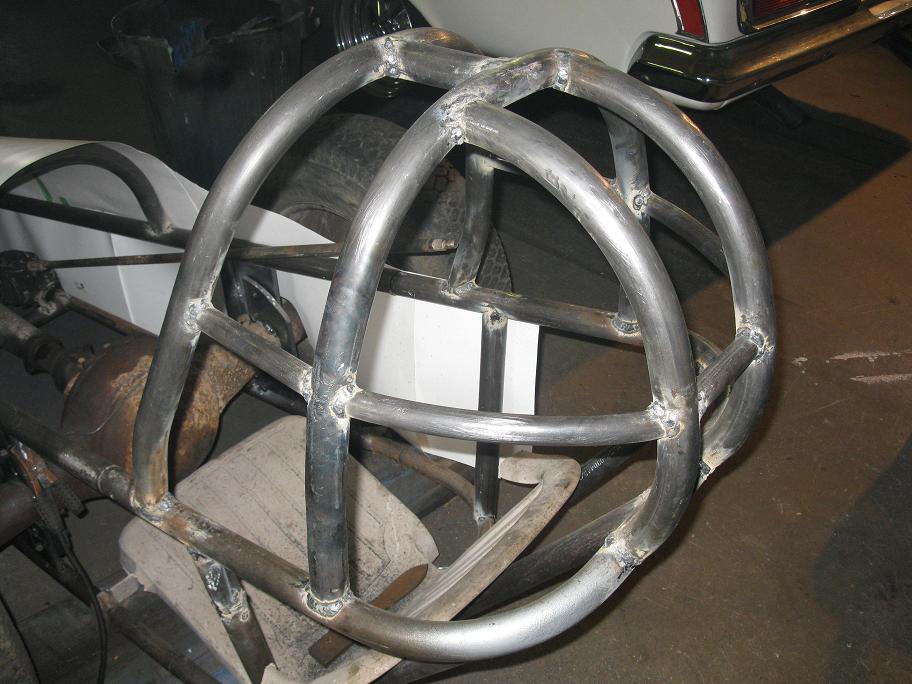

  11. I finished welding up the roll cage today. I dont have the helmut bars yet but the main cage is fit and welded 100%. Some sharpe eyed may notice I replaced the single rear upright with a double. It is because I had a brain fart and had forgotten that an 1 1/2 roll bar must have 2 uprights as opposed to an 1 5/8 which needs only one. I sat down to review the rules and discovered the error of my ways so I bent up another bar and moved the single over and "voila" we are legal again. I work till I get antsy and then invoke the cabbage rule. Had enuf for today.

  15. Helmut bars today. Just gotta make the corners and weld them in. This is a frustrating job because of the mutiple angles in your view. It never looks right so all one can do is measure level measure recheck and glue em in.
    Don
  16. I got the two curved helmut bars tacked in place but ran out of mig wire. Time for another break I guess. Mike was here and inspected it. He gave it a thumbs up.
    Don
  17. Welding done. Oh I still have to go over and check them all. Make sure the welds overlap without a space. Maybe redo a couple here or there but progress is being made. Next to perfectly position and weld in the trans support so the joint fits. A few more days and I will have a roller is some form. The motor mounts made and then remove the block and trans and finsh weld the whole main ch***is.
