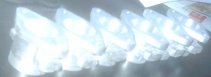

  2. Always keeping my options open I also designed a throttle body based on the old Snowmobile carbs i used on my Sr Dragster (Tillotson HD carbs)
    I cut the carb in half just below the venturi. I chucked it in my lathe and bored the hole clean all the way matching up with the largest section where the throttle plate sits. I spent about a week filling voids and holes, reworking it till i got a workable throttle body. I took my completed sample to a friend who got 6 more cast for me. When i came home tonight they were in my mailbox with the flag up like I had mail. The foundry did a very good job. Now i have to figure out a foolproof machining sequence so all will be exactly the same. I am an automotive machinst but not a general machinst so I am not used to sorting out these kind of set ups. I think honing the bore to size first will give me a reliable surface to work off and i a can make a jig from there for the rest. I am going to think about it for a few days to be sure. Any of you who know the answer I am asking for suggestions. I have two lathes and a big vertical mill. I would like t use these on the jag but also on the Slant six mopar rail as well with a Fi support system mech or electonic.
    The reworked sample from an old carb is at the left and the six new raw castings sit to the right.

    Personally, I would ream your mounting holes to the exact same size and distance apart on the mill, face off the mounting flanges with a flycutter, then make a fixture with a pair of dowel pins in the mounting holes and clamps to locate each one the same, then indicate the center of your fixture on the mill and bore out each of the TB's...or make a round fixture for the lathe to bore them on there after reaming the hole pattern and facing the flanges...whatever you do, don't use bolts to locate your TB's in the fixture, dowel pins are ALWAYS accurate, bolts are not...
  4. Thank you. I can do that. Then the dowel pins become my reference point and everything works from there. right.? Once i have faced off the ends then the throttle bore is at right angle exactly to the flange. I can centre my sample on the fixture first then all should be well and i will just mount each unit and bore it? If I make a fixture for the lathe using the dowel pins for location and Then all holes will be in exaclty the same spot from the reamed and doweled holes . So i should probably plan on spending more time making the fixture than I will probably spend doing the machining. Once i get it to the point where I have established the hole or throttle bore exactly and have smooth bored it in the exact location I am tempted to use the sunnen rod hone to finish it to size. Maybe this is not good but i am very familiar with it and work to .0001" easily on it aiming for zero error or as close as i can possibly come.
    I have no problem spending the time on the fixtures as I think I can use these on several projects and will have more cast if it appears so.
  5. OK, I made the fixture for the lathe. I faced the bottom of the flanges off first then mounted them on the fixture. I averaged the error on the throttle bore then machined the top of the stack. All six came out fine. Now I have a true surface to chuck them off of and can bore the throttle bores. I left the bolt holes very small so I can correct any errors there later with an end mill and a fixture in the vertical mill. I spent all day at this but it was worth it. Looks good. to me.

  6. ...or make a round fixture for the lathe to bore them on there after reaming the hole pattern and facing the flanges...
    Thanks. I did this and it worked . Just finished rough boring the Tbs . All were clean at 1.597" . Finish bore is 1.625". No voids. Tomorrow I will change on the chuck jaws and bore the last bit which I could not cut from this side. (last .150" right at the chuck jaw face. )
    Photo is too bright . If someone can fix it go ahead please. This is boring the first one.

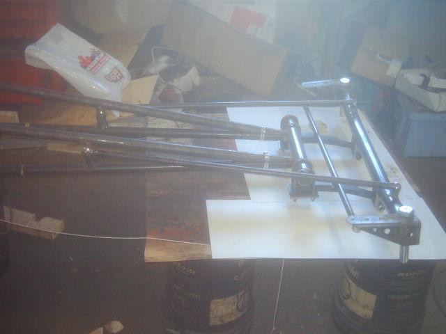

  7. The front suspension is coming together nicely. I made the clevises in the lathe since i could not buy them locally. I tig welded them in place. I am really getting into this scratch tig thing.
    1/4 eliphtic with long traditional style upper radius rods. They have heim joints at the rear. All tubing is DOM .120" wall steel. All sizing complys with NHRA IHRA rules.
    Still have not found some matching motorcycle wheels so the axle stubs have not been made. I am contemplating a Buttera style bellcrank steering set up at the front all mounted just under the front round tube.
    Don

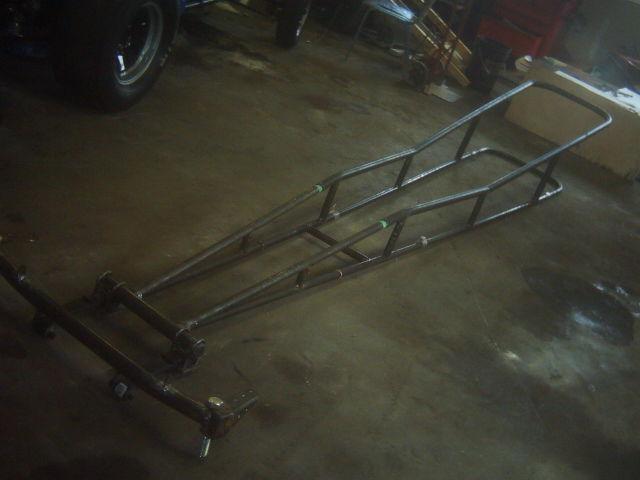

  18. Worked all day but seemed to get nothing done. Actually I did. I got the rear bottom hoop spliced, pluged welded and installed in the lower frame rails. The hoop is one piece just in case someone misunderstood but i splice them in at the first decent section of straight run tubing. 1 1/4 dom with a 6 inch section of 1 inch dom inside and four plug welds per section. I like this method since i know when it is final welded it will be the strongest section of the whole chassis. I have one upper rail with a slightly stressed bend. A minor bend error on a 12 foot section can be a much bigger error at the other end. It is slightly over bent even though it looked good but I have a device known as "the unbender" that will make it perfect and remove the stress from the chassis. It works very well for this as well as straightening bent frame rails in friends CM cars. I will post a picture of it in action tomorrow.

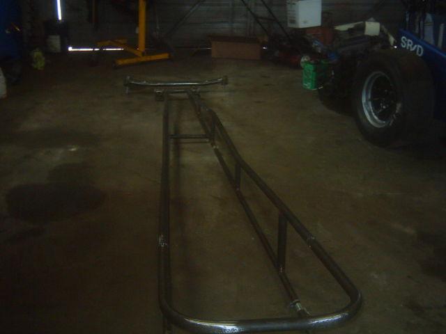

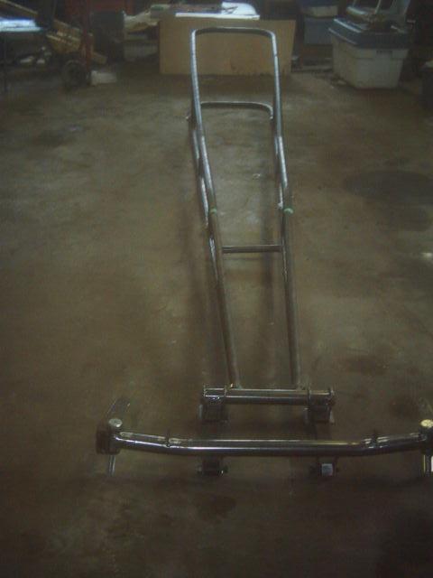

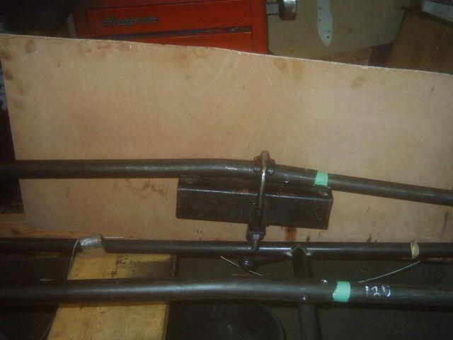

  19. Got some uprights in and tack welded. Everything so far is square but will double check before final welding. That one bigger cross brace is just sitting there as i needed to gaurantee no movment on side rails as i worked on the rear section.
    Don
  20. Upper rear hoop installed today. Layback is 20 inches (top verses bottom.) That should help keep the roll bar hoops shorter and the car shorter(not as tall as would otherwise be). Hope i dont go to sleep sitting in it.
    Don

    I was thinking about layback the other day. The best looking cars have the hoop bars parallel with the rear of the chassis. Seems to me like the higher the upper framerail the safer it'd be in a sliding down the guardrail situation.
    The bends in your upper framerails are to accomodate the Jag?

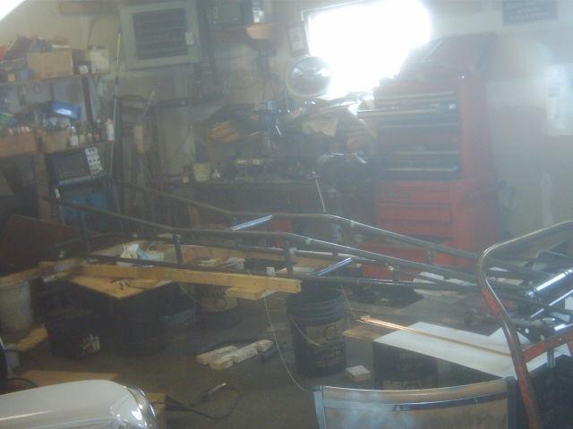

  22. Yes and perhaps another slant six too someday. I also built it so i can run an early or later hemi as well. I felt I built my last rail too tall. I measured a few i liked the look of and came up with this dimension. If I decide later i dont like it I can easly change it . I used the seat i will be using (at least the seat brand and style) to set the layback and left an inch for belts up holstery etc. I want to get down out of the wind a bit on this one.
    Today i took it off the jig and will put the jig away again. Meanwhile the Sr dragster looks on over the development of his baby brother. A few minutes ago i weighed it with the front end installed. The front end is not done but a large percentage of it is. Weight was according to my scales only 130 LBS. I am not sure that is right. When i get enough nerve i will weigh myself to see if they are working right but i didnt need that reminder in my life today.

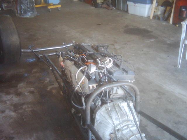

  24. Because of the large boss at the oil filter which extends all the way to the head deck a 5.7 will not fit.The bellhousing end would but i forgot about that big oil filter casting on the pass side front. We will try the Jag six this afternoon i think if all goes well. I have everything just tacked so I can widen it up to 4 inches if necessary at the front without making any new parts save a crossbrace. As long as the Jag fits i am going to leave it as is. (cause that is what i built it for. )
    Don

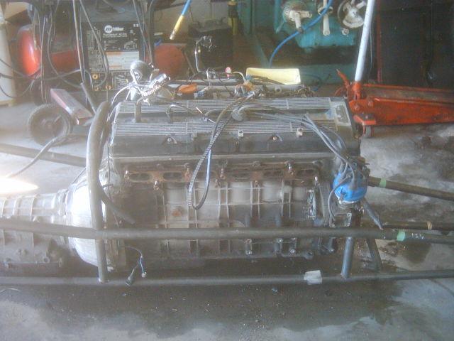

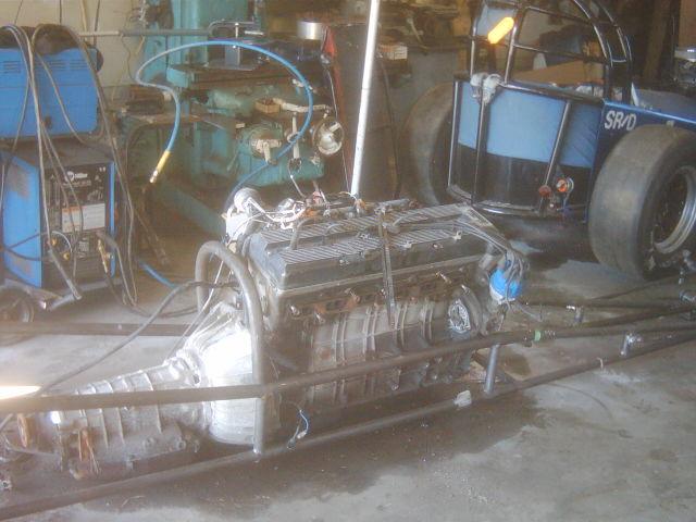

  26. Thanks for the encouragement. It is a very interesting deal to me. I spent yesterday removing accesories from my motor for trial fitting. I still have to remove the oil cooler lines and rework them

  28. It Fits!
    Minor interference with oil filler pipe but it bolts on and is easily modified. Oil filter clears (just). Trans dipstick pipe will need a minor bend but that should take about a minute. Supercharger set up fits as is. In case you didnt rrealize it, the 3.6 Jag is also a "Slant six" with 22 degrees lean. I will have a pair of slant six dragsters when it is done. Life is good!
    Don
