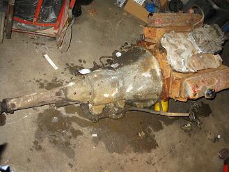

  2. The Parrot (poly) has landed. Today we got it finally off the truck and into the shop. One thing is for sure. The 727 trans tailstock is too long! May have to switch to a 904 or find a motorhome hanging trans (fat chance!) or use a 4wd output and make a new tailstock.

  3. Bought an old B&M clutch-flite several years ago for the internals. The unit had a sweet 1 pc. tailhousing and output, probably about 6-7" in length.
    No park though....

  6. Believe me I have thought of it! I measured it today against a 904 from my Sr Dragster. It is in realtiy only just under 5 inches longer. (4 and a bit) I sat there looking at it for awhile thinking a 63-63 has a bolt on flange that is very short. More than likely the same spline being mopar they dont reivent the wheel each time but use what works good. Since it is a rail I do not need any travel in the slip yoke. The splines are long in these trans too. Probaly 6 or 7 inches. I could easily recover the entire extra length by using a short flange from a 63-64 chopping the tail stock 4 1/2 inches and the output shaft a like amount. That would probably leave me enough spline left to slide on the early flange or something similar . I could then chop the seal boss off the cut off section of the tail stock Slide it over the outsde of the flange seal surface then slide it into the back of the trans on the chopped output shaft and tack it with my Dc welder using lincoln 43 Aluinum rod. After that just take it apart weld and make pretty , install a new seal and voila, a stubby 727. No $$ and the right length. The 904 length is about perfect for a rail or an altered with a full size person. (Which i am) Anyway I got the trans off of it today. Hopefuly i will get is all apart before next year! (aka saturday) I also had a brainwave for a piston to use in this engine off the shelf. i found a shop who will sell me one so will try that too. Engine will come out at 333 cubes. 11.3 approx compression. Gotta turn 7000 to make it work. Because of the small cubes anything around 220 CFm intake flow will be fine. Should be doable.

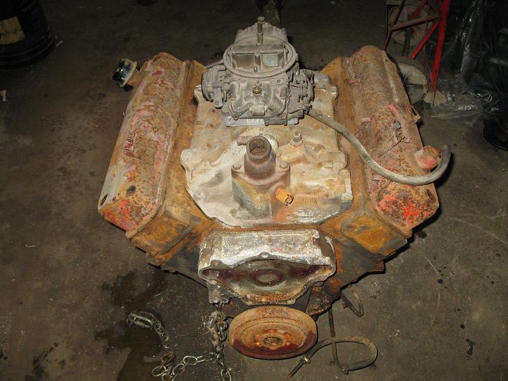

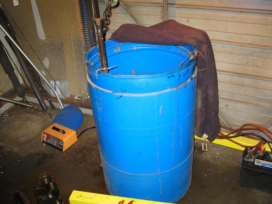

  11. My pal Bob stopped by and we spent the afternoon dis***embling the short block. Pistons were seized. I did give it a brake fluid spash but it still was pretty bad. I got four pistons to move. Took two out and then put it in the reverse electrolating tank. I ran it on the truck for awhile but now haveit on my battery charger with a battery also hooked up. I will hook it up for the weekend, Even a 1/2 hour on the trucks battery (truck running)already produced a good thick coating of rust and crude on the iron bar. I filmed it and as soon as it is ready I will post the electric cleaning tank in action.

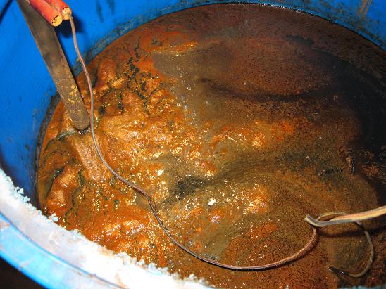

    if you have ever wondered how this works or even if you never heard of it. Here is my 318 Poly short block in my reverse electrolysis tank bubbling away. My mike I used for the voice over isnt the best but it is all that is here right now. I apologise for that. This engine had sat for years with the hood off and no distributor or carb. The guy tried to keep it covered but wasnt always successfull. I soaked it with brake fluid and was able to get two pistons out relatively easy. Fighting the rust is the big problem as getting them to move after the soaking wasnt too bad. I had removed the crank right away. I decided to see how much this would improve things. I will leave it on the battery and charger all weekend and we shall see. If you havent tried this it does work well , costs little and smells good. (Like fresh washed clothes at first. )

  15. This process is begging to be run with a solar panel. I am drawing about 30 watts , just under ,as the charger reads 1.8 amps and is at about 15 volts output. A 30 watt panel would run it well i think. That and a wind powered air compressor and i would be enjoying the good life. (Again!)

    Arm and Hammer WASHING SODA which my wife says is an old fashioned washing mix. She knew exactly where to find it in the Grocery store so she got me a box ($6.95). I used the instructions to mix it with water. You put the neg lead on the part and the positive lead on the iron or steel bar. It will work at 12 volts off a battery alone but its pretty slow. If you add a charger to the deal it perks right up. I have used it on cly heads with remarkable success. This is the first block I have had in the tank though . I will know in the morning but from the ac***ulated residue it looks promising. The heads I have done worked real well just a quick rinse and wipe and they were just like hot tanked without the caustic ****. One can also do aluminum, Even pistons with it. I learned this from the Nova Scotia antique tractor club websitie. I found it by accident.

  22. I have it out of the tank. I have no water in the garage in winter so all I could do was dump a couple of buckets of hot water on it and wipe it off. Hardly a fair test as a pressure washer and a couple of minutes would have cleaned it to the bone. Never the less I was able to within an hour remove all eight pistons. The rust had vanished and anything left on the block can be wiped off with a rag without hard rubbing. Is it as perfect as a hot tank? No but it is darn good for a rusty block . After a hot tank I doubt I would have got it apart. Pics in a few minutes. Just got inside. Hard working in the doorway below freezing.
    Here.
    Where did the rust in the cylinders go? Well here. I had wire brushed this bar before using it this time. This all came on this soak.
