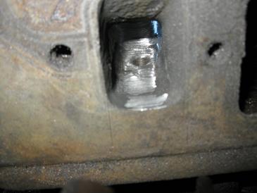

  11. Thanks. I took the head out and finished dis***embly. I really enjoy head work and porting other then the dusty smell. I took my roto-zip come diegrinder and with two toolbits started at the one intake port as I planned. I have done these heads before and in fact my first porting was done on a set of these 318 Poly heads. I have however learned a bit in the last 45 years and so I went to work.
    I will show a couple of deals here in two seperate post so I can comment appropriately. Here is my porting die grinder. If you want to listen to your compressor all day with your air grinder, fine. I dont. This is a very very practical solution.

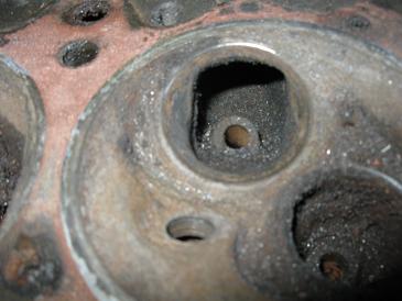

  12. One needs to remeber when porting the intake that the air comes in from the port not from the valve . I say this because the human tends to think of the port from the valve out instead of from the port in. In these heads an over generous valve giude boss blocks the way to the valve. I removed it completey and will install a new valve guide (Cast iron!) of reduced stem diameter (.312" instead of the current .375") Since replacement guides are .500 inch in diameter I will machine the end of the guide where it protrudes through into the port so that it will still have a good wall thickness. (Same as a .375 stem guide would have on the same core) . That will give me a reduced diameter. I will also limit how much comes through since I will be driving about a hundred miles in the next five years instead of 100,000 miles. I also raised the top of the port by just over .125". All the activity takes place in the top of the port so that is where to work. Very little happens down below. I will complete this intake port completely to establish it then copy to all the rest. Water is close on these heads so I have to be careful. I cant go as big as I would like so i have to optimize what I have.

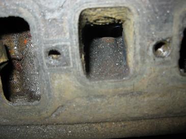

  13. This is the valve side view.
    The ruf work done I will change to a finer longer tool bit and blend. Valve size will be 1.94 with a .312" (5/16 stem)
    Don
  14. a bit more

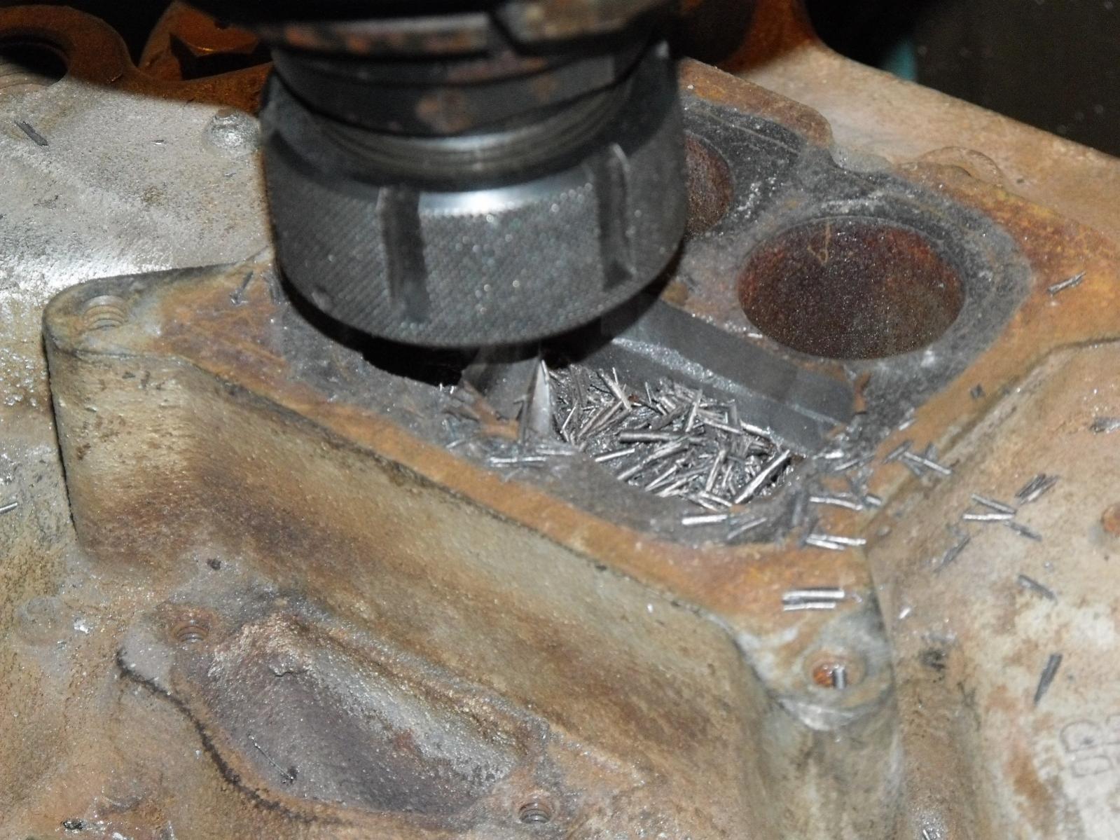

  27. [​IMG]
    Here is what we started with. The holes are very small as it is a manifold for a WCFB Carter. After about 5 1/2 hours on the big mill with a 3/4 inch end mill I have it rough machined to here. Still have a lot to do but the manifold itself is quite good. The runners are full size for the ports and even have some taper. If they had been built like this instead of like above ? MMM. THe deep side is almost 4 inches of solid cast. It doesn't come out in five minutes. The easier you go the better the job too. Back at it this morning.
    Don
