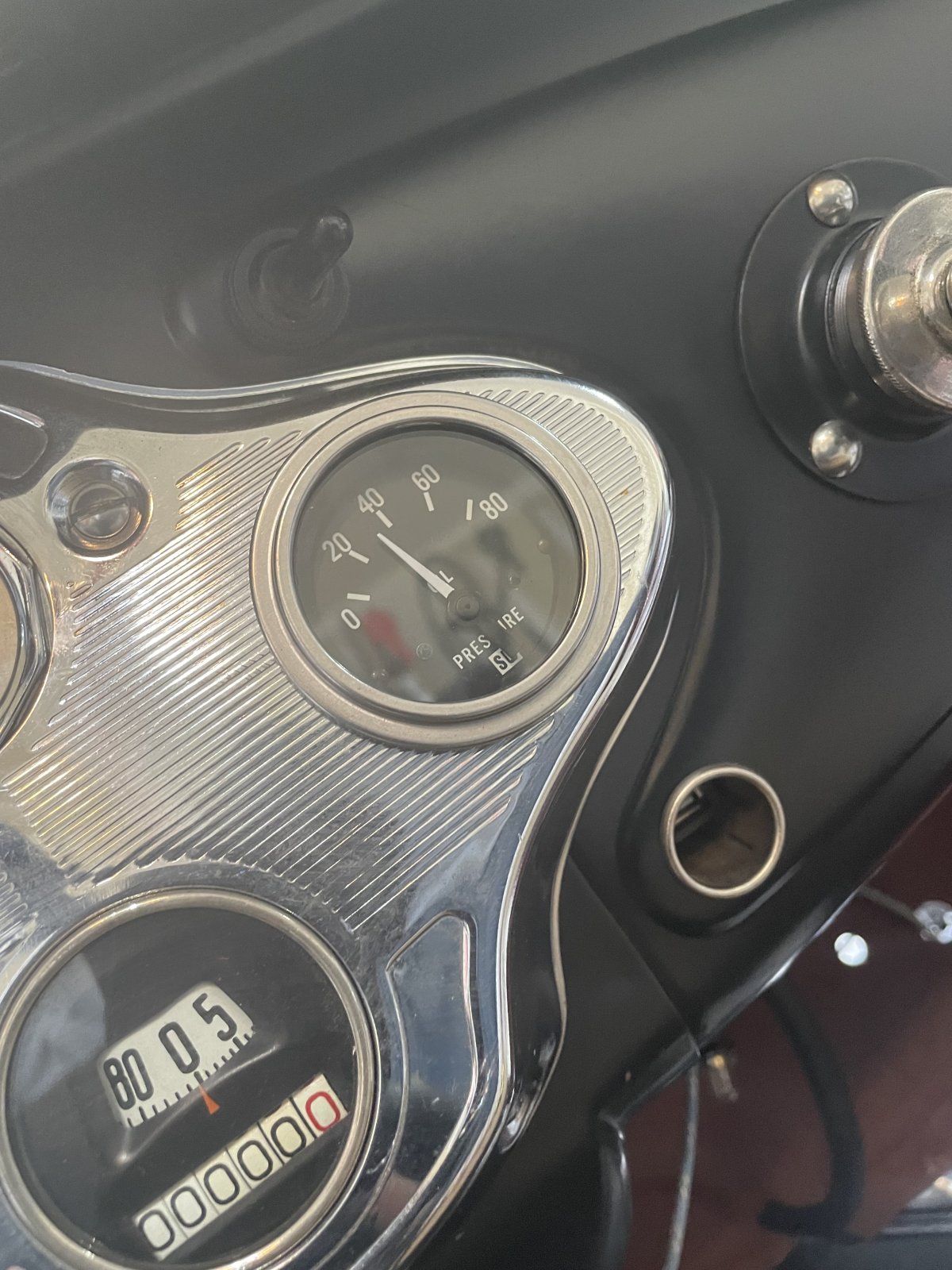

    Yes this was a nail biter. I phoned two friends and they both said START IT.
    I ended up with 10psi priming the engine with the dist disconnected.
    with great fear of Nuclear mushroom clouds, I turned the key and it started on the first try and went to 45psi. And the gauge works now too.
    I don't know why it took so long to prime the engine and get pressure but it's all good now.
    I was sweating bullets and with all your help, I got through it without incurring 5 digit expenses.... this time! thank you all!!

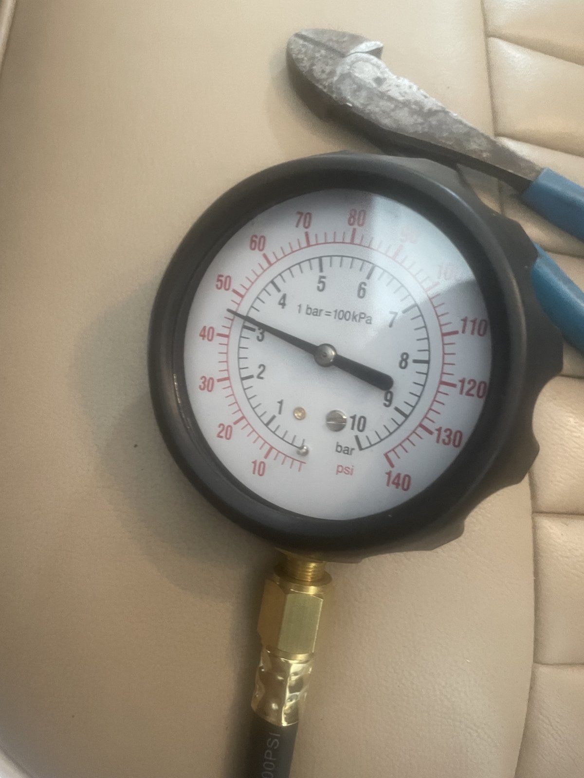

    It would be interesting to know what variety of oil pump has been installed in the engine. That oil pressure is fine with an old style pump with straight cut gears (and a "stretched" relief spring), but low for a later spur gear pump.

    Secondly, electric gauges are finicky about voltage drop when cranking, so the gauge probably didn't want to read at the10 volts it was seeing when cranking.
    Glad you fired it up and got that hurdle out of the way.

    That's the same one I referenced in post #22. It was new, I didn't know any better and installed it and also go only 45 psi. I was concerned and replaced it with a known good used Ford pump which brought the pressure back to 57 psi. You can live with 45 psi and it probably won't get worse. Replacing mine caused the new rear main seal to develop a slight leak which I haven't gotten back to yet (but I will).
    I would avoid Speedway oil pumps after our shared experience.

  16. On a new engine, with a new (later 49-53 pump - which is what you have) and cold oil, it should easily pump over 60 PSI upon start-up at 2000 rpm. I stretch the front spring on my 39-48 engines (with this pump) and they will be pushing 80 lbs on start-up. Even when the oil is hot, I will have 60 lbs at higher RPMs. Also, I have increased bearing clearances and still see that type of pressure. The same is true on every flathead I've built with the 49-53 pumps.
    If it was my engine, I'd put a mechanical gauge on it and validate the initial cold-start pressure at higher RPMs. If it is NOT about 60 lbs or more, than I would suspect something is wrong. If you find that the pressure drops off once the engine/oil is hot/warm and the pressure at 1200 RPMs is now below 10 - 15 PSI, then the motor needs to come apart and be inspected.
