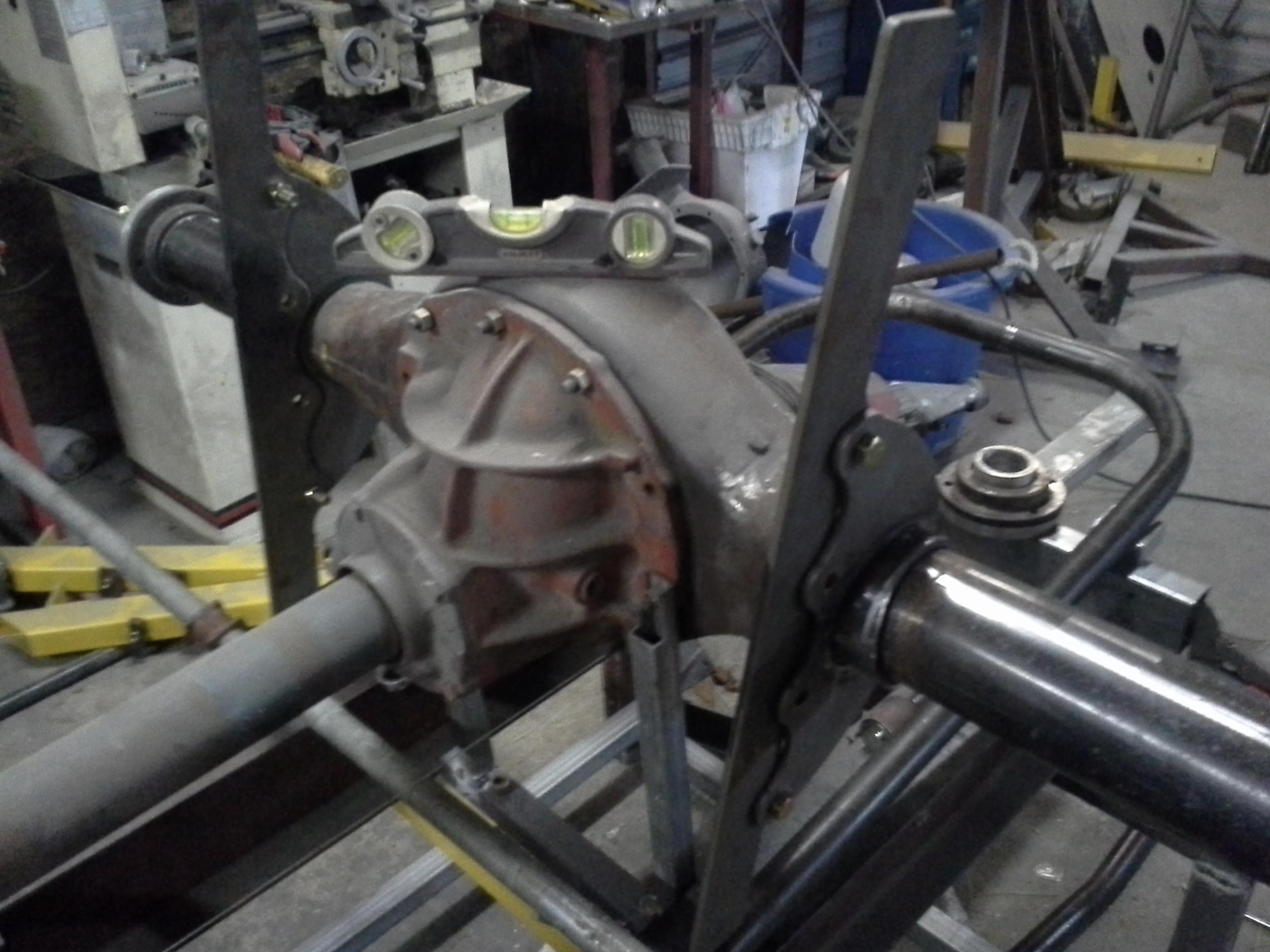

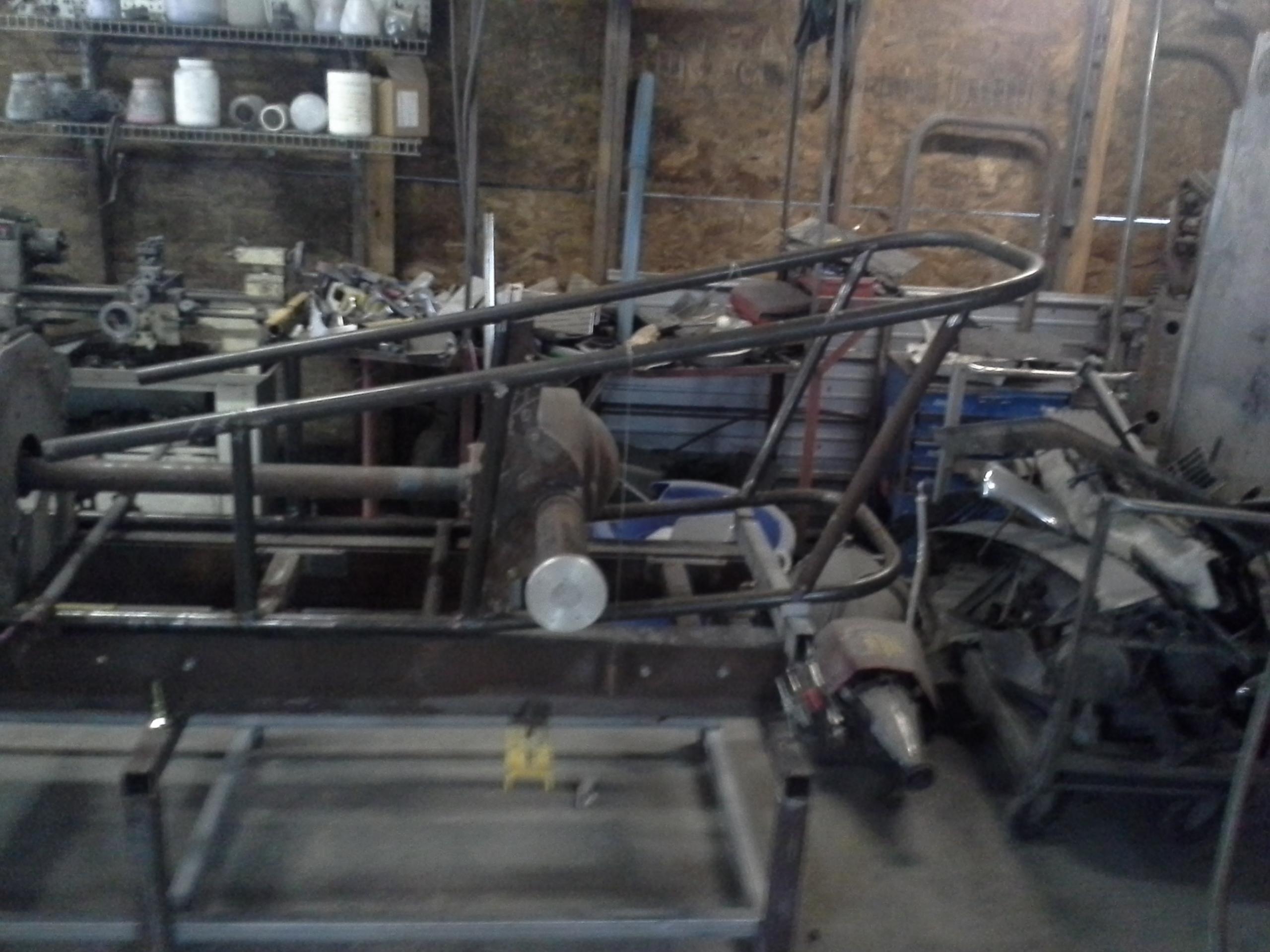

    Today was a long day, after messing with the line up for a few hours I decided to make a rear end jig that I could bolt to the housing bolts. I used a set of equipment levelers on the bottom and got my rear end height pretty close to were I needed it and used the levelers to finish it. I is level every direction you can think of. I got the motor plate bolted to the block and the line up bar through 4 of the 5 journals. To test how steady it is I went ahead and bolted up the rear end housing and nothing changed.Took about a hour to grind and weld it together and do all the fitting so everything was fitted tight. On the p***enger side of the center section I had to grind a little smile in the metal so it would mount flush. Keep checking in on the progress.

    Looks good , glad to see you used an alinement bar, alot more accurate fit,,, Tim Jones

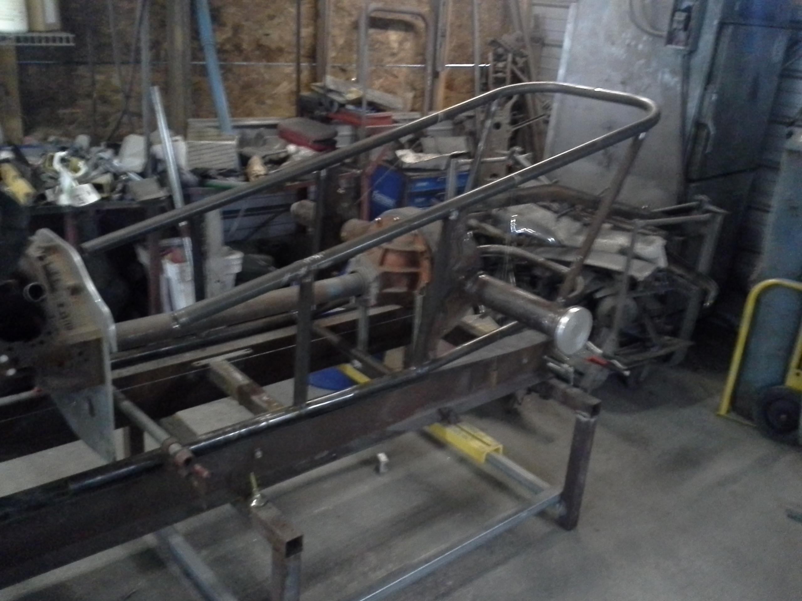

    Today started off pretty easy I was looking at my lower frame rails and decided to get bold and re-bent my lower hoop and after I got my 90's bent on each side I was still feeling lick so I went ahead and bent the up angles at in the lower hoop at the rear end mount. Once all the bending and sweating was over it was all perfect, I was going to miter cut the angles but the way the tubing bender was working this morning I said what the hell! I now have the 1 3/8 lower hoop 4 " in front of the rear motor plate. I have 1 of the rear end uprights fitted and working on the other side that is going to take a little longer because it looks like it is going to mount on the axle tube and rear end housing due the angles I am using. Bottom rail measured 20" OD. So far its been a pretty good day. I think the biggest thing I have overcome was second guessing myself. I am fixing to make a fixture to hold the shoulder hoop in place so I can adjust it and see how I can cut down on the wide shoulder hoop and streamline the upper and lower frame rails. Also if you see the short rail in rear 2 and then the longer rail in rear 3 I have a 6" sleeve inside that rail and a upright also goes there.

    I uploaded the wrong pic this is a better pic of the lower rail with the double bend.
