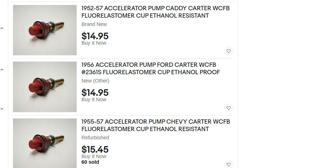

    I'm about to order pumps for my WCFBs. They advertise 'fluorelastometer ethanol resistant' pumps. That's not leather is it?

  30. gimpyshotrods
    Joined: May 20, 2009
    Posts: 24,399
    gimpyshotrods
    Fluoroelastomer is synthetic rubber.
