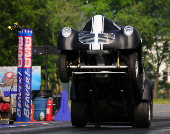

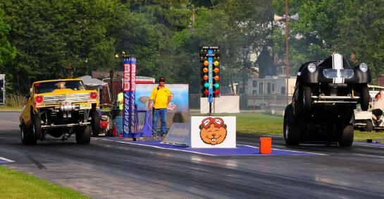

    One of my latest axles went to stumpy142 here on the HAMB
    I call it the dump truck axle its made with a 2.5 X .312 wall 4130 tube
    volvobrynk likes this.

    Great photo to advertize your axle! I've seen the flaged axle ends Bill makes, great looking welds, he is a nice guy doing great work. Bob [​IMG]

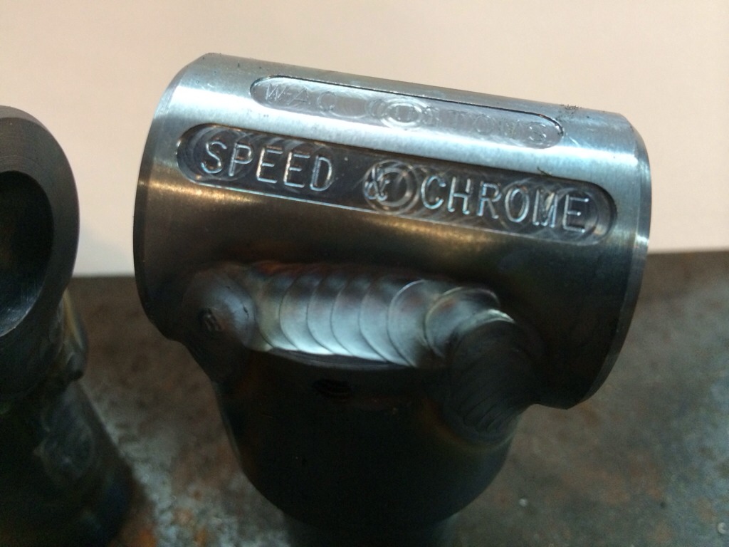

    Thanks Bob...
    Here is a pic of the flag to help hold the king pin boss in.

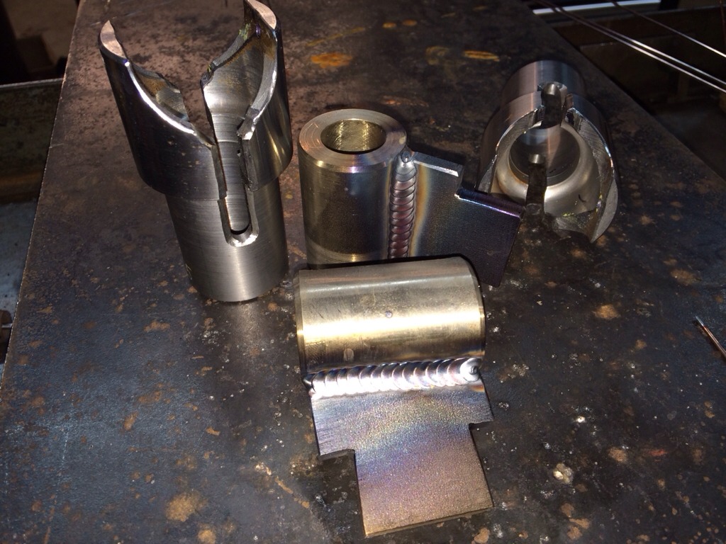

    Yes... Made in the USA
    King pin bosses
    WACCUSTOMS.COM

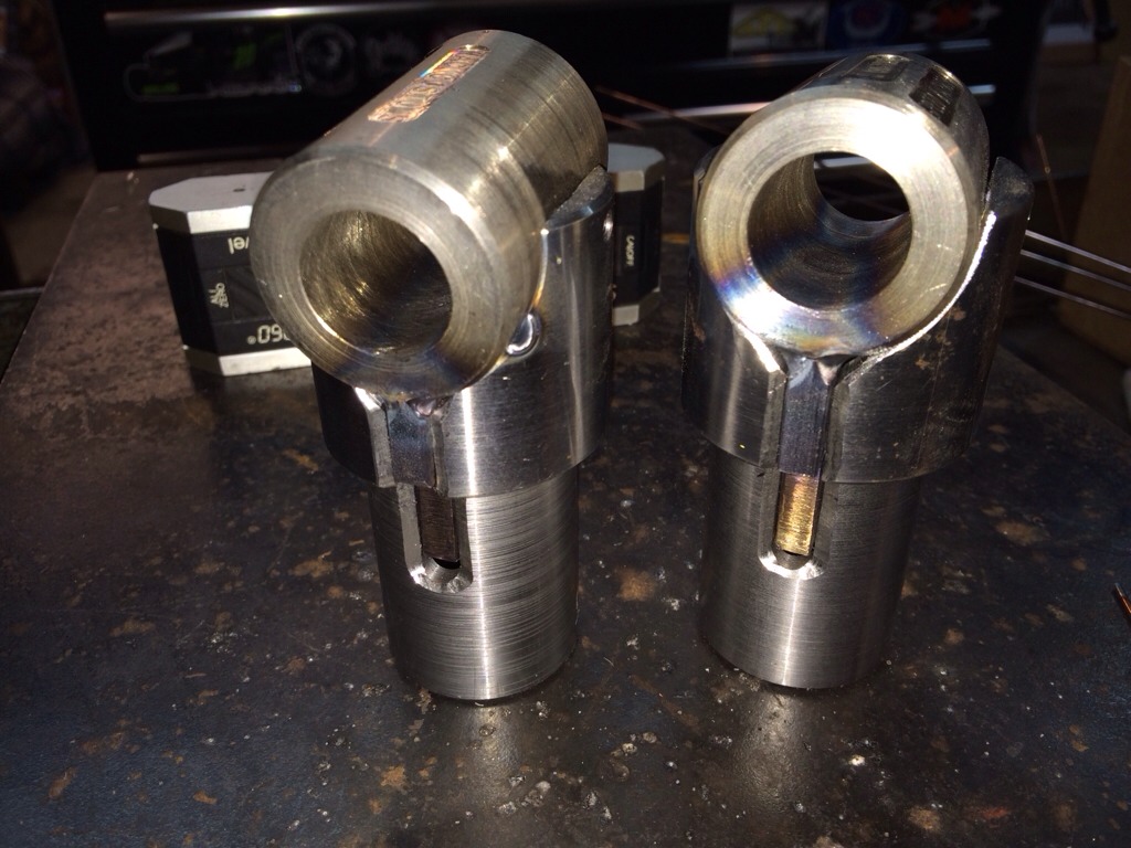

    King pin bosses all flagged and welded into the ends. Next step hone and turn to fit the tube. ImageUploadedByH.A.M.B.1396492337.369628.jpg ImageUploadedByH.A.M.B.1396492357.895944.jpg ImageUploadedByH.A.M.B.1396492373.308936.jpg ImageUploadedByH.A.M.B.1396492390.919264.jpg ImageUploadedByH.A.M.B.1396492402.557873.jpg
