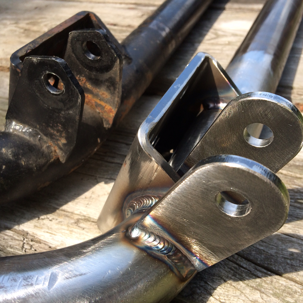

    Swapped out a way too small for a 55 chevy 13/4" tube thin wall axle. With a 2"1/4 wall tube axle with my flagged king pin bosses
    ImageUploadedByH.A.M.B.1439262599.560865.jpg ImageUploadedByH.A.M.B.1439262615.643924.jpg ImageUploadedByH.A.M.B.1439262629.294871.jpg
    Made up some new top shock mounts
    ImageUploadedByH.A.M.B.1439262726.386539.jpg ImageUploadedByH.A.M.B.1439262740.137660.jpg ImageUploadedByH.A.M.B.1439262755.490586.jpg

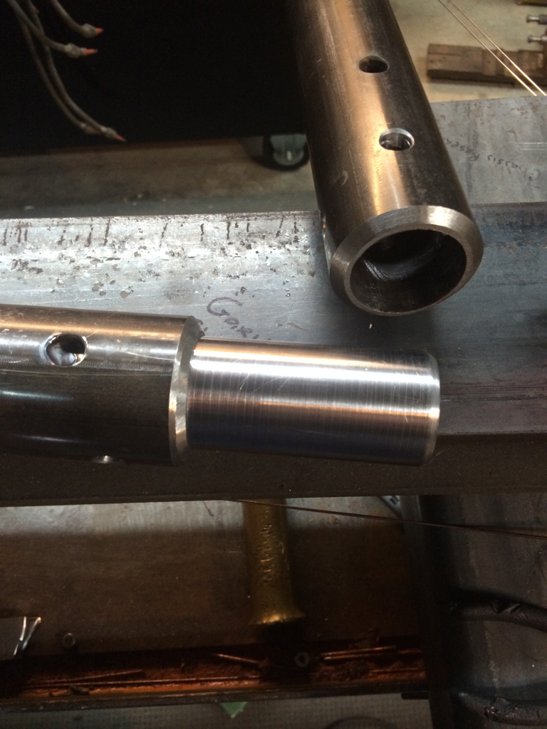

    Working on a new axle we are calling
    21/2" .375 wall moly tube
    ImageUploadedByH.A.M.B.1446955869.281013.jpg ImageUploadedByH.A.M.B.1446955883.333790.jpg
    Custom ends to go from 2.5 to 2"
    So I can use the std. King pin kit with bearing for the chevy spindle.
    AHotRod and Lone Star Mopar like this.

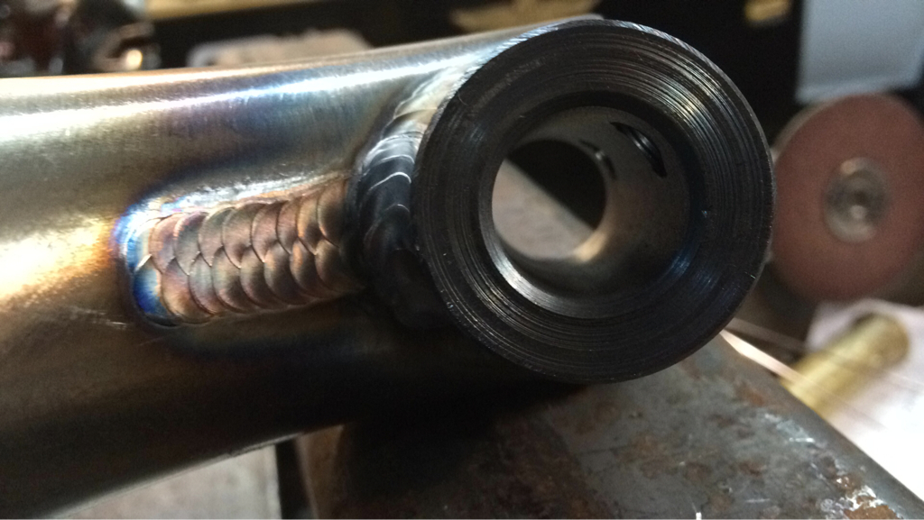

    What a great looking axle you made for the black 55, I had a dropped tube axle made for my 37 in 62' by local sprint car builder & racer Rip Erickson
    Always like the look with some drop to it, you must have one hell of a bender as it would take a little grunt to bend that thick wall stuff ?
    Plus your TIG welds are perfection !!!!
    Oh BTW what type of camera are you using for your close up stuff, as I need some close up stuff too they are so clear
    Thanks, Don

    Thanks Don.... I just us my I phone-5

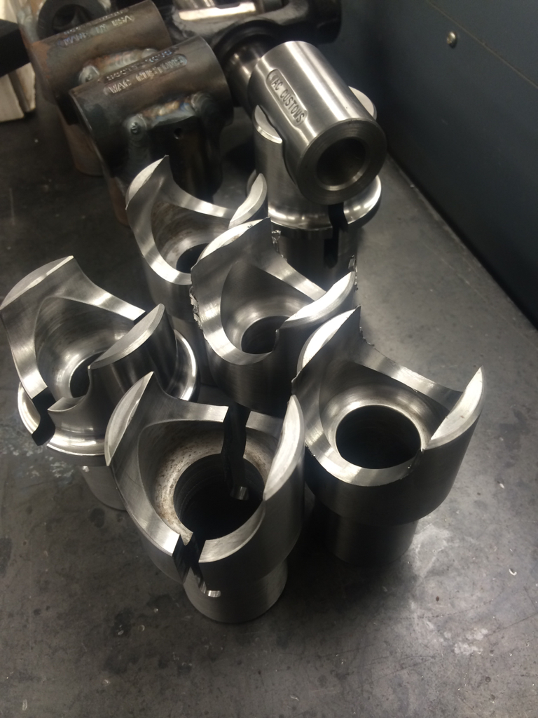

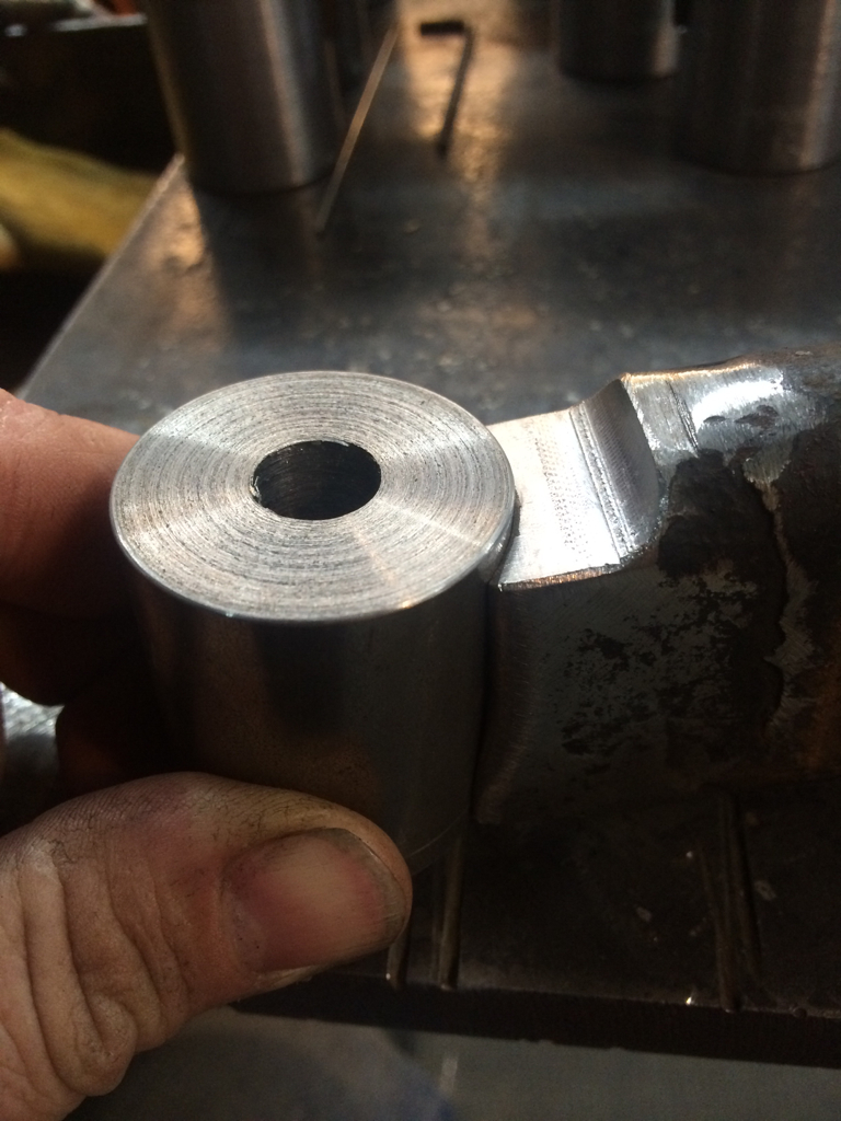

    Making some custom ends for a 21/2" .375 wall moly axle
    ImageUploadedByH.A.M.B.1452141208.903586.jpg ImageUploadedByH.A.M.B.1452141220.354260.jpg ImageUploadedByH.A.M.B.1452141238.171460.jpg
    Std. 2" end and the big 2.5"
    Added the slots for the flagged king pin bosses

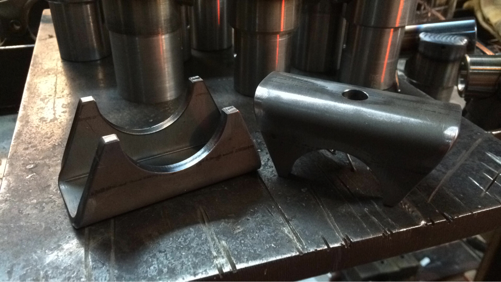

    ImageUploadedByH.A.M.B.1455773332.860236.jpg ImageUploadedByH.A.M.B.1455773349.242616.jpg
    Under Spring pads are back in stock.
    I always have the other style that the spring bolts to in stock.
    Both made of 1/4" USA made steel.
    Laser cut and bent here in the USA
