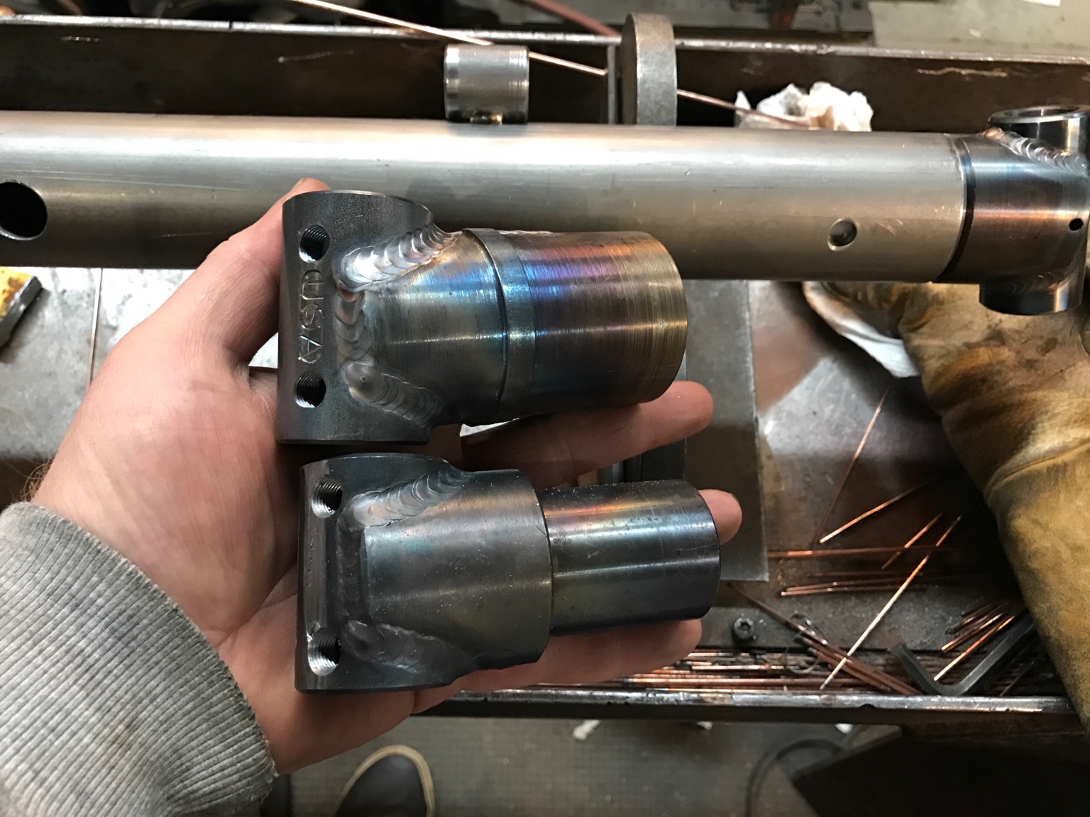

    21/2" .250 wall moly tube anyone?
    Little side by side of the 2.5 and my std. 2" tube end [​IMG][​IMG]

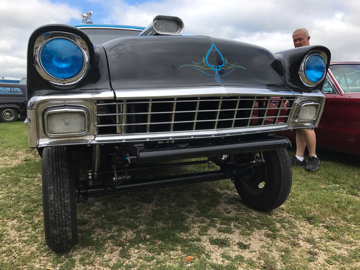

    [​IMG][​IMG][​IMG][​IMG][​IMG][​IMG][​IMG][​IMG]
    Some of the WAC Custom axles found at the melt down Drags 2017

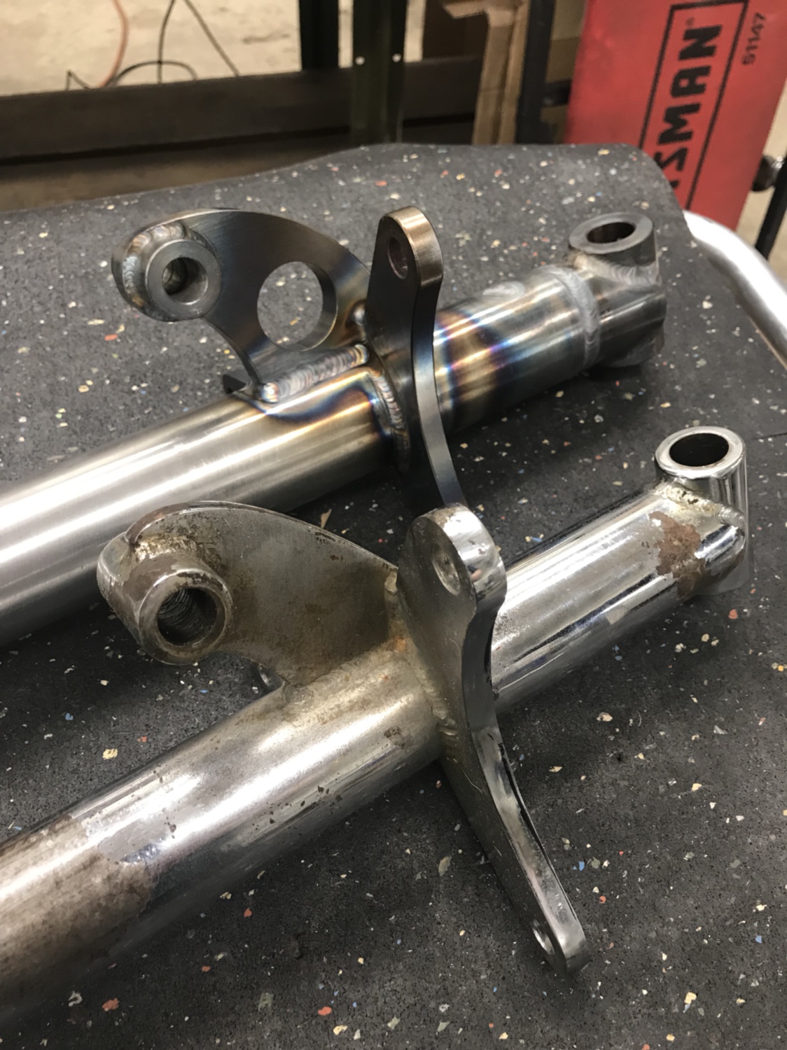

    New spring mounts for a buggy spring.
    It’s always fun to reproduce a new HD version on a cool old axle
    It’s going to be chromed like the old one so I cut all the brackets on the CNC to make it easy to prep for chrome
    Old axle 13/4 thin wall tube
    New axle 2” .312 wall moly tube [​IMG][​IMG][​IMG]
