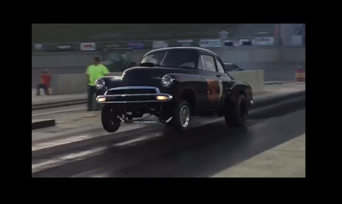

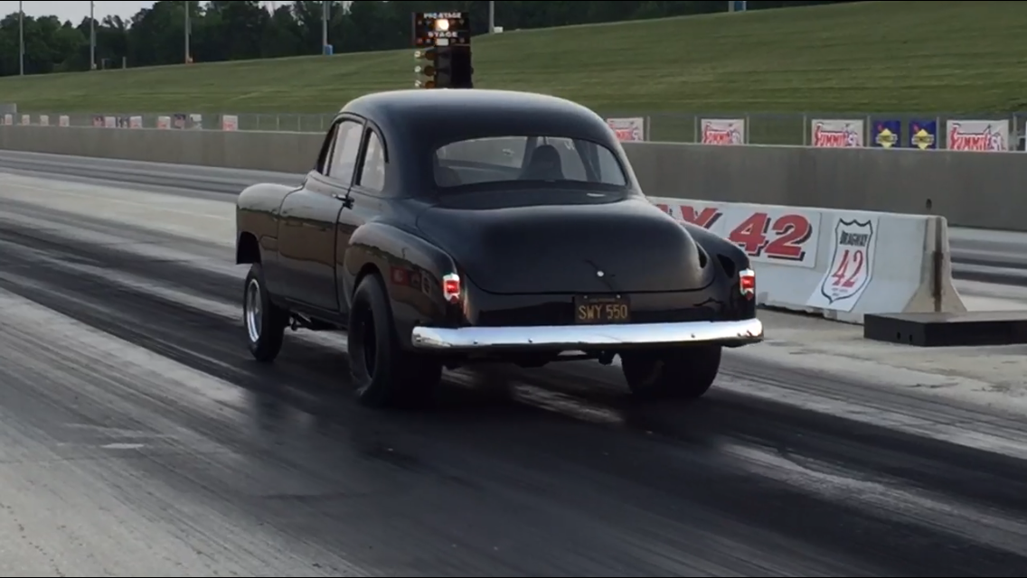

    Well haven’t had chance to post in a while so I thought i'd post a few updates...
    Anywho, we took the car to Dragway 42 for it’s maiden voyage down the strip a couple weeks ago. I didn’t expect to make a balls out p*** or anything I just wanted to take the car down the track to feel it out . I made 2 easy shakedown p***es and the car seemed to go straight, was smooth and stopped good. that was enough to make me comfortable enough to make a 3rd full p*** under power. Leaving off idle, the car run a 10.46 @ 127. I really didn't know what the car was gunna run but i can say i was pretty happy with what it ran especially being the first time out. After those 3 p***es i could've made a 4th p*** but decided I didn’t want to push my luck and there'd be another day. We loaded the car up and come home with a smile!
    Over the next couple days, I went over the car and found a few things that happened during the first time out. One thing was that the throttle pedal was actually bending not allowing full throttle so I ended up making a new peddle from some 7/16” round stock. The other thing I noticed was the cheapo chrome distributor clamp decided to loosen its grip and allowed the timing to jump up to 56 degrees! I fixed this with a better clamp and tossed that $3 chromed POS!

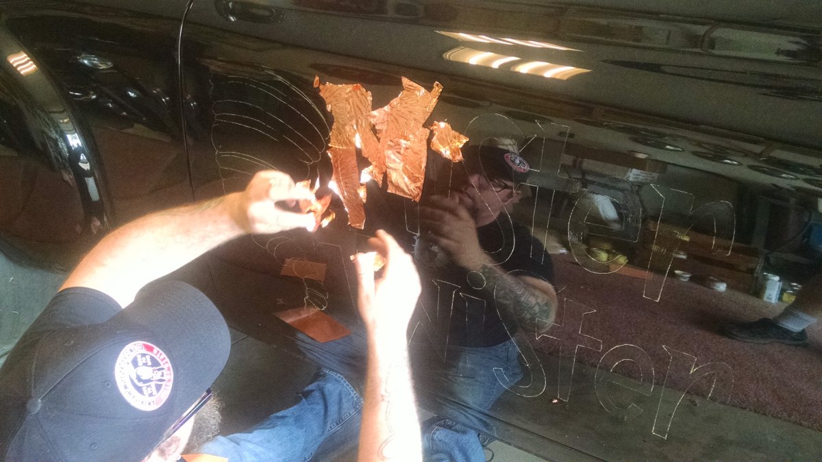

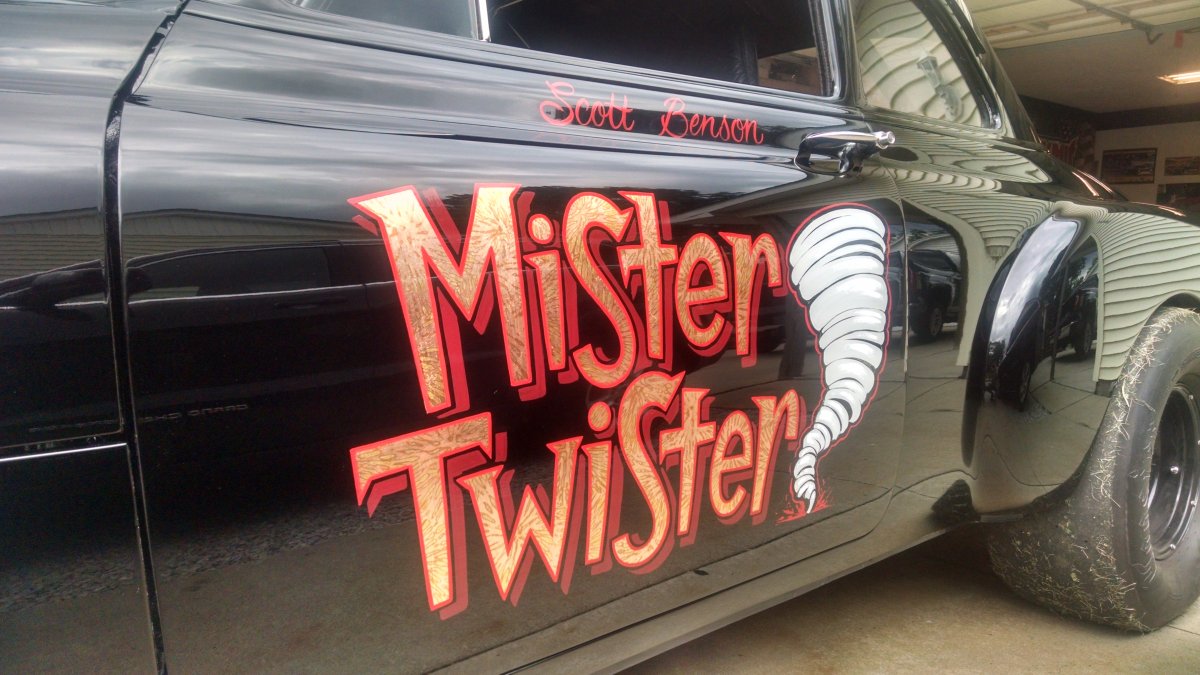

    Last week my buddy J Bird who is an exceptionally talented artist came out to letter up the car. He looked the car all over, made sketches and then he said he was only doing the car one way and that is in leaf! I wasn’t really sure that I wanted leaf since I was thinking of just having him paint the lettering on. So i ended up just telling him to do whatever he thinks will look cool.. He did the lettering in red variegated leaf and painted the rest. After I saw the finished product, i thought man I’m glad I took his advice! The work he did was spot on and I couldn’t be any happier! He just made it look so dam easy!

    So this past weekend we went back to 42 after fixing the gas pedal and distributor hold down. Off the trailer the car went 10.33 @ 128. It backed it up with 2 more p***es @ 10.32 and 10.31. I progressively launched it a little harder each time..
    The next night we took it to Quaker for some more TnT. Before we went I took a few degrees of timing out since I had an idea the engine was happier with less timing advance. My 53 usually ran a tad slower at Quaker than other tracks i figure since the top end is slightly uphill, so I was expecting my ET to reflect that. To my surprise, the first two p***es at quaker were 10.33 and 34. I think my last two p***es would’ve been fastest yet due to the 60' time but unfortunately I run off due to a wheelstand + missed shift combo! I’ll know if the timing change really made difference once I get back to 42.
    Either way I’m totally stoked after a lot of work that I can finally start to enjoy this thing and just go have some fun with it! Even though the car and i are still getting familar with each other, I have to admit those couple hard launches were alotta fun

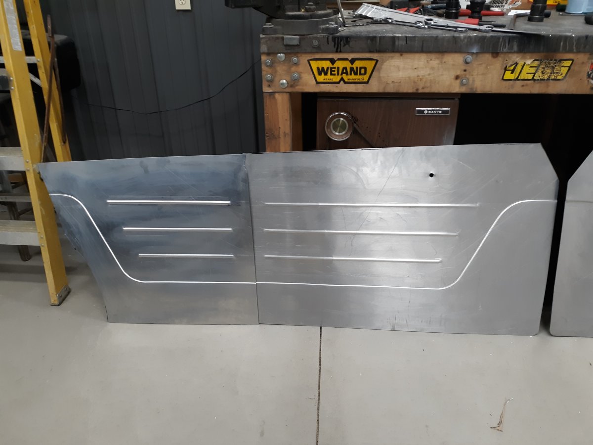

    It’s been a while since I’ve posted on this thread so I thought I’d post a lil update. Ended up buying a house late last summer /early fall so I’ve been pretty busy with all the fun of buying, selling, moving, fixing and all the unexpected stuff that comes up in between. So needless to say, the season kind of ended early last year and I've not really had a chance to mess with the car much.
    Anyway, a few months ago i decided to take a break from the house stuff and sign up for the Cleveland Piston Powered Show coming up in mid march. I’m not really into the whole show car thing and this is in no way a show car but thought it might be kinda fun to do for one time. To me it's an opportunity to go have some fun, hangout and enjoy the car a little whilst the weather still sux here in Blohio.. LOL Plus I guess going to the show is motivating me in a way to finish up some details that I planned to get around to like interior trim, door panels and getting the headers coated and so on..
    Anyway thought I’d share the interior panels i'm working on. I tried to mimic the original 52 door panel trim lines. They aren’t perfect by any means but I’m happy with em especially for my first time using a bead roller. I did have a helper so I guess I can’t take all the credit haha
