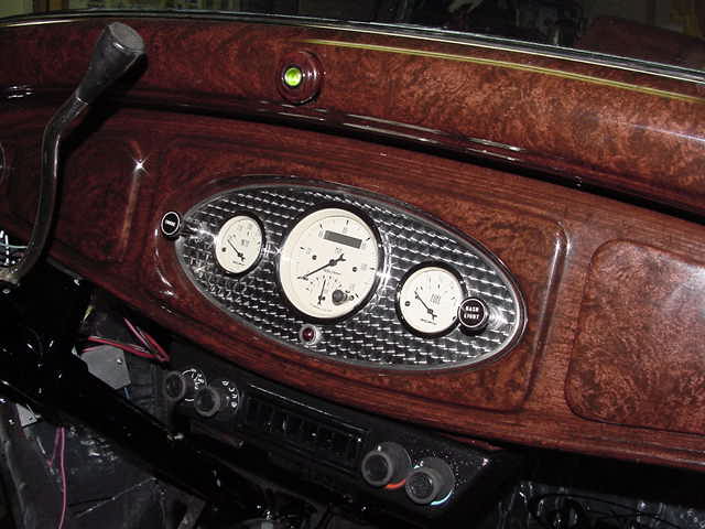

    The Late Randy Nash (deuce roadster) modified the original insert and used SW gauges in his 3 window. HRP

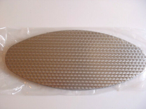

    Just found this, blank '32 made by Vintique.
    I'll be cutting my own holes then !

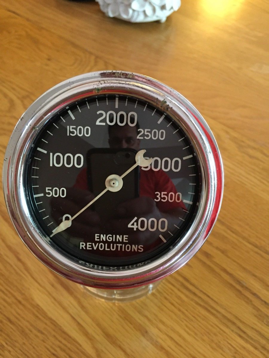

    @Kim Leonard Out of curiosity, which Stewart Warner gauges are you considering? There are a lot of good options out there. With a '32 something to contemplate would be using era correct gauges. They will really add to your car/dash. If you have questions on certain gauges, let me know....I'm one of the resident "gauge geeks" here.
    Below is just some food for thought........
    Old gauges can be restored. They are of such high quality that many of these relics that were made in the 1930's thru the 1950's still work and provide accurate readings to this day. They can also be sent in for rebuilds and calibration if need be.
    I sold this one a while back, but here's a 1932 SW Script Speedo that would be appropriate for your application. I am certain us HAMBers could find you one if you're interested.
    Here's a SW Script tach that would go nicely as well.

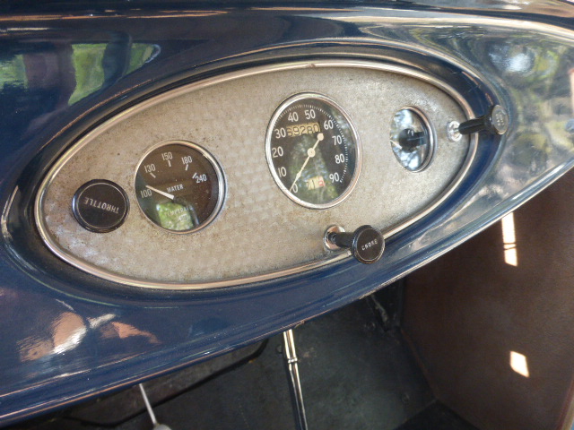

    Hhere's mine. The insert was pretty bad so I just painted it. Enlarged the two gauge holes with a die grinder. Stock Speedo.
