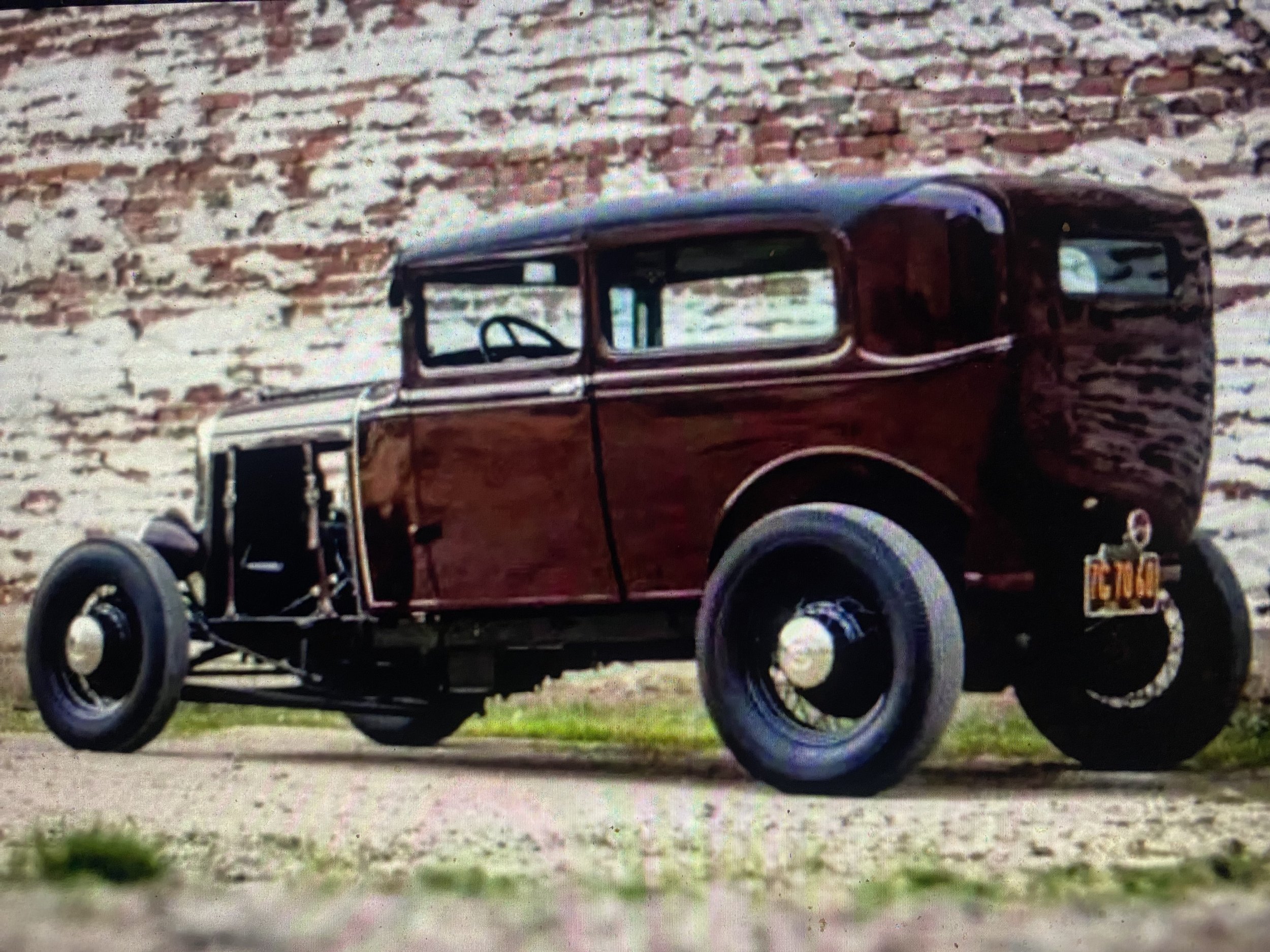

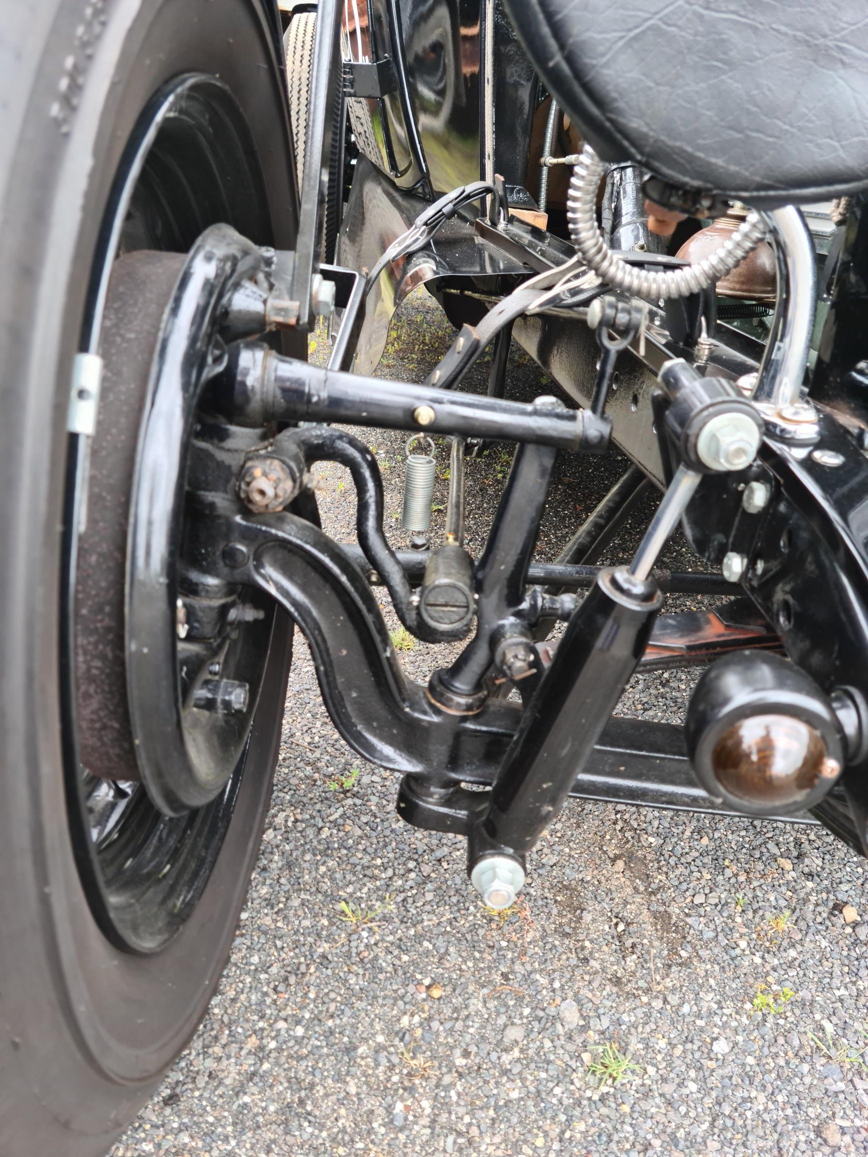

    IMG_8864.jpeg Thanks Gizmo.. That's very helpful. [still learning my way around HAMB]
    My goal is a stance similar to what's pictured above. Any idea what the front and rear drop on this could be?
    It was on BAT a few years ago. I tried to find the eBay listing where it eventually sold but couldn't find it. I was hoping that would have some additional information.
    Thanks,
    robj

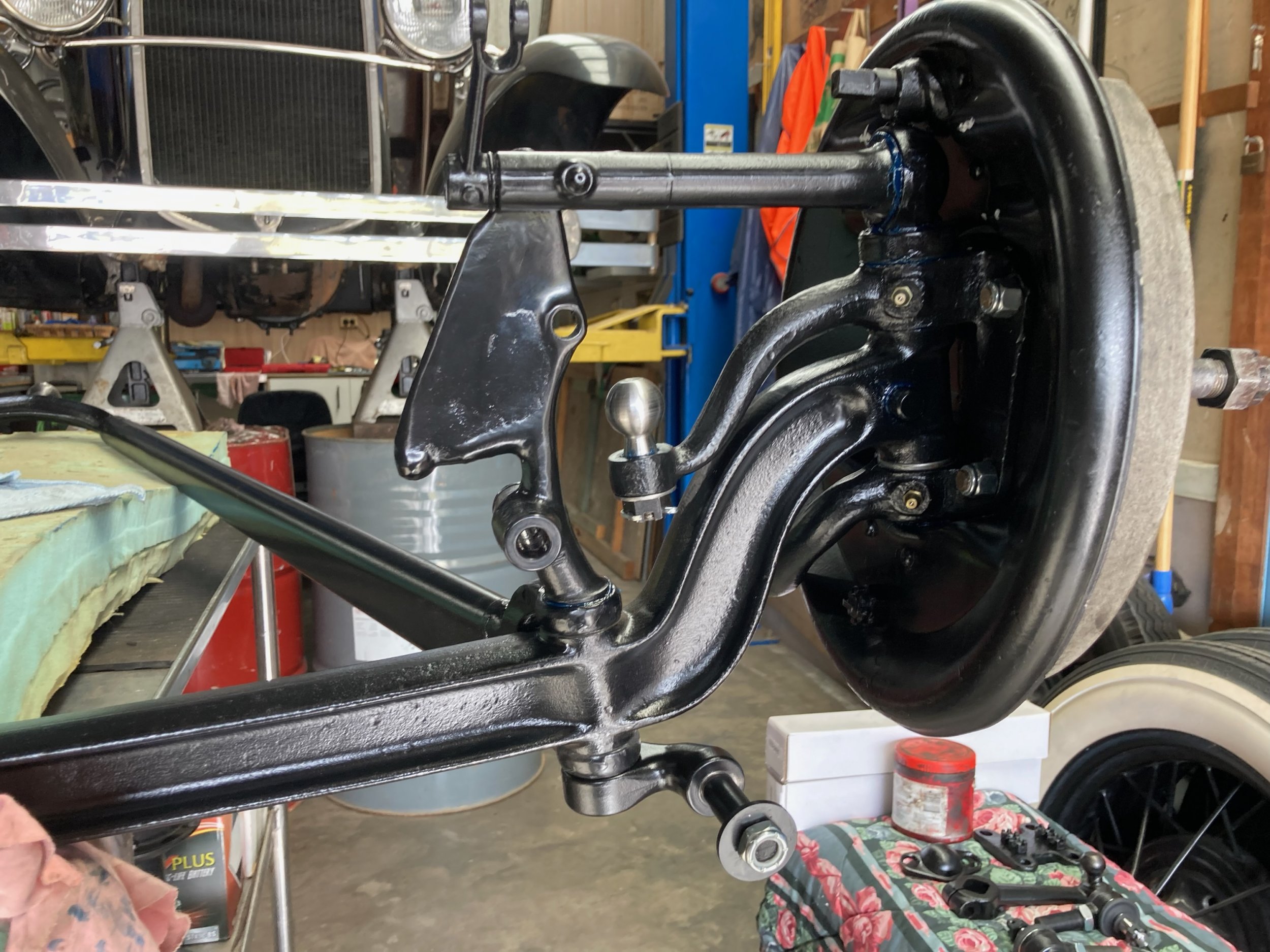

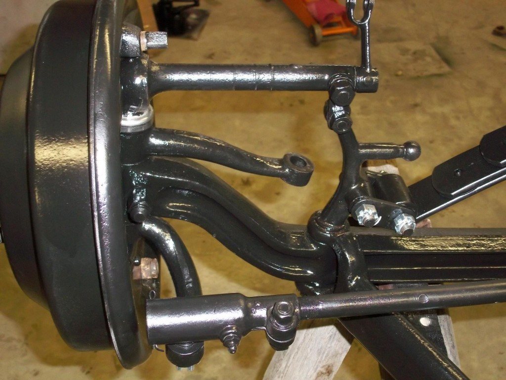

  11. Here's my 4" dropped A Axle with A spindles and juice brakes. Take close notice to what I did for the tierod and draglink program. Mega simple and worked just like a stock Model A. Up-grades are not really necessary when doing Old School treatments.

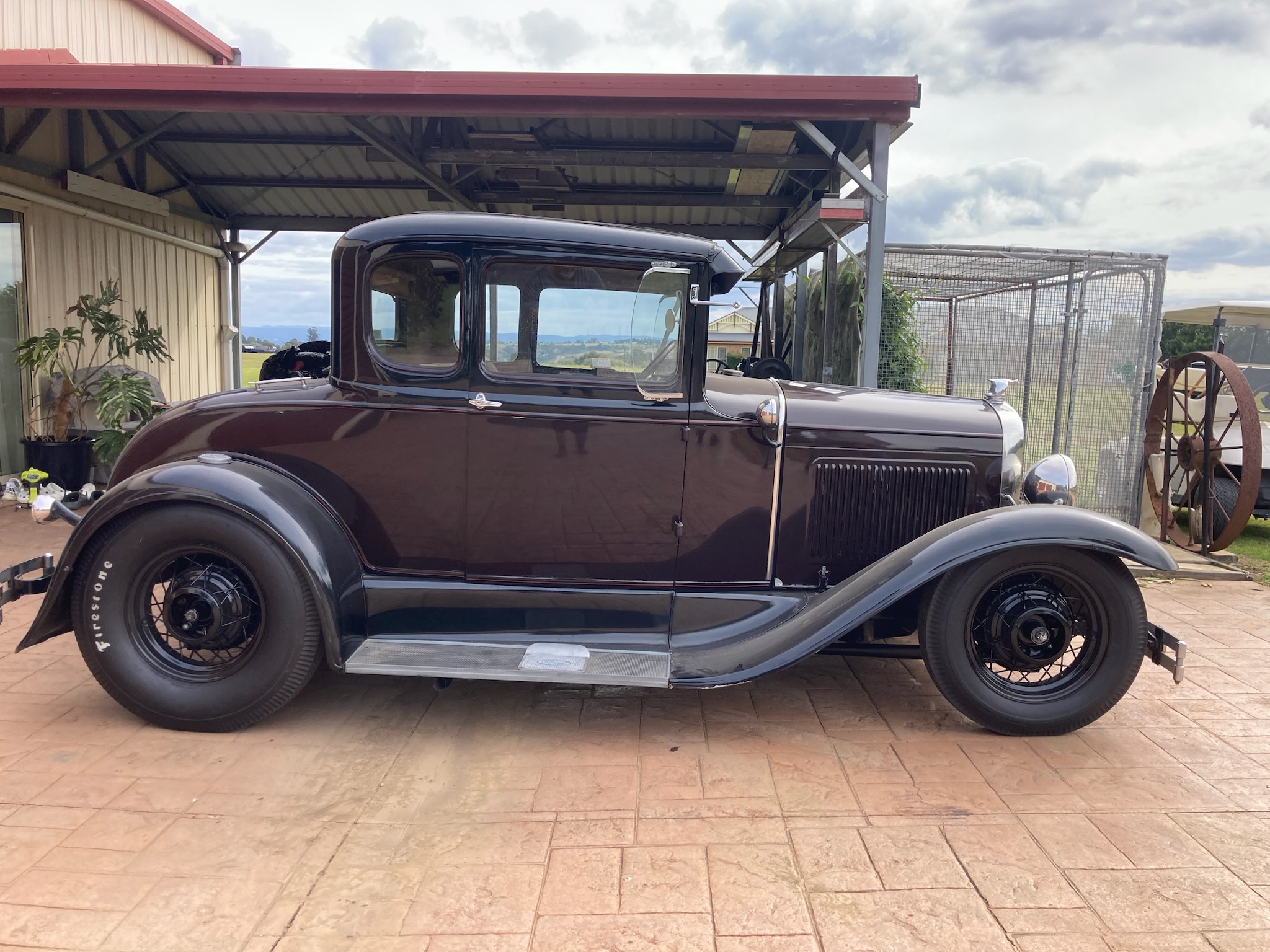

  12. Side shot with full fenders.
