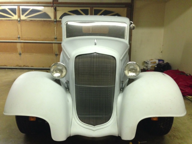

    Got my new grill today. Worked on it til 10p.m. installing it!

    Nice car, you certainly got into it "right".
    Another huge fan of the often overlooked '33/'34 Mopar coupes.
    Thanks for keeping us updated on your progress.
    Also, if you reference your car in the ***le of the post, it makes finding like cars/car owners when doing searches on here.

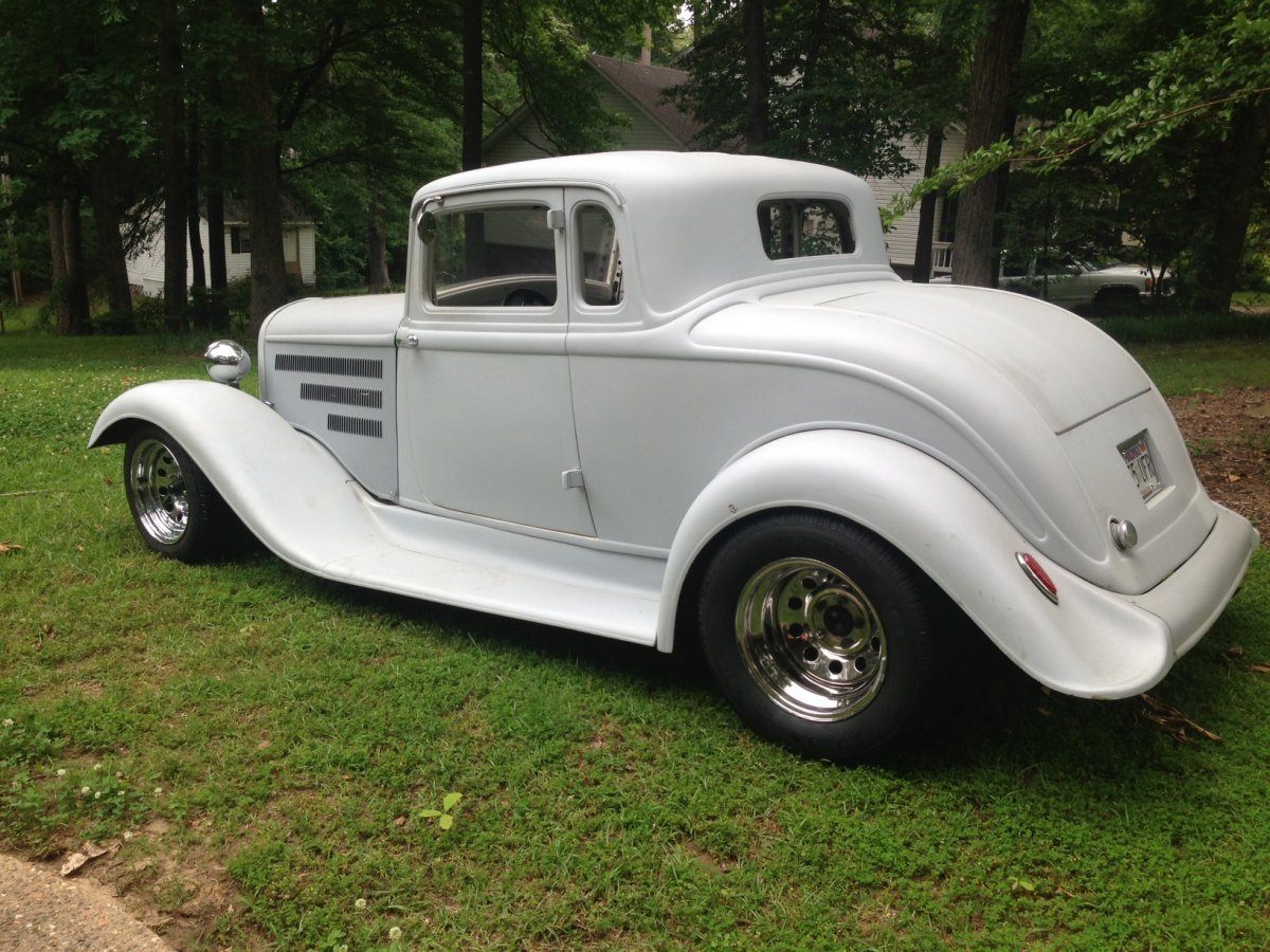

    image.jpeg image.jpeg It's been a while since I posted in this thread. I've been battling a serious medical issue, that turned into issues but I'm feeling better now. I have had the door handles rechromed and installed. I've been gathering stuff to work with, wiper motor, some rubber parts and I finally got all the gl***. Since I bought the car I've put over a 1000 miles on it. Only problem I've had has been a recurring one that acts like it's running out of fuel. I replaced all fuel filters and the fuel pump, so far so good. I'm getting ready to start working on it again and here is a couple of pics I took today.

    Glad you are recuperating now. Lots of empathy on the HAMB when a member falls ill. Bunch of good people here. BTW I'm now a fan of the hood sides. Haha, they look good. Keep the pictures coming, you take good ones. Steve

    Hood louvered sides look menacingly great!
    Take a look at the module in the late Chev distributor. If it was installed 'dry' (no electrical lube under it) that probably compromised it. The problem would arise when the engine is warmed up, running along just fine, then: "CHEVY TIME!"
    The symptoms might mock 'running out of fuel'... If you replace that SBC with a nice older hemi, you can have total reliability, and gain looks of admiration from your peers.
    Seriously, for just a moment: Nice Plymouth, you're doing great! That thing is sure straight!
