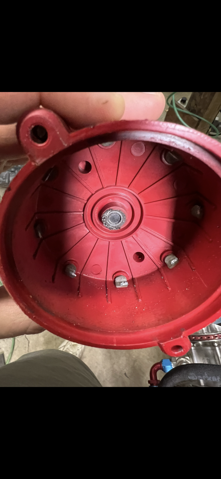

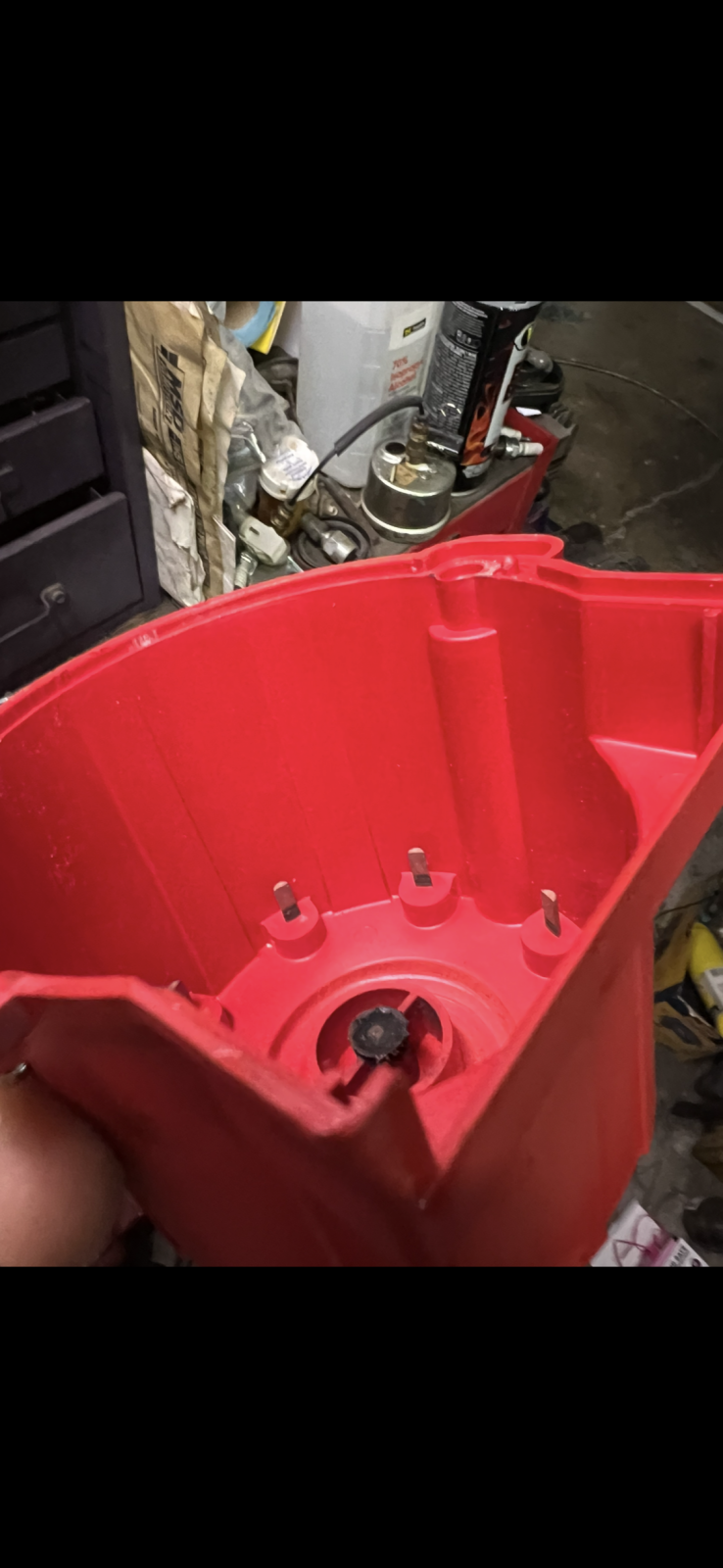

    I have had this issue in last few months,
    Two different engines , & different types of Distributors, both MSD cap/rotor
    1 ,3 or so months
    The other 2 weeks 200 miles
