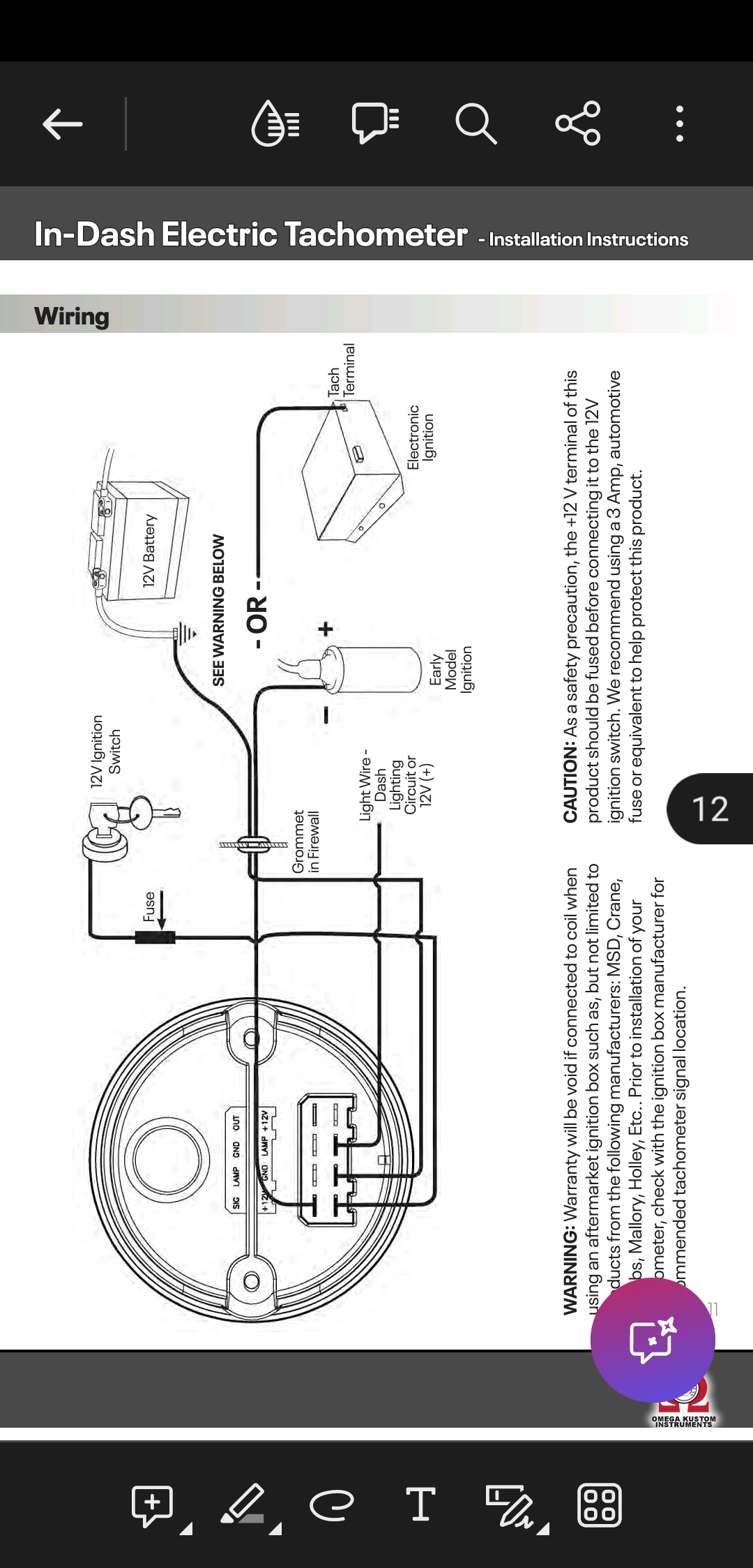

    Well it's been a bit since I updated anything. Took some time off from the car to get some other things done before the snow falls, but mostly got away from it for my sanity, lol. Made some changes and thought I was going in the right direction(still think I am) but think I found at least 1 issue and a couple more questions.
    I ordered a new flamethrower coil with 1.5ohm primary resistance. Same one I had originally and that was recommended directly from a Pertronix tech. Took almost 2 weeks to get here, mostly I think due to the hurricanes, can't control that. Bummer but not a big deal. Boxes looked new and perfect on the outside, but inside the flap holding the coil was torn and the ****** for the coil wire was chipped or sanded flat on one side. Ohm'd it and got 1.1ohms, same as the "bad" one I replaced from them. I called pretronix and asked if 1.1 was good or bad since it tested the same as what we took out. He said 1.1 is bad and not to run it. Has to be 1.5 or it will have issues. So I called the shop back and told them it looks like I got a bad coil or accidentally got a coil that was returned from another customer that failed. I used to work with a company who sold thru all the major parts suppliers and unfortunately it happens more than you would think. They say they will issue a return label and get me another one on the way when they recieve that one back. It took almost a week and a half to get the label from them. Figured with shipping and processing, it would take almost another 2weeks to get the new coil so just ordered another one and had them credit the return. That gets us to today. Got the new coil and it looks great, no damage. Get the fluke meter out and ohm it and...1.1ohm primary resistance:mad::(. Same as the "bad" one and the other one I recieved. I tested the ohm meter on some other non-automotive resistors I have around and it measured dead on what it was supposed to, so I don't believe the meter is off. So now I have to email Pertronix again and find out what's going on. I now have 1 failed coil and 2 new coils that all read 1.1ohm. I am wiring in a 0.8ohm resistor inline before the coil to lower voltage as has been suggested here before, and trying to research online it seems 50% of the people who did this had it fix this issue while the other 50% saw no change or it created other problems. So I guess it's worth a shot if the coil resistance is ok. I'm also wiring the module direct to a switched 12v source with an additional inline switch to cut power when needed as I have read being done on many applications, and is wired that way with points from the factory on many 70s and 80s cars. Mostly mopars and ford's from what I have seen. So I should have approximately 8-9v to the coil and full voltage to the module the way it is wired now. Btw, inline cutoff switches have a higher amp rating than the coil and module draw and have been checked for resistance, 0.0ohm. They are good and won't be a problem.
    Now in testing the wiring and cutoff switches I accidentally discovered something that is odd and could be the cause of all this or it could be nothing. I just don't understand what or how it's happening.
    I was checking the voltage and switches to the coil and module, fluke meter measuring 12.2v at the coil ignition switch on/engine off,flip the cutoff, 0.0v, perfect. Check voltage to the module same results. This was with the negative test lead on a ch***is/body ground, positive lead on the +coil terminal for coil test and module test was +lead to the last connection to the module. Same way I have tested for voltage for 25+yrs working on cars. I stopped and looked away, then went back with the positive lead of the meter back on the coil and got 5.87v. I then realized I had the lead on the ground side of the coil! Ground lead of the meter still on the same ch***is/body ground! I have this voltage even with the power to the coil turned off and positive wire to the coil disconnected! The ignition key was on. Turn it off, power goes away. A little more diagnosis and I take the tachometer wire off and find I have 5.87v coming from the tachometer to the coil negative. Looking at the wiring diagrams for the pertonix module, the coil and the tachometer itself, the wiring is correct to run a wire from the negative side of the coil to the tachometer, but why do I have nearly 6v coming from the tachometer when removed from the coil negative? The tach was working fine, zero issues. But the tach has its own 12v input. I don't believe I should see any voltage coming from a wire that is going from the coil - to the gauge, should I? The attached drawing is exactly how it was wired. Screenshot_20241026_225101_Adobe Acrobat.jpg
    Now after I saw this and started looking at the gauge wiring noticed another issue, the speedometer and tach are in the same gauge(2in1 unit) when looking at the speedometer wiring diagram, the signal from the vss and the signal for the tach from the coil negative both go to the same input? Screenshot_20241026_225424_Adobe Acrobat.jpg Like I said, the tach has worked fine, and the speedo works but does bounce around once in a while. I do not currently have the speedo and tach on the same input , so tomorrow I have to pull the gauge and see how the speedo is wired, but the tach is 100% wired like the diagram. I may try to start and idle the car tomorrow with the tach wore disconnected to see what happens and monitor everything else to see if I still have the same issues or if it's working properly. I know when the car was not starting, I disconnected the tach wire to see if it was causing the no-start issue as it was suggested by someone to check. At that time it made no difference with the no-start issue so I reconnected it.
    I am sorry this is so long again. Just trying to get the details. As I said at the beginning, going in the right direction, but more questions :mad::confused: if you have any ideas about the tach voltage issue, let me know!
    Thanks

    Well again if you made it this far I am sorry for the long previous post. Went to fire it up today and no spark again. With an inline spark plug checker, it would spark one time everytime the key was turned off then tried to crank again, only one time. Went and bought a new ready to run points dizzy from O'reillys, installed and rewired again. We have spark! After a couple tries trying to dial in the timing some it fired up and idled great. Ran for 30-45 min, coil has 11.5-12v going to it now with the inline resistor and only reached about 160° in that time. I think we have a winner. Seems in burned up another pertronix module in about 1.5-2hrs drive and idle time. If the weather holds out next weekend I'll take it for a longer cruise again and see how it does.
    My main question now is still the 6ish volts I have coming from the tach signal terminal of the tach to the negative side of the coil. Currently I do not have the tach wired up, but could this be what burned up the module? I have cut off switches on the positive side wires to kill power to the coil and module, but didn't think there would be voltage in the negative side. Maybe this is normal for electric gauges? Idk. If the car runs and checks reliable, not having a tach right now is minor. I'll see what happens in the next 400 miles.
    Thanks to everyone in this thread offering ideas and suggestions!
    Any ideas about the tach voltage are welcome

    More than just a few times I have seen a tach cause ignition problems. I've unplugged them and problem solved.

    I’m lazy when it comes to reading, so I’m not sure if this has been covered. If it has just disregard. Are you using a Pertronix Coil?
    I have never had an issue with Pertronix performance, but I know many who have. They all were running non Pertronix coils. Just my 2 cents.

    Negative wire voltage at coil when power is off.
    What is voltage at tach with power off?

    It is not uncommon to have voltage reading on negative wires coming out of devices if they are not properly grounded or you check the voltage prior to the final ground. The problem you have is the the negative post from the coil should not go to the ground on a tach. The voltage feeding in the negative post on the coil is reducing the effective voltage the coil has which causes your coil to over heat and is most likely the cause of your problem. Notice in the diagrams you posted, the coil does not go to the tach ground. It goes to the signal input wire. The ground is separate on the tach diagram. You would need to ask the tach manufacturer, but there should not be voltage back through the signal wire. So you either have the coil wired to the tach ground, or the tach isn't working 100% correctly.
    Edit: Try unhooking the tach and then drive the car and see how it does. Double check the actual ground wire to the tach and make sure it goes to a ground.

    I wouldn't worry too much about a voltage backfeed from the tach sense wire, at least not measured with a modern digital multimeter - those are VERY sensitive and may give a high voltage reading in many situations despite a high resistance is in place preventing any significant current to flow.
    If you want to test that, put the meters negative wire on the 12V car battery negative, hold the positive wire between the fingers on one hand, and touch battery positive with the other hand. The meter will probably show close to full battery voltage - wet your fingers and you'll get even closer. You see a high voltage despite measuring through your body that doesn't conduct electricity very well.
    In a case like this I'd disconnect the tacho for a while and make sure it isn't a factor in the problems, simply because they are a common source of ignition problems, when they let too much current through from the signal wire.

    So surprisingly I already recieved a response from Pertronix. They said absolutely do not run the coil if it reads 1.1ohm as it is a faulty unit. That makes 3 flamethrower coils p/n 40111 bad out of the box before they were even installed and connected to any wires. So I don't know what to do about that. They also said I cannot add an external resistor before the coil. Didn't specify why?
    Pprather and snoc653
    The 6v is in the wire going from the coil ground to the tach signal wire. Not tach ground. This is with the key in the run position only. When key is off no voltage.
    As suggested for now, the tach is remaining disconnected until I can try to get more info from the manufacturer. In the little time it has ran, I have noticed no difference in how it runs with the tach disconnected. That again is why I am curious if it's even a problem. I will try to find another coil with 1.5ohm primary resistance, but there is no longer any local performance shops so I'm guessing it's back to summit or speedway. If the weather is nice this weekend I will put it all together as is and drive it just to see if there is improvement at all.
