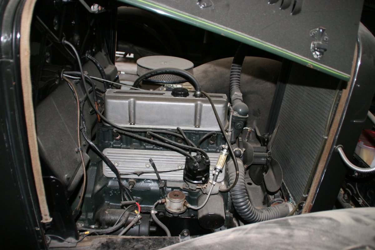

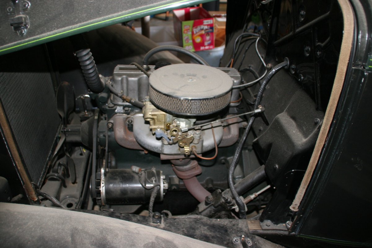

    Well ya guys aren't gonna like it but I think I've landed back on a 2.5 tech4 2.5 engine, T5 and rear end from a '91 S10 for my Model A. Low buck and maybe fool few folks into thinking it's an overhead kit on a stocker (no I won't try and p*** it off). I just can't see near $5K for an engine rebuild to end up with less performance and reliability. Anyway want to keep it looking sort'a old school. Hope to ditch the serpentine belts and ecm. Need to adapt carb. to stock manifold because of course no one makes a manifold. As much as I would like to run the 97 I have, the cfm calculator says it should have somewhere around 200 cfm. Figure easiest and best performing would be a weber 32/36 type but not so kool looking? I can find normal v-belt set-ups of earlier set-ups but not sure about the water pump rotation and/or fitment?? Also there are HEI distributors off earlier ones but would love to find/adapt an old school looking one (I'm not spending $500 on a Mallory). Anyone got any Ideas?
