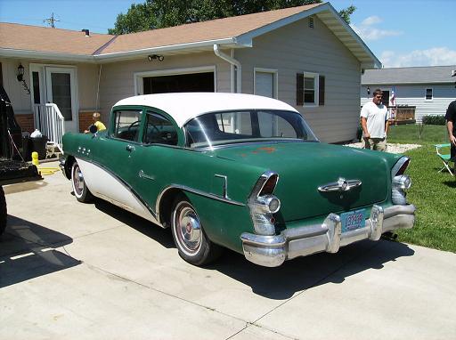

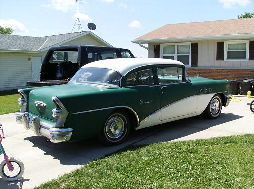

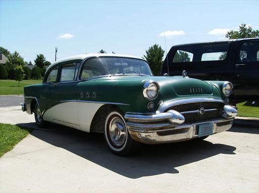

    Well, I'm new here. I own a '55 Buick Special. 100% original and everything functions properly. That will probably change soon.
    My question is when I put the dynaflow tranny in "D", it slips if i give it to much throttle, so I feather it to get it up to speed, but after about 1/4 mile of letting it warm up, it runs just fine.
    Here are a few pics of my ride.
