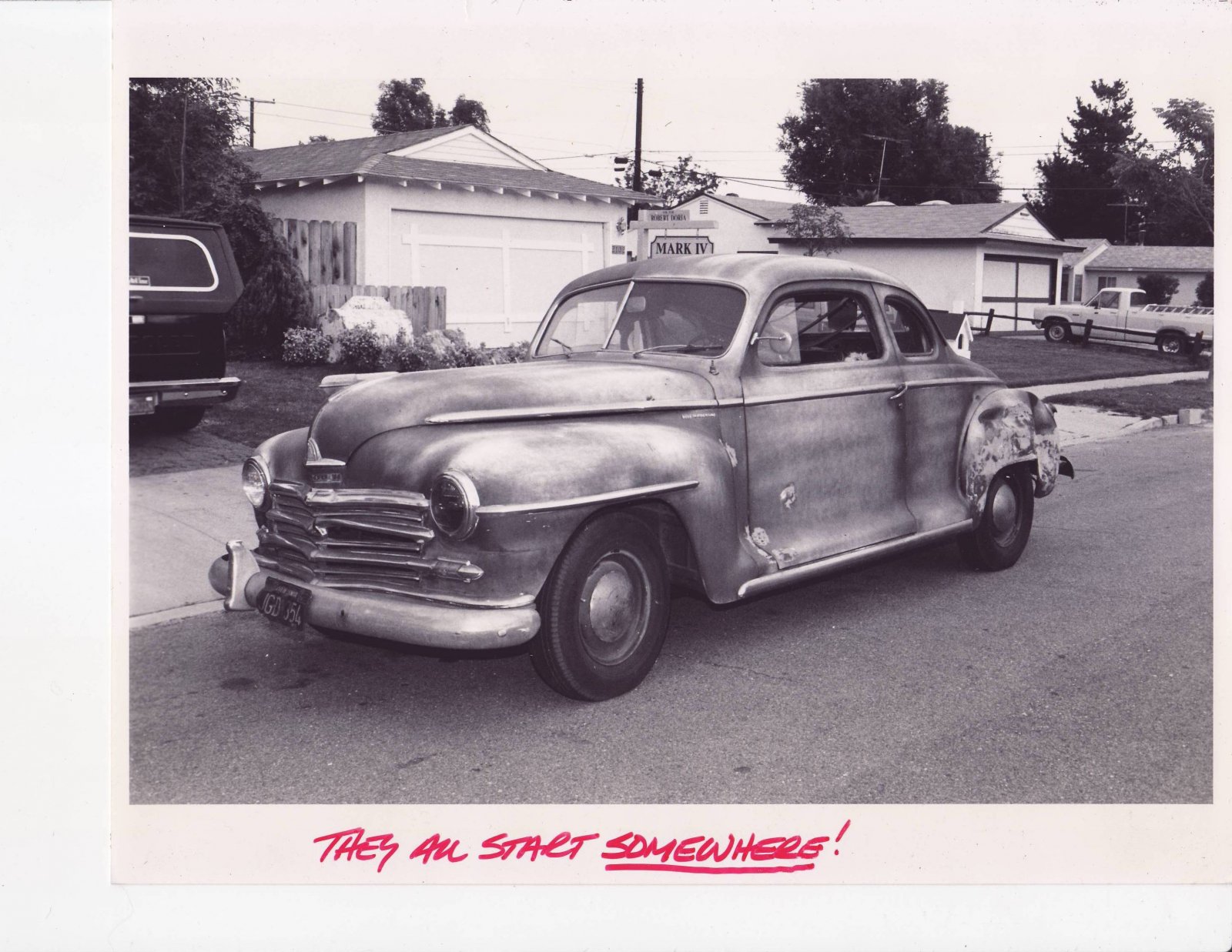

Lots of Plymouth guys here on the HAMB, Tony, and a bunch of them are still running the original flathead 6 and running gear. Actually, 62,000 miles was relatively high mileage back then when cars needed constant attention to stay serviceable. But if yours was well taken care of it'll run like a watch for many years to come. If it starts and runs with a 12-volt battery it's probably already been converted. Look for a voltage drop device in the electrical feed to the gauges and check for 12-volt light bulbs. If it's got 'em you're already good to go as long as the wiring is in good condition. If the fabric wiring is deteriorated plan on a complete rewire. You'll want to go through the brakes and replace all the rubber parts with new even if the linings are still good. The good news is that these old Plymouths don't require a rocket scientist to repair, just some general automotive knowledge and a good factory repair manual. Oh, and don't forget that the lug bolts are left-hand thread (lefty-tighty) on the left (driver's) side and right hand thread (righty-tighty) on the right (passenger) side. Don't get the drums mixed up when you do your brake job! Good luck! Edit: Here's a picture of my '48 Plymouth the day we dragged it home. See, there IS hope...!
Oh my, I am glad you said something about the lugs. That would have been bad! Thank you! I am used to working on my own cars, but never this old of a one. I am honestly very excited about owning this. Everyone local to me, told me to do a complete drivetrain swap, I honestly like the stock motor look! Its unique! I will upload the video clip tomorrow, of it running. It sounds like a sewing machine, and very smooth. I just seen a new battery and coil. The generator looks untouched though. So I am honestly not sure. Maybe I will pull some bulbs and see if I can tell. My buddy told me there is a 6 volt voltage regulator on it though. If I put my volt meter on "somewhere", while running, will that tell me. I am good with mechanics, but I hate doing electrical. I did rewire some old Beetles back in the day, but there wasn't much to them. I was looking up the master, wheel cylinders etc. I am surprised that it is not harder to get some of these parts. I did notice the front must have two wheel cylinders. Upper, and Lower, according to rock auto. I am still trying to figure out if its a cranbrook, or cambridge. I can't figure out how to tell.. Nice 48!!!! I have always wanted an older car, after raising 4 kids, and always playing with some cars over the years. I finally got what I wanted. And I only paid 1300 bucks for it. Thanks for all the info.
