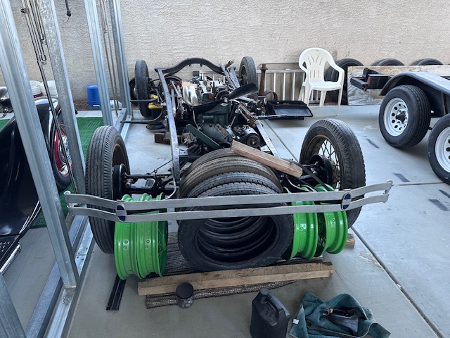

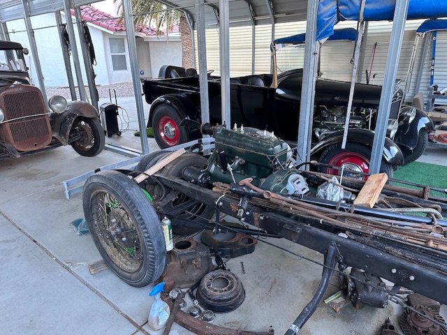

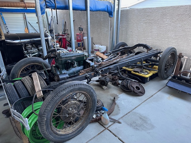

    there's army ranger green and air force forest green.... what ever looks best with my ugly *** wires that are green...

    got no idea why those wheels were powder coated that color green, migh look good w/ satin black???? or???

    it's going on a restored Model A ch***is...

    Those bright green powder coated wheels can easily be painted any color you choose. The scuffed up powder coat makes a great spray bomb, or sprayed paint base. At least, that was what I read here on the HAMB.

  23. The wheels are fine It's just the color is a little to in your face In my opinion. The plus side is powder coating is an excellent base coat for a different color paint. Just lightly break the surface with some 320 grit sandpaper and then spray away either using a urethane or an aerosol.

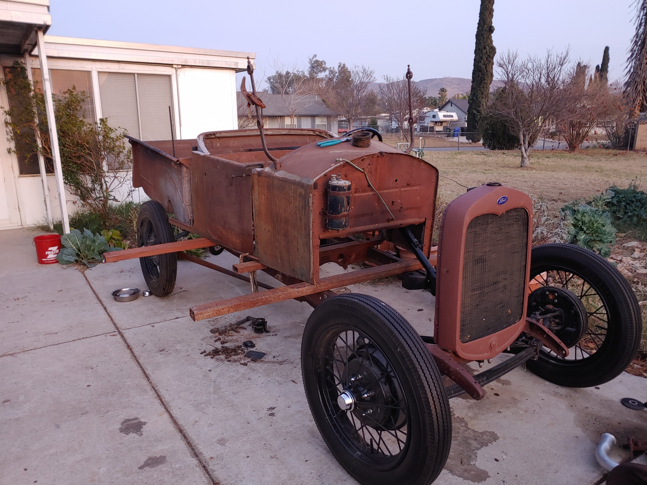

    I am doing the same thing but I don't have a nice Model T body instead I got A Hupmobile Model R (1918 ish) and a Model A wide bed along with a 30-31 Model A truck (painted) grill shell, some scaly 1935 Ford wires and a model A frame and a dropped axle.
    This was it rough marked up about a week ago It needs to go way lower, I don't have any intention on a Z'ed frame but it I would like it to get a lot closer to mother Earth. 0131251732.jpg

    is that a 4'' drop??? wires look like 19's or 18's... I have 10 or 15--- 16'' wires...some nice some scaly...yours will come down a good amount dressed out...back in the day i use to stack rock salt bags in the car to see how far... yours will be cool when done, and fun build...
