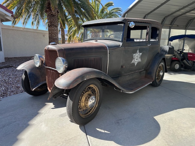

    My T is also a '26 RPU cab and is also on a Model A frame. It's not Z'd or stepped and isn't super low but not super tall I don't think either. I'm personally not fond of a big step in the frame that ends up putting the top of the pickup box level with the back of the cab, looks odd to me, but that's my personal opinion.
    If it was me, I'd paint everything black and put it all together on the frame, reversed spring eyes and maybe a dropped axle and/or flattened crossmember but without the step in the frame. I do like the look of a shortened box, but not too short, just enough so the wheel is in the center without a huge overhang. I was looking for a box for mine when I ran into the early turtle deck and just used that instead. No channel, and a dropped footwell behind the pedals for a bit extra space. Mine's got a V8 but I wouldn't mind a 4 banger at all, maybe with a header and a downdraft intake/carb.

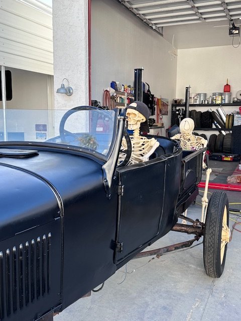

    what did you do on the windshield??

    My friend Crazy Joe actually built that windshield, he's the guy I got the car from originally, it's the bottom section of a stock one and about 2 or 3 inches of the top of the top section put together, to make a frame that goes all the way around, and the posts were modified to match. That way there's no exposed gl*** edge, and a bit more windshield height than just using the bottom half of a stock frame. I do wish it was taller though, as I'm pretty tall and I end up looking over the top of it (Joe is a lot shorter than me). I do like the one piece setup though, and it makes a handy spot to clamp a rear view mirror onto.

    when I looked at it it looked about 2 or 3 '' taller and figured thats what you did.... lotsa work... but it looks right and cool...

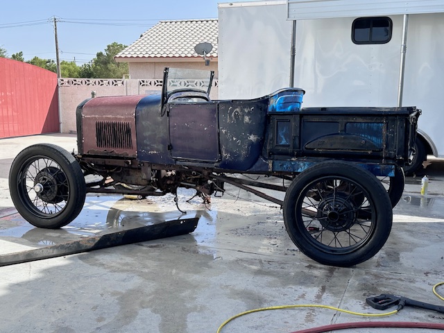

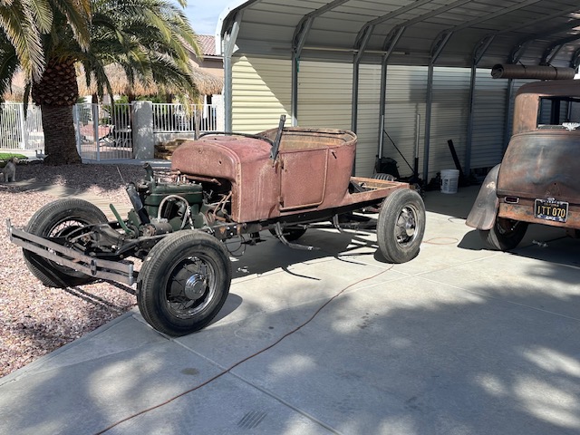

    The wheels that were in the photo are stock 28/29 Ford 21-in wires, at first I wanted to go late 1920s race car with a homemade wood body using a Model A ch***is, I probably spent 15 hours sanding those wheels and spraying them with rustoleum paint. As I was was starting to ***emble the jalopy I all of suddenly realized I wanted to build a pre war banger or at least something real close to what they would have built in that time frame on little to no budget (My goal is $3,000 including registration so far I am way under budget) .
    Anyways I have the hupmobile touring body, I had it for sale for months with no takers so instead of letting it rot away I think I'm going to use part of it (The shameful part is, it's a complete touring body and I hate butchering something relatively complete it has the fenders the rear doors the hood, rear body steel and I think even the steering column), I will post a picture of it from when I originally had it listed on craigslist. realistically I would like to come across a T or A roadster pickup body that I can afford.. I check the cl***ifieds pretty much every day here in SoCal I'm sure if I'm patient something will pop up meanwhile I can build the ch***is in the meantime and if nothing pops up by the time I'm ready to do the body I will cut up the Hupp. I literally (as in today) just bought 5 tires, a pair of Firestone blackwall 6.00-16 for the rear, 1 used and a single 7.00-16 (I think that tire is a little big for a pre war Model A but we will see) and I bought a pair of used but new if that makes sense 4.00/4.50 Firestones Blackwalls for the front, these are for the 16-in wires that aren't pictured, The wire wheels I have to paint, They were found in a garage up above the garage door displayed like a flag and they were powder coated "patriotic" meaning red, white and blue, I donated the white wheel to a buddy before I realized I had a use for it so I have 2 scuzzy wheels I bought at a swap meet and along with the red and blue wheels I now have a set of appropriate big and littles that should look pretty correct for what I'm going for, I figure a coat of spray can gloss black with some reproduction brand new hubcaps that I also bought for practically nothing will make it look like a million bucks.
    The front axle was actually bought at a swap meet in San Diego, for some reason it was stupid cheap I bought it near the end of the day and he said nobody asked about it.
    I have been buying everything at estate sales, swap meets or through the cl***ified ads with the exception of the consumable items that I have to buy at CW Moss (brake hydraulics, The leaf spring bolts, new brake shoes and springs and a few other odds and ends).
    The photo I posted a day or two ago was just to give me an idea if the body would fit and honestly it's a little big for the Model A ch***is. A Model A wide bed fits the Hup-body really well width wise It's just my ch***is needs to be about 5 inches longer but I'm limited by the 42 to 8 rear axle that somebody cut down and did a spring over conversion on for a Model A that I also bought at an estate sale, I guess technically I can probably change the torque tube an original length one and then lengthen the frame but I think it'll lose the tiny car cool factor that a hot rod needs.
    Anyways I'm doing this on my back patio as you can tell in the picture, This weekend weater permitting I'm going to get the engine and trans in the ch***is, I have bought some performance stuff for the engine but I think I'm just going to put it in there stock for now so I can keep moving along. I probably need to make a build thread I'm just not real good at do***enting my work and a kind of bounce around between projects as I have money or parts. Anyways here is the picture of the hupmobile body complete.

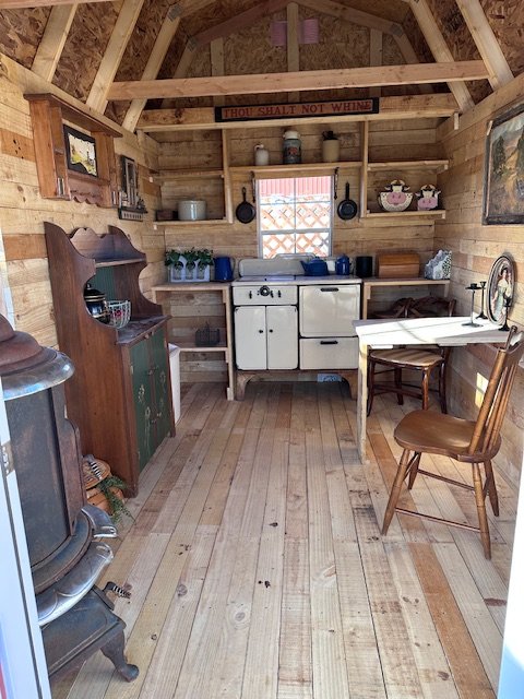

    the vicky got a 36 front axel, 48 chevy tail lights lighted plate frame and brake lights so I can drive it...far from done...also built a play house cabin for the grand kids..milked that job long as I could.. IMG_4529 - Copy.jpg IMG_4662.jpg IMG_4667 - Copy.jpg IMG_4681.jpg IMG_4682.jpg IMG_4684.jpg

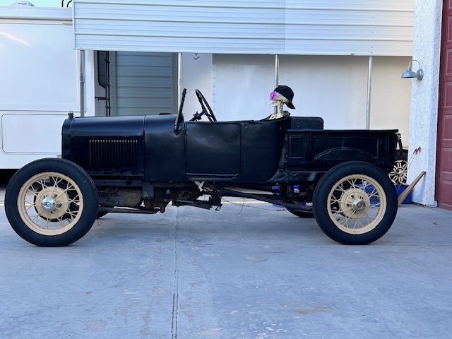

    little progress on the AT, A ch***is w/ T body... put the 600/16's square...all for corners the same... figured running in the dirt the bigger tires on wider rims would be better...of co**** I don't know nothing about any thing so surely it a bad idea...I set the body on,and have a too nice truck bed... I really hate to cut up, so watching for another bed...at the cross roads for the front axel... ??? 36??? or 4'' drop??? and the brakes... I have all the stock brakes.... but don't know how to put them on...but, I don't know how to do anything, so not a surprise IMG_4806.jpg IMG_4807.jpg IMG_4808.jpg IMG_4809.jpg IMG_4810.jpg IMG_4811.jpg IMG_4812.jpg

    oh, and heres more pics of the cabin... collecting old stuff for it...
    I took my labor out in trade... one of the only times I come out on trade deals you know your gonna end up F'd on the deal IMG_4667 - Copy.jpg IMG_4667.jpg IMG_4670 - Copy.jpg IMG_4670.jpg IMG_4672 - Copy.jpg IMG_4672.jpg IMG_4673.jpg IMG_4674.jpg IMG_4675.jpg

    so whats the though on the 16'' wires ... keep um or keep looking???

    Green looks alright, with or without W/W
