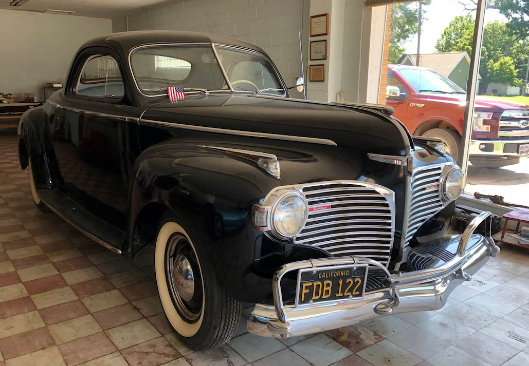

  1. IMG_1309.PNG Thank you Gentlemen for all your input !!!
    First intention was to buy performance stuff soon to throw it in trunk for saving shipping costs.
    The reds headers I will order torday, maybe will do a antrazith ceramic coating for better look.
    These Transmission is a Mysterium to me. The big cylinder on the left is maybe a power clutch?
    Have to wait 12 weeks to get the car in my garage... enough time to philosophy about the engine

  2. Looks like that cylinder ia a vacuum ***ist. The park brake is that drum gizmo on the tailshaft.

  6. I know the Low-formance from my 33 Rockne Flat6. Torque isn’t that bad, but it’s not a rocket.
    I will not open the engine or do something big, was only looking for some hp thru contemporary adaptation/ optimizing.
    When i need the speed, i can drive my 427 Ford..
    So at the end my choice will be split headers for the sound, Bigger 2Barrel or double Carburetor (will see what i get) and a 12V conversion with better Distributor.
    That should be enough for the ol Dodge

  20. Yes you are right. I would prefer more torque instead of HP. My Wife's starliner 352 is a heavy car, but its torque propellered it very fast at the traffic light. That's what count. more than 60-70mls I will not drive such an old car.
    So what's the best way to impair the torque?
  21. Oh I know these swap meets in US very well. Been in Carlisle PA and Columbus many times and saw a lot other Shows and Meets. The most Problem is to find the needed part just in tis small time slot while I am there...
    Personally I like the originality of these Coupe very much, I don't like to tinker it. Some good improvements yes, but not like a hot rod or a fair carousel.
    Changing the head isn't rocket since, maybe I can find a head for a reasonable price and throw it in trunk for shipping. Shipping by parcel service becomes unbelievable expansive the last years.
    I shipped a 9" Ford rear in 3 separate Boxes for 60 Bucks all together by UPS 20 years ago. Same thing will cost today more than $500...
