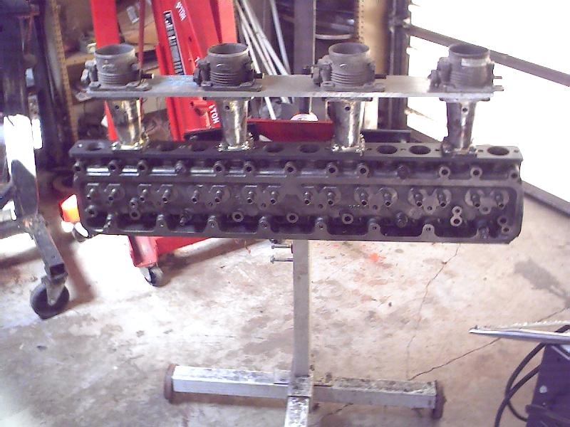

    This is for EFI I guess. Here is what I did on a Banger. Been pictured here before. I also made one with three throttle bodies for a 261 Chevy and one with four to go on a Buick Straight eight.

    Bad news. I cheat. I didn't use the EFI parts but substutited Hilborn mechanical injection. I have made these things with 4.6 Ford SCHC throttle bodies (Shown) Suzuki throttle bodies. (Shown in this post) 351 Ford F150 throttle bodies. Hilborn throttls bodies and home made throttle bodies. The work just fine and sure beat Hilborns prices. Sorry Stu.

    Here is another one I did for a 3 liter Nissan SOHC V6. For mine I put the Hilborn nozzles where the EFI nozzles should have been. I made the butterfly and put it in the air scoop I don't know why you couldn't grab the entire setup from a six cylinder EFI car and install it on yours. If you go to the Inliners International web site there are several threads by people who have done just that. Some of those guys sound very smart and the conversion seems to work very well. PS the yellow thing pictured here went 231 unblown so it worked OK too.

    Couple more I did. Construction shot of the Buick and a OHV four cylinder. No cad cam. No drawing at all. Just start cutting until it looks right.
