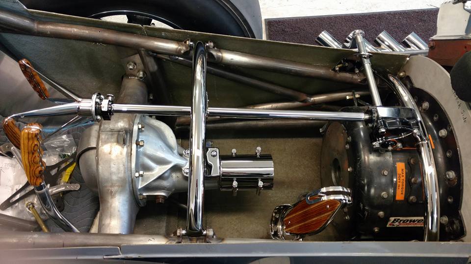

    You need to "Key-Hole" the tab for the rerverser, after awhile they tend to get loose and pop out of gear. Since the tab is welded to housing-now would be the time to change it.
  5. ChassisResearchKid
    Joined: Feb 18, 2006
    Posts: 784
    ChassisResearchKid
    from Michigan
    Bruce. I can still so that and that is the plan. I just plan on slotting the tab and turning a grove in the handle on the lathe.

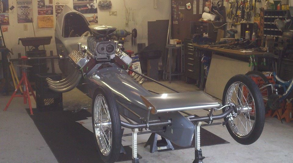

    Sorry once again for the delayed updates, but when the Hollish car comes out work stops on the new car. Winter is on the way so I'll get back on it soon. I did manage to score Don Long spill plates and connecting rods for a front wing. Everything was "raw" and needed to be machined and hand filed. wing.jpg wing2.jpg

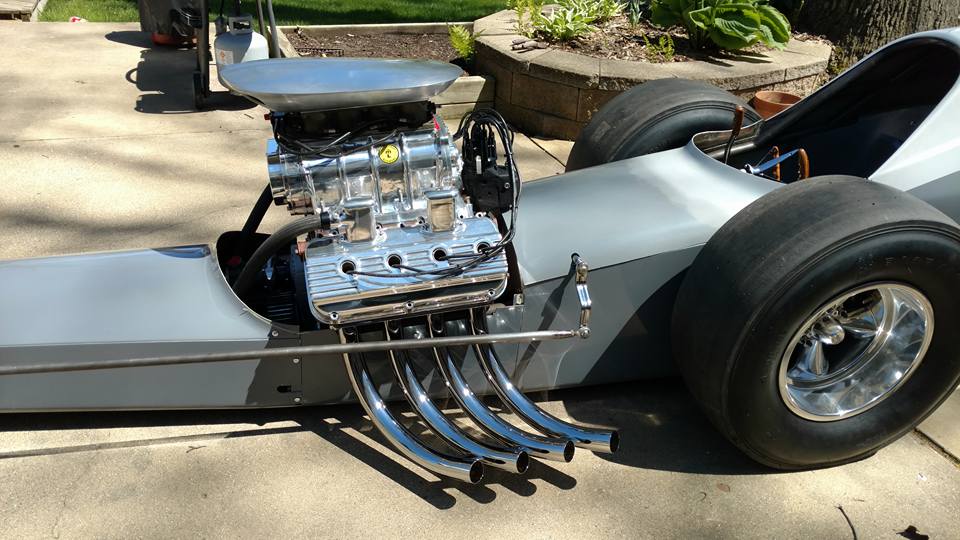

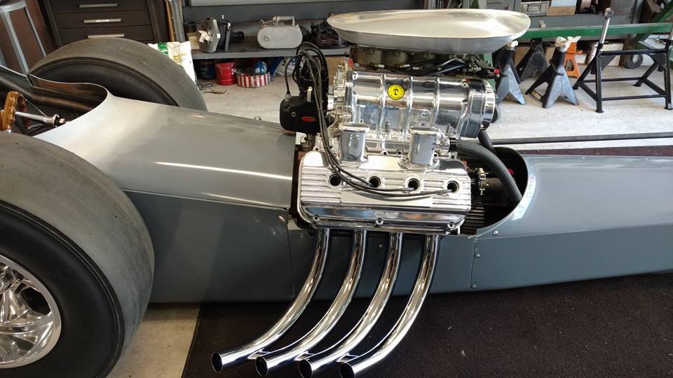

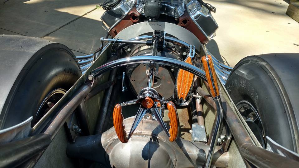

    DonoWizvans.jpg polished.jpg polished1.jpg cover2.jpg cover1.jpg cover3.jpg cover.jpg wing4.jpg wing5.jpg wing6.jpg rockers.jpg up.jpg mounted.jpg mounted1.jpg Well It's been a while between updates but here is the latest. Body mount tabs 95% installed, Corey Conyers updated my Donovan breathers to make them NHRA legal (per my Ideas). Coupler cover made, Valve covers polished, Intake polished. Matched the wood from the pedal, wheel, and brake handle to the front wing and got my Dearmore Rockers from Roger (RiceMan) Lee. Not much else to say for now.

    UK Slingshot
    How did you make your breathers NHRA legal. Got some MT breathers similar that I need to do something with.
  22. rooman
    Joined: Sep 20, 2006
    Posts: 4,045
    rooman
    Ponti461,
    look closely at the photos and you will see a stub for the burndown tube welded to the front breather stack on each cover. Really only required if you plan to run NT/F but not a bad idea.
    Roo
  23. ChassisResearchKid
    Posts: 784
    ChassisResearchKid
    from Michigan
    Rooman is right. However the top of the breather was also cut off and and a plate welded into the mushroom part to seal it up and make it a non-breather.

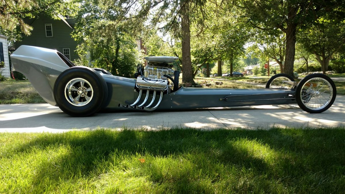

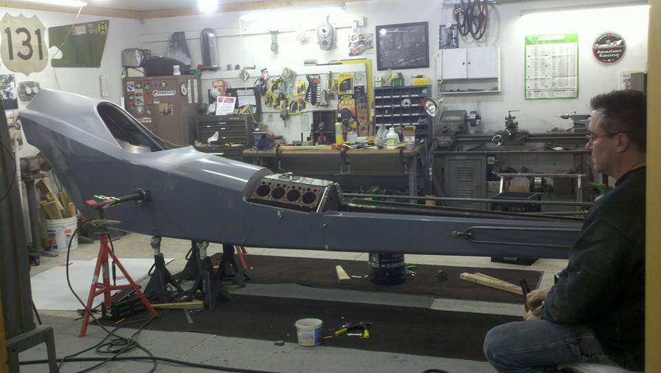

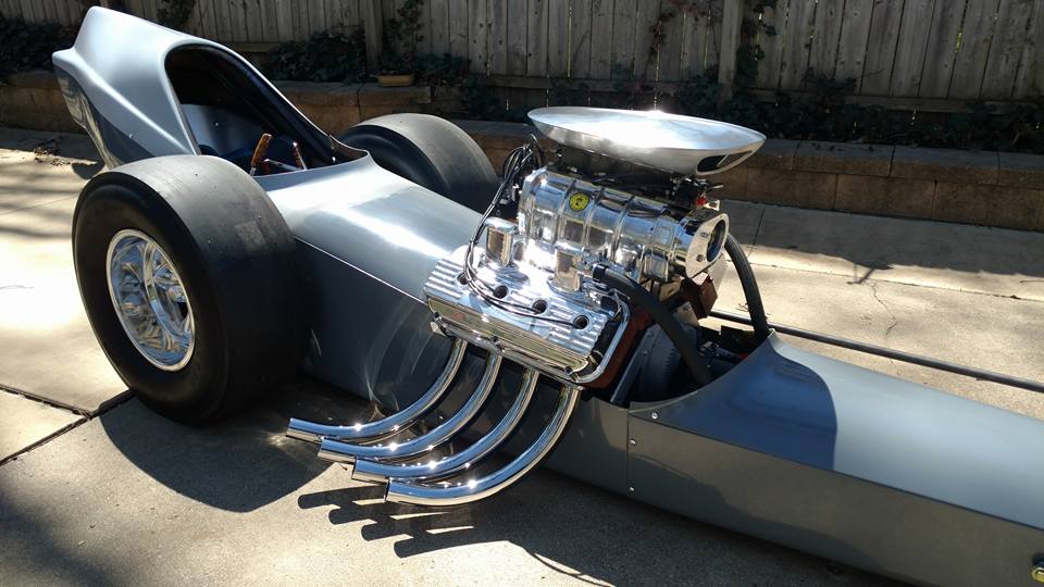

    Well, the body is 95 percent mounted. Scored a real Frankenstein Magneto. I'll be mounting the swing clutch pedal at some point this weekend.

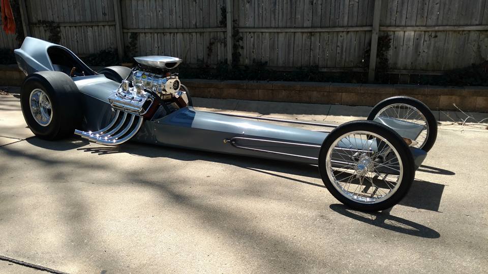

    More.
