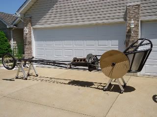

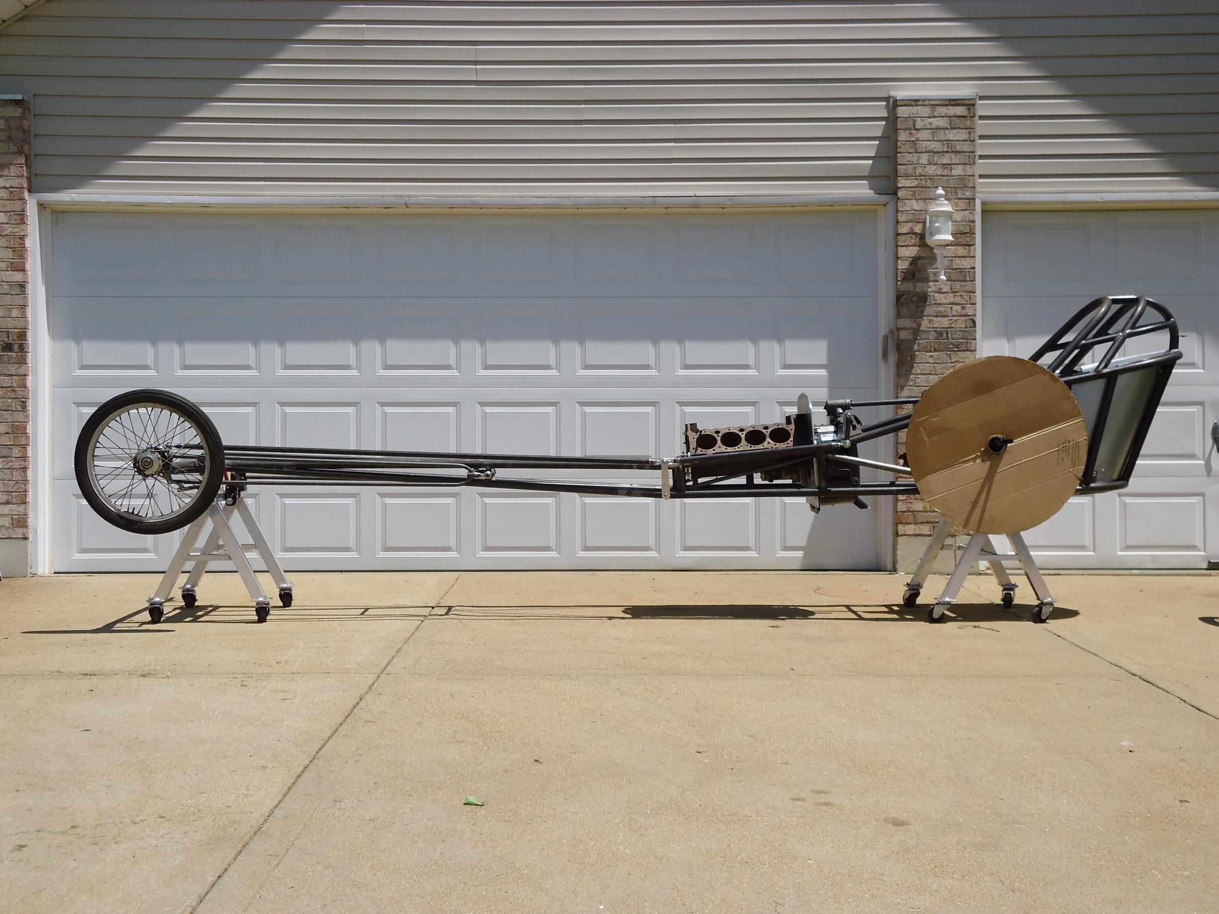

  19. KING CHASSIS
    Joined: Aug 28, 2005
    Posts: 1,864
    KING CHASSIS
    Well progress photos as promissed.
    Got the cage done and all the steering finished.
    Just have to do some finish welding and work on the seat a little.
    Then its Todds turn.
  20. KING CHASSIS
    Posts: 1,864
    KING CHASSIS
    Another shot.

  24. 51box
    Joined: Aug 31, 2005
    Posts: 1,107
    51box
    from MA
    looks really good King, I like how laid back and low the cage is.
  25. trifiveshawn
    Joined: May 9, 2010
    Posts: 56
    trifiveshawn
    from Ohio
    Man that looks awsome.. i dont think shes gonna hook on those cardboard wheels tho :D
  26. KING CHASSIS
    Posts: 1,864
    KING CHASSIS
    Your right about the tires!! Especially if you spend too much time in the water box.!!!
