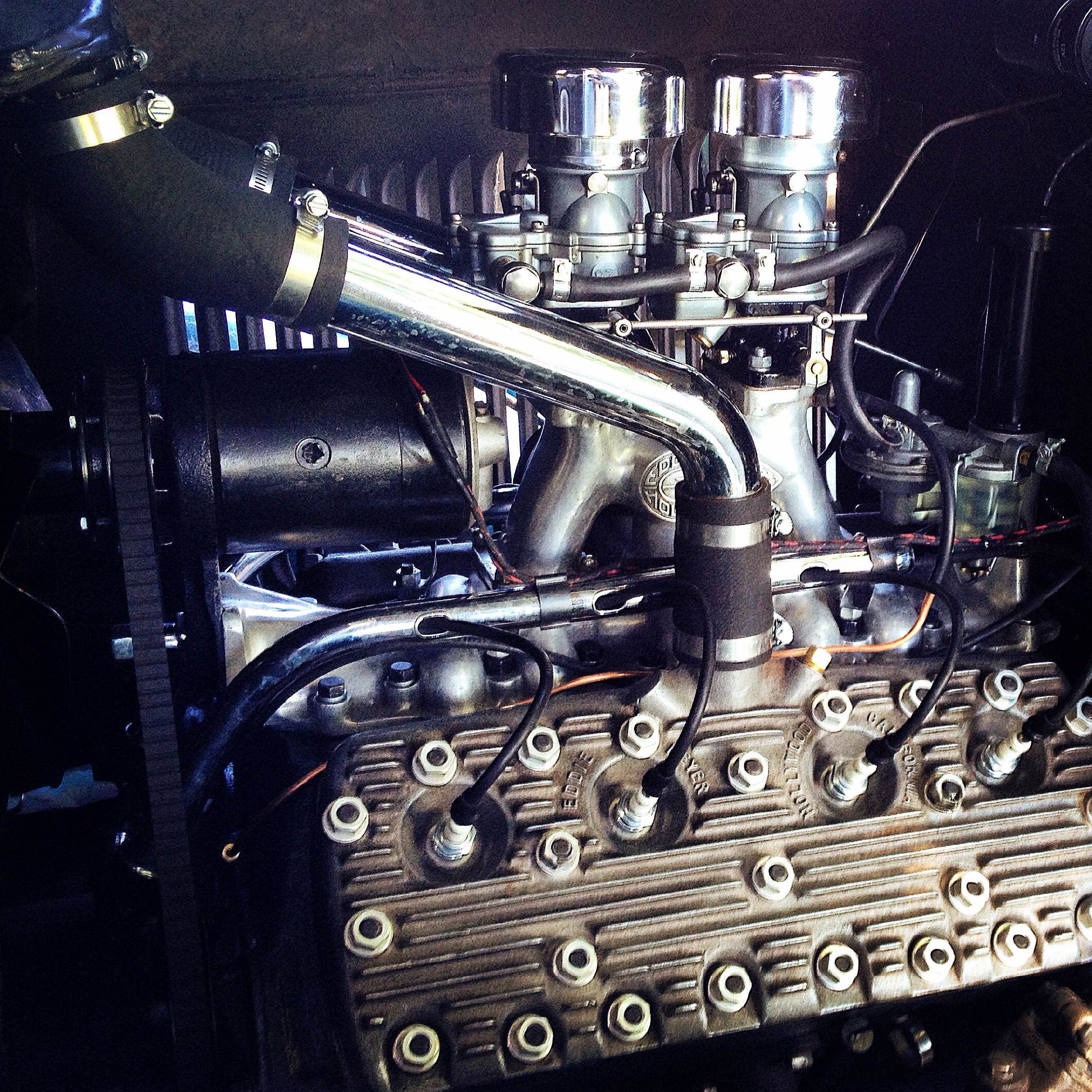

    I'm gonna pull the intake off if it soon. It has what feels like a vacuum leak for a while. I put a vacuum gauge on it and at idle it varies about 10 lbs...I cannot find a leak so I am going to pull the intake, check it out and go from there
  23. start spraying some wd40 around manifold when its running, could be carb not intake.

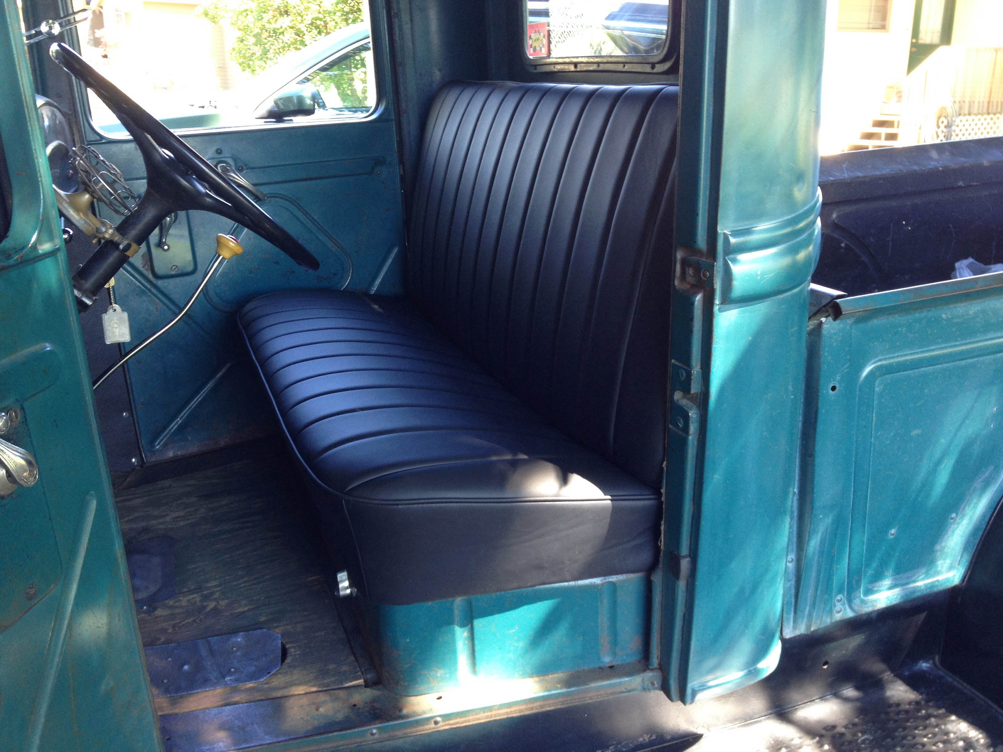

  26. Engine.jpg seat.jpg Had the seat redone in black leather, got it back over the weekend. I was also chasing a vacuum leak and pulled the intake off. Replaced it with an original Eddie Meyer intake I picked up. Back running, leak gone!

    Nice seat Chris, I love your truck to the point where I might go pull my seat out of the attack, grab the steering wheel from the hook on the wall, sit down, with shifter knob in hand and make big cam noises.
