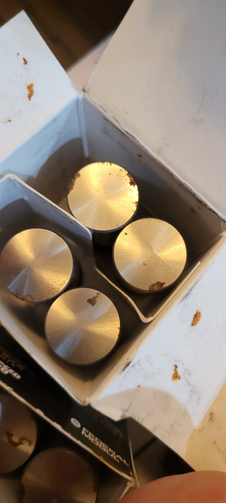

    I am building a SBC (Probably from a Corvette :eek:).
    These are the new Speed-pro hydraulic lifters part number HT-817R. (The "R" must indicate rusty edition) They were mail ordered and arrived in the original packaging from Advanced Auto Parts. The discoloration is mild corrosion or rust.
    My question is should I go through the h***le of returning them or use a scotchbrite pad or 800 grit sandpaper to clean them up? The rust is only on the areas shown in the photos.

    ***uming you bought these recently ,absolutely , return them .
    If you've had them for a time ,penetrating oil & a rag , no abrasives !

    Send em back that's BS. Lippy

    Wow, those are Fugly.
    Depends, are you willing to risk a cam replacement?
  5. I wouldn’t use those on a bet!! Send them back from whence they came.

    You paid for Brand New, Ready to run part's... Those are NOT it!!! Send 'em back.
  8. Given that "perfectly" good new lifters fail all the time why would you chance it?

    Junk, order quality lifters from Jones Cams, USA made, pay the correct price for quality. Do some research on the **** that companies we used to trust, 30 years ago, are selling. Melling, Sealed Power, Comp, don't use them anymore because quality is terrible.

    That rust is a blessing. It made you question them and now your not going to use them. Lucky you. Return that junk to sender.

    But the bottoms are supposed to be convex, not flat. I'd send them back.

    Do you suppose the "R" might stand for Resurfaced or Refurbished?
    The machined finish on the faces looks kind of strange to me. The straight pattern running radially from the center of the face just looks out of place. It makes it look more like the convex profile of the face would almost be more conical rather than a smooth radius. Maybe it's the lighting.

    Is there a cam grinder in your area that could help you evaluate these things? As was pointed out above, could the "R" denote resurfaced or refurbished? I would sit down with a mic or calipers and measure each one to know what you have. Do they all match?
    It might be possible to clean and polish those to a satisfactory finish, but you'll still be at the mercy of the worst one.

    Given the dude is in Norway I'd be inclined to get a local to reface them but I'd be contacting the supplier and let them know of the issue. If they are sent back who know how long before another set turns up and what if they are just as bad?

    Possibly a run of counterfeit parts, or someone cut corners on a cleaning process. Most lifters I used to get were well-wrapped to prevent **** like this from happening. Maybe they were reboxed and the protective coat of lube was washed off them.

    that is exactly what most aftermarket "new" lifters are. i read some time back this is one of the causes of lifter failures. while dimensional checks etc. may be done easily enough, if a heat treated part is re-ground, re-heat treating is hit or miss, if an option at all.
    also, Iron oxide(and most all oxides) are actually harder than the metal was before it became oxide. so no,, you certainly don't want hard spots of rust rubbing against your new cam.

    I agree with Claymart that the finish on the face doesn't look right, or at least it doesn't look like the finish on any quality lifter I've ever looked at.
    Also, although there's no side view to compare, the chamfer on the edge of the face looks too large. Standard is around .010" just to break the sharp edge. If the combination of lobe profile and chamfer depth causes the lobe to contact the chamfer then the cam will be destroyed. As one writer put it, this is something that has always been known, but never presented a problem prior to the widespread use of imported lifters with poor quality control.

    IF......you are stuck with them, you might try hydrosonic cleaning in some kerosene. If you dis***emble and soak them in kerosene for an extended time (a week) it should disolve the rust without harming any surface finish. I have never tried using kerosene in a hydrosonic cleaner and don't know that it might not catch fire, but doubt it. I figure the hydrosonic action coupled with the natual ability of kerosene to disolve rust would do a through job. I would however attempt to get replacements as my first course of action.:)

    Recent purchase or? If recent send them a pic and have them send you a mailing label.
    Also ask for an RMA so when they get them, they can easily receive them and send out a good set.

    Nothing more to say here. Contact the seller, get a return authorization and send them back. Parts are to expensive today to accept those.
