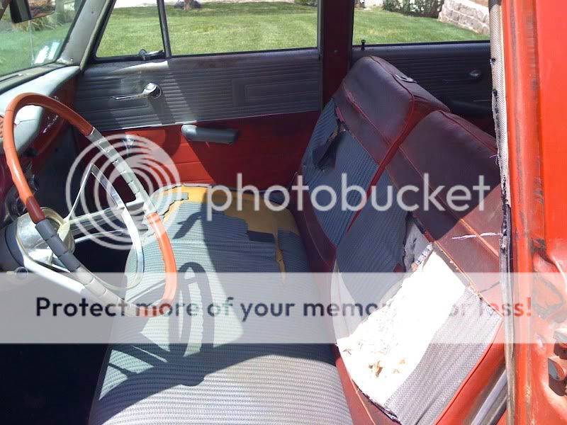

    F@#* mice!
    Stage 1 of the cleanup.. no real scrubbing yet, just cleaning out the big junk and what was left of the plastic seat covers. So far, still no rust.
    Hopefully will have time for some proper powerwashing and scrubbing tonight and start on the paint tomorrow.
