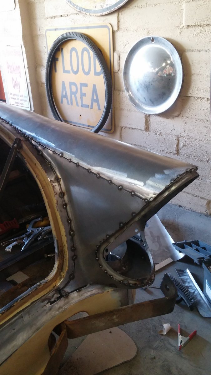

    Man it's looking great! I'm no body man, but it seems like it would be really hard to get the two sides to match. Is it just experience and a good eyeball?
    chryslerfan55 and rytang like this.
  5. rjones35
    Joined: May 12, 2008
    Posts: 865
    rjones35
  6. rytang
    Joined: Jun 29, 2016
    Posts: 449
    rytang
    from Arizona
    It was hard. I feel I got lucky most of the way. I measured a bunch... I mean a bunch!! Im still measuring! But I also took the time to use the peices cut out from one side... And make reverse templates for the other side just to mark where to cut. Then used the templates from the other side to make reverse templates for sheet metal. So far everything is identical.

    Wow nice job.I also like the dash ,top of cowl and windshield frame.I sectioned my 34 Desoto Airflow.It is a lot of work but well worth it when finished. You will get many smiles per gallon when done.
    rytang likes this.
  14. rytang
    Posts: 449
    rytang
    from Arizona
    Ohhh any pics?? Thank you! All of those things you named took me soooo much time! And I'm gonna end up changing it... Lol!

    An easy way to bend up some beaks is to make a buck out of wood. Take a chunk of wood, use a course flapper disc and go to town. Will make short work out of forming the compound curves you want and both sides will be the same.
    kiwijeff, timmy2times and rytang like this.
  23. rytang
    Posts: 449
    rytang
    from Arizona
    Thanks. I'm doing something similar. I'm using my tubing bender to get an edge, then using a piece of large tubing i got at the scrap yard and bending the profile. Works real well in my head...

    20160721_192857.jpg I know it's not for everyone... But I love it!

  29. Dino 64
    Joined: Jul 13, 2012
    Posts: 2,533
    Dino 64
    from Virginia
    Its been beaked !! Way to go, like the way it follows the shape of the tail light housing too.
