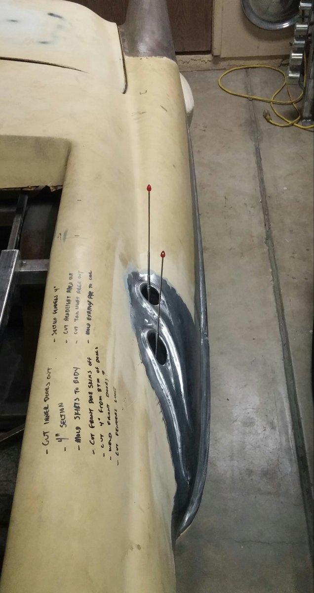

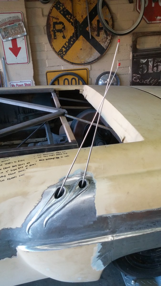

    Thank you. I did use round bar. 1/4" and bent it over an 1 1/2" die, and shaped it on the car to get the curves of the car. Then I shaped sheet metal to the curved part of the tear drops. It looks so good in person, you can see the bar fade to nothing. You can't really see that in the pictures.

    I like the treatment of the antennas. The second photo answered my question about if they touched.

    They do not. They are both angled away from each other. You can kinda see what I mean in the photo above.
