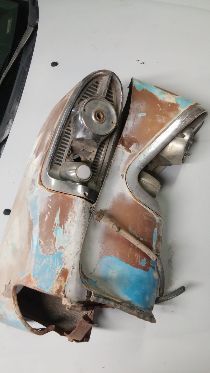

    20160527_210033.jpg Anyone need DeSoto taillights? I don't think they will work for me anymore lol.

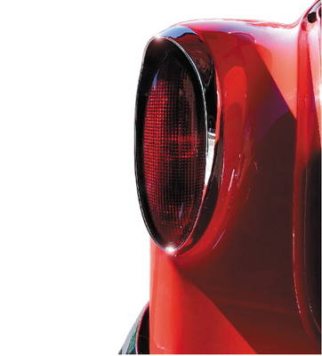

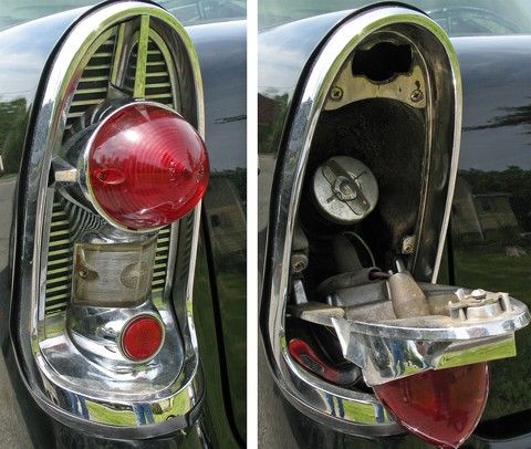

    I thought about those... But they are just too common. I thought about vw snowflake tails too. But I think im gonna end up using 56 bel air tails.

  8. not much different than what you have.....

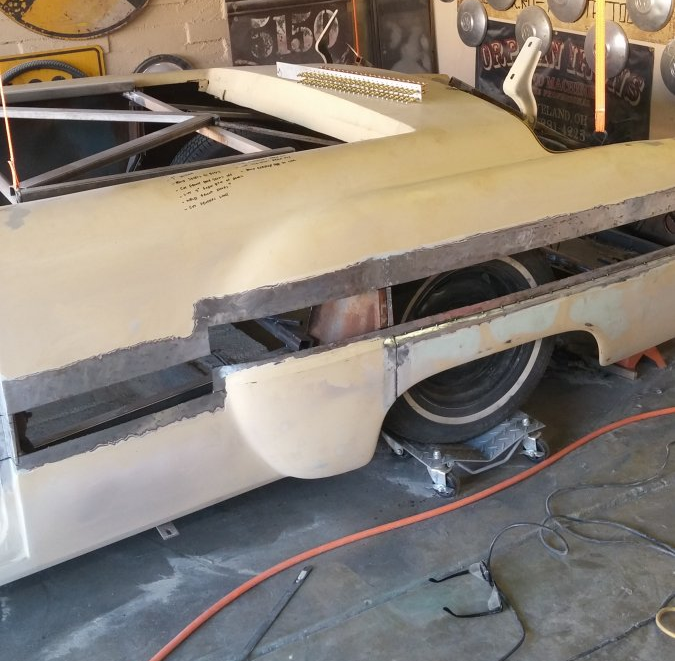

    They definitely will be different. Just wait... Plus I've had them laying around for years. 20160529_175623.jpg

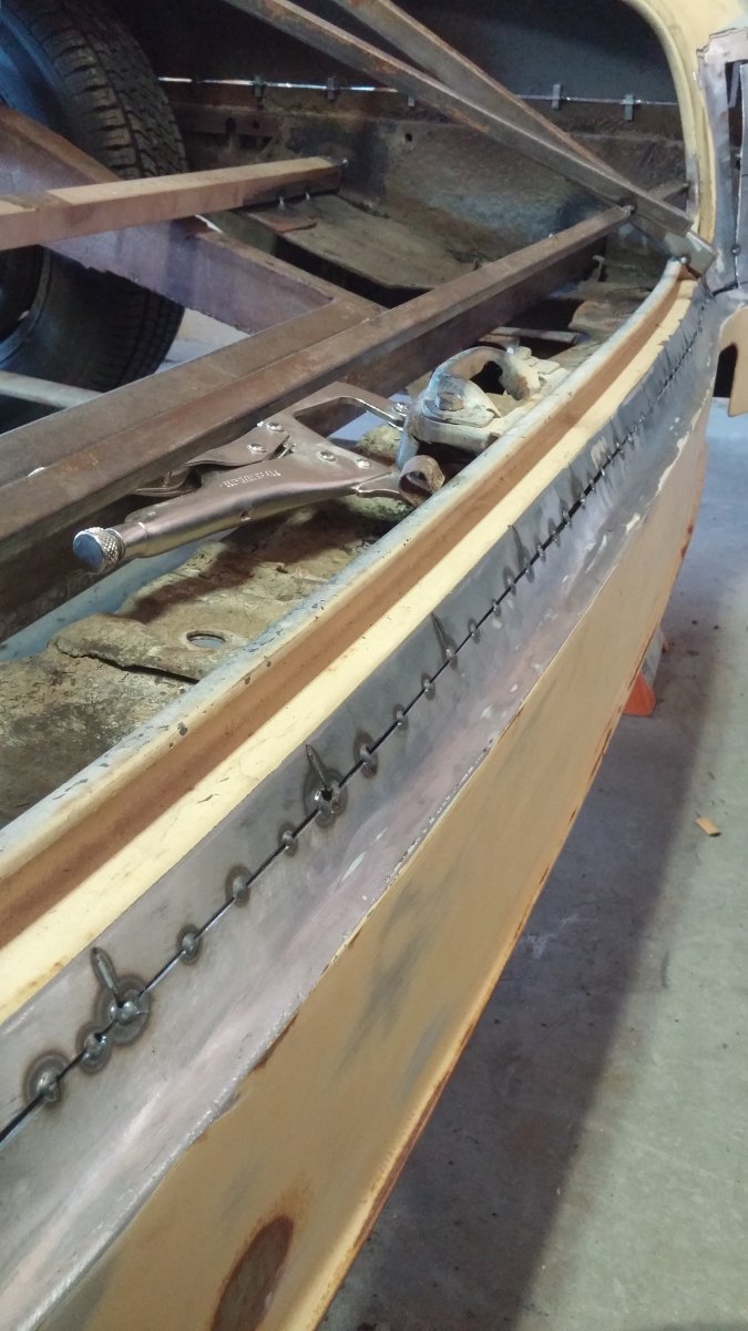

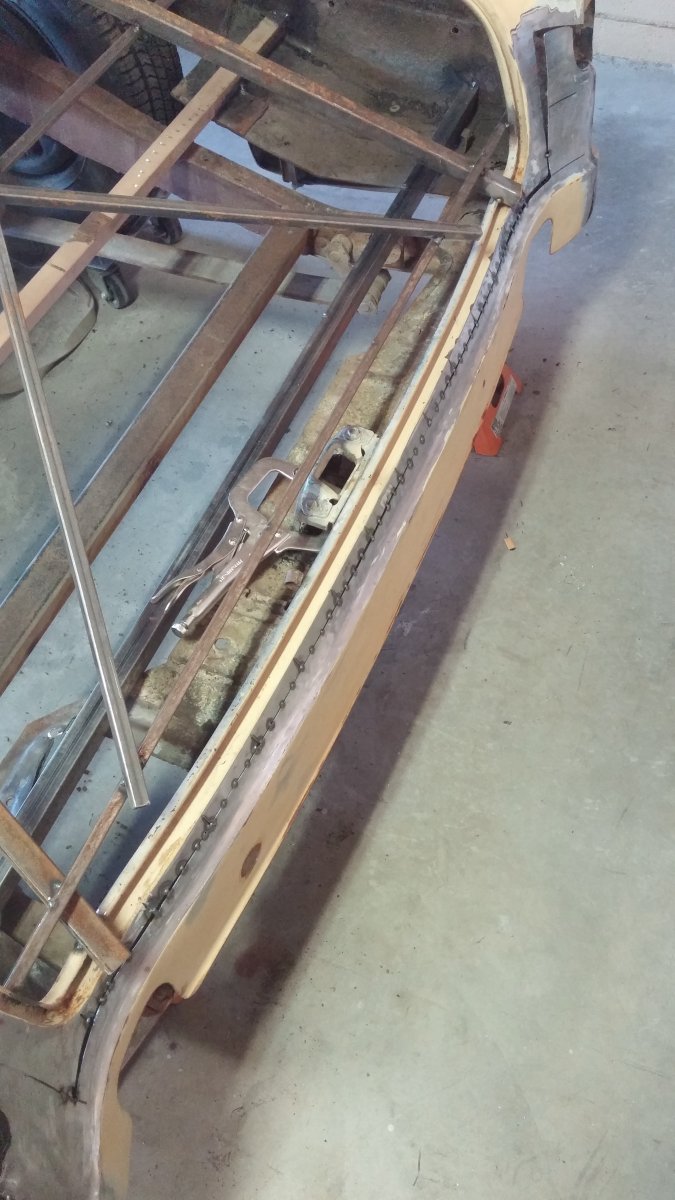

    20160529_175843.jpg Going back together. About another 75 clamps, then start tacking.

    20160528_174100.jpg I'm happy with the 1/4s, but the trunk area is gonna need some work. 20160528_174047.jpg I took the 4"s below the trunk. Which meant the top is about an inch or so more forward. So I'll work this area now. I'll let you know how it goes tonight.
