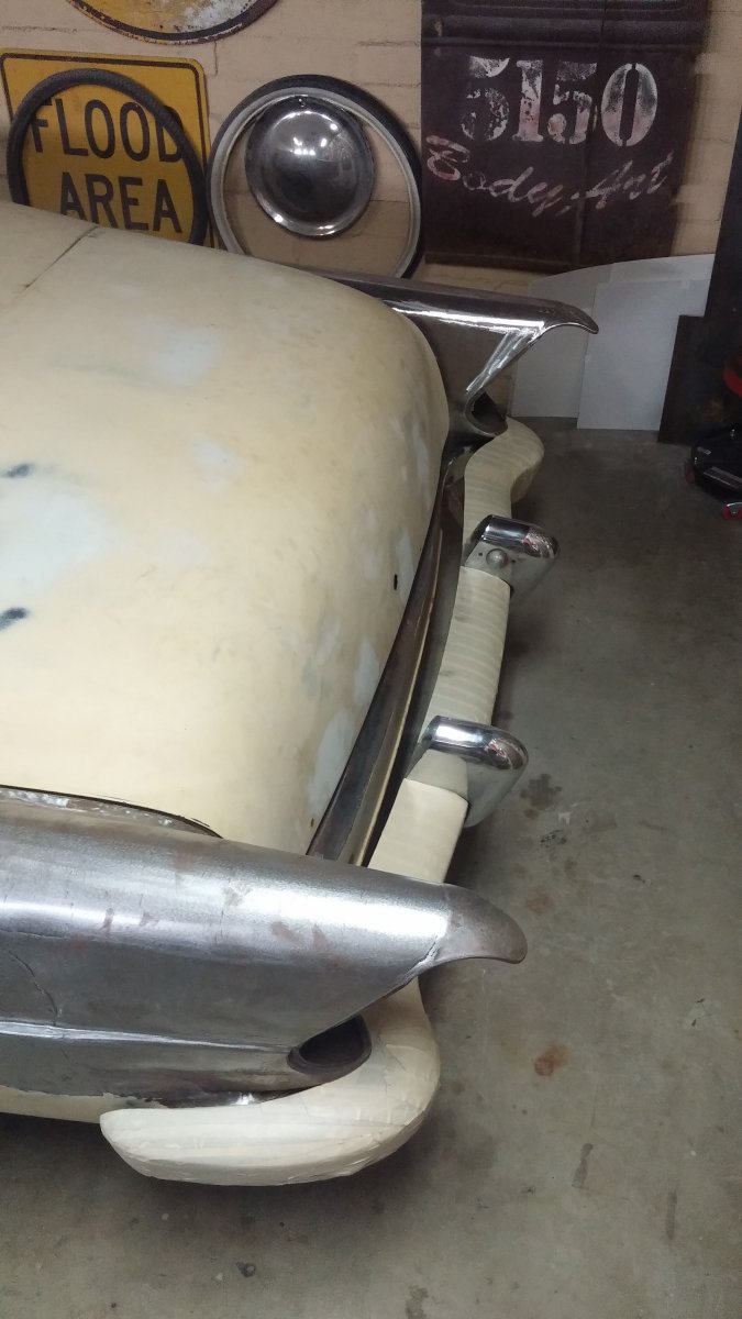

    Here's a top view. I'd like to make the car body fit the shape of the bumper. Then I'm thinking cutting the roll pan and everything on the bottom off. I've never attempted this before, or seen it done. I'm not really sure how to tackle it. I don't think I want the body to over lap the bumper, but sit right up next to it. On the sides too.

    Gotcha. Find @xderelict build on his 54 Chevy custom -rip- and see how he did his modifications. He used a lot of round tube framing and then fleshed them out.
    I'd get a fat solid rod and bend it to match the bumper, clamp that in place, make a cardboard template of the gap and make that out of sheet metal and tack it to the rod.
    Then take it off the car and weld it up and either weld on a flange or if you change up the steps a little use a shrinker/ stretcher to bend the back edge into your shaped flange.
    Then that flang bolts on or I guess if it's all one piece you could weld that on or make the rod go all the way around and weld that onto the body? Figure the rod gives you a nice edge and should make it nice and ridged.
    Just thinking out loud.
    rytang likes this.

    You could cut it and re-weld behind the guards to hide the joints and not have to re-chrome. Maybe make a template of the outside shape of the bumper and hold it against the quarter to see how the shape matches up. Perhaps the big flare away from the body now at the front sides won't matter and the outside edge will fit the shape of the quarter just fine.
    If it were mine, I think I'd recess the front of the sides in about an inch or inch and a half and let the bumper stand out a couple inches from flush. Just set it in a pocket with about 3/8 or 1/2" all around it. An idea anyway.

    If you bring the body out to the bumper, leave room between the body and the bumper for the bumper to slide into and not hit the body if it ever gets bumped into. Long sentence, hope it made sense. Another words make a pocket in front of the rear bumper for the bumper to slide into without hitting the body.

    Makes perfect sense. That was one of my concerns.
