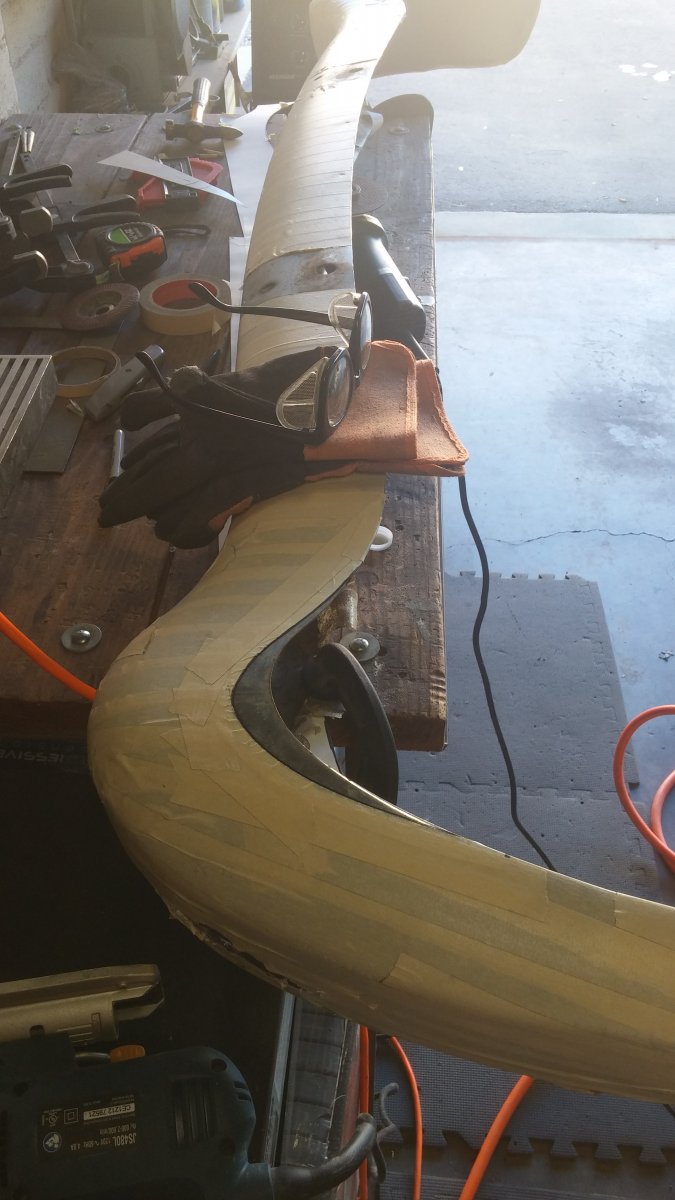

    Well today I got the old roll pan cut off and trimmed, and started making the apron frame. Hopefully tomorrow I can finish the frame. It's hard to tell in the pic, but I got a nice even gap all the way around the bumper. 20160925_184507.jpg

    Fit looks great, is the new apron going to be flat from the body or are you going to flare it out?
    rytang likes this.

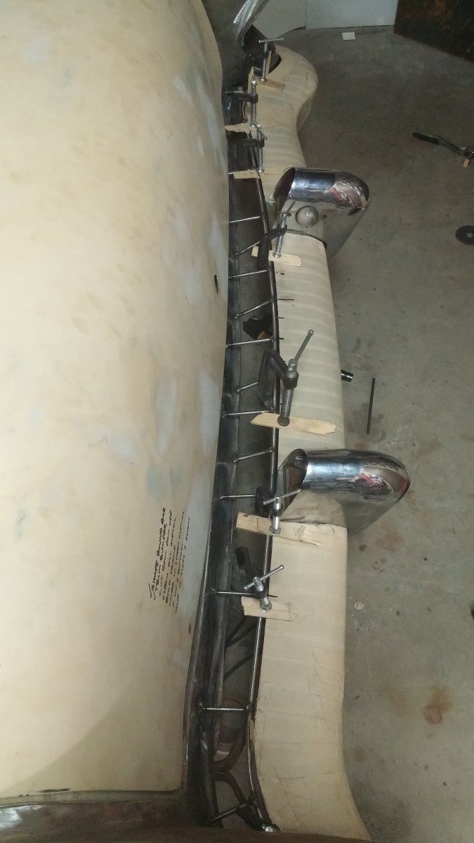

    Got the frame made. Gotta take the bumper back off and finish welding and start sheet metal. 20160926_121534.jpg

    Got the frame welded and ground. Ready to start playing with cardboard! The sheet metal is gonna be tough on this one. I have a feeling it's going to test my ability.
    You can also see I cut the roll pan off in this photo. You can see now how I plan to have this be the bottom of the car.
    It's quite a small body now.
