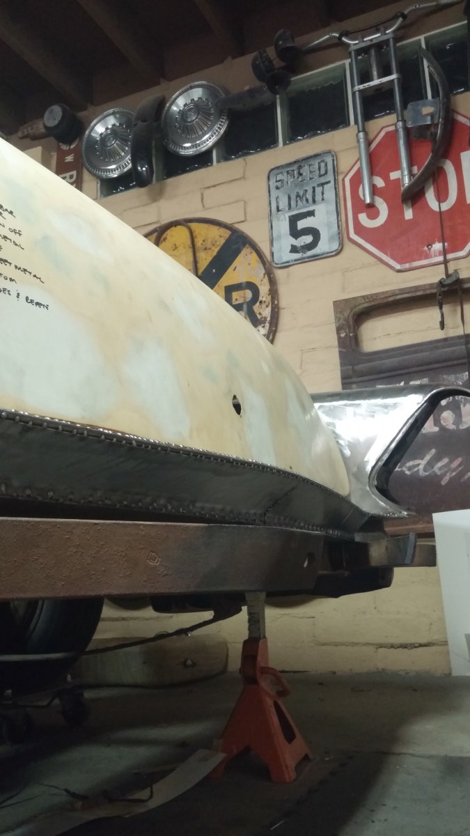

    Really, really hard to get a photo of this... But I started to make and shape the bottom panels. Makes me wonder why I'd spend so much time hand shaping and radiusing the sheet metal, when it's on the bottom and no one will EVER see it... Because it would drive me crazy if I didn't do it the best I could. 20161116_162424.jpg

    Incredibly hard to get a photo under the splash pan, but I got most of the bottom made, trimmed, and tacked in place. So so so much work in this area... Never to be seen when the bumper is on.

    Been following and enjoying this build. Great job. It's worth it cause sometimes it's these details that make a high quality ride [emoji41]

    When i do this works thats not be seen when finnish i take that as a good practice for more visible parts.

    You know on the upside when you get ready to paint you'll have about half as much car to prep as when you started! Might want to build a platform for it however. I can't imagine laying on the ground to wet sand being any fun.
    Hell I can't imagine laying on the floor to weld that splash pan being any fun either but your making it look good!
