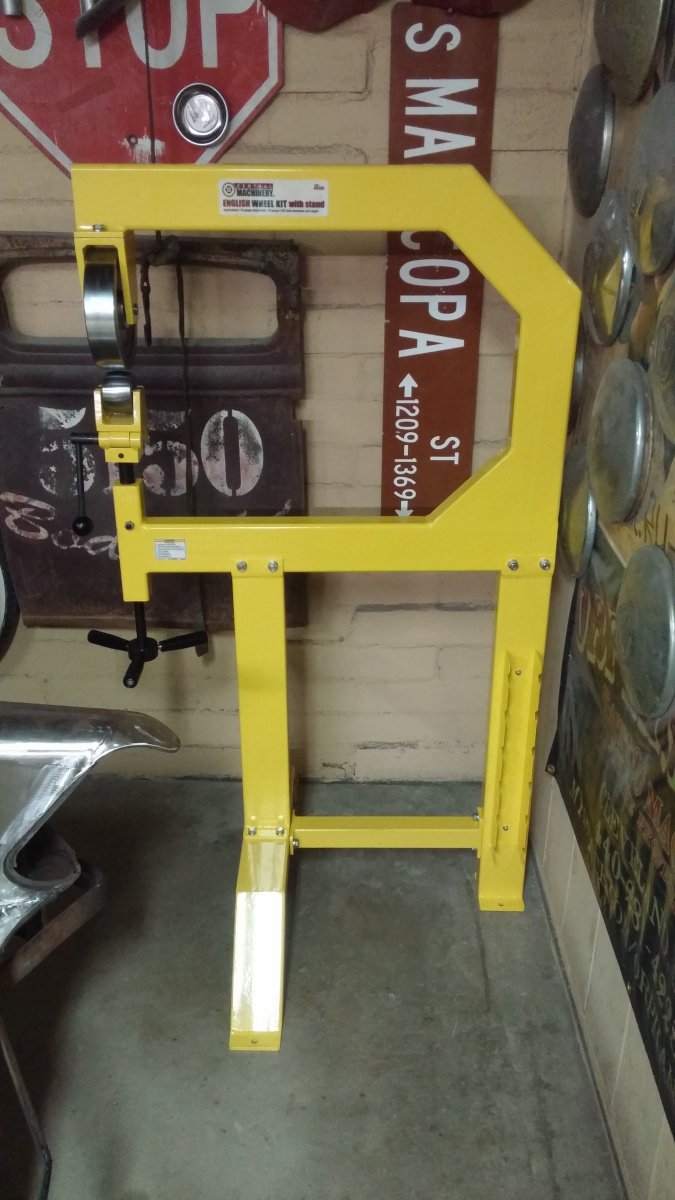

    Got some time in the garage today. Started reinforcing my English Wheel. Still have a lot to do but, hopefully this will help stiffen it up. 20161212_183458.jpg
  10. Nice work on the reinforcing.

    Thank you. I'm glad you're ok. Another custom?? Where? I'm hoping to add a shrinker and stretcher to this too... Just gotta figure out how to make some foot controls.

    I spent the past couple days working on my English wheel, adding my stretcher and shrinker to it. Now I need to figure out levers and pedals. Any suggestions on what to use, or how?
    Here's my progress so far.
    20161228_193958.jpg 20161228_210457.jpg 20161229_174633.jpg 20161229_175343.jpg 20161229_203456.jpg

    I'd suggest making the add-ons bolt on, in case they get in the way of a larger body panel.

    They are both past the throat capacity.
    whiplash1923T likes this.

    You may want to rotate your shrinker and stretcher 90 degrees so you can work the lever....your a hell of a craftsman Bro!

    20161229_174605-1.jpg Thank you! This is a view from the back side. You can see the open area in each bracket here. My plans are to run some sort of linkage down thru there, to foot pedals.

    You could just but the stand from HF and modify their linkage to work with your set up I think the stand is only 60 bucks Hobo Jim

    Well today I figured some stuff out. Then I searched the s**** pile to see what I could use. I made a ton of brackets. Cut some solid 1" bar and welded the brackets on the ends. Then I cut the supplied Harbor Freight handle bars and made some more brackets... Attached them into shrinker/stretcher, then attached the bar. All this times two, for both tools. Now I just need to figure the bottom half. Hopefully this will help some one. I had a hard time finding any info on how people made theirs.
    20161230_153948.jpg 20161230_154124.jpg 20161230_201000.jpg 20161230_201009.jpg 20161230_201037.jpg 20161230_201922.jpg

    Add a pivot point and a foot pedal at the bottom? Maybe make the foot pedal adjustable for stroke?
