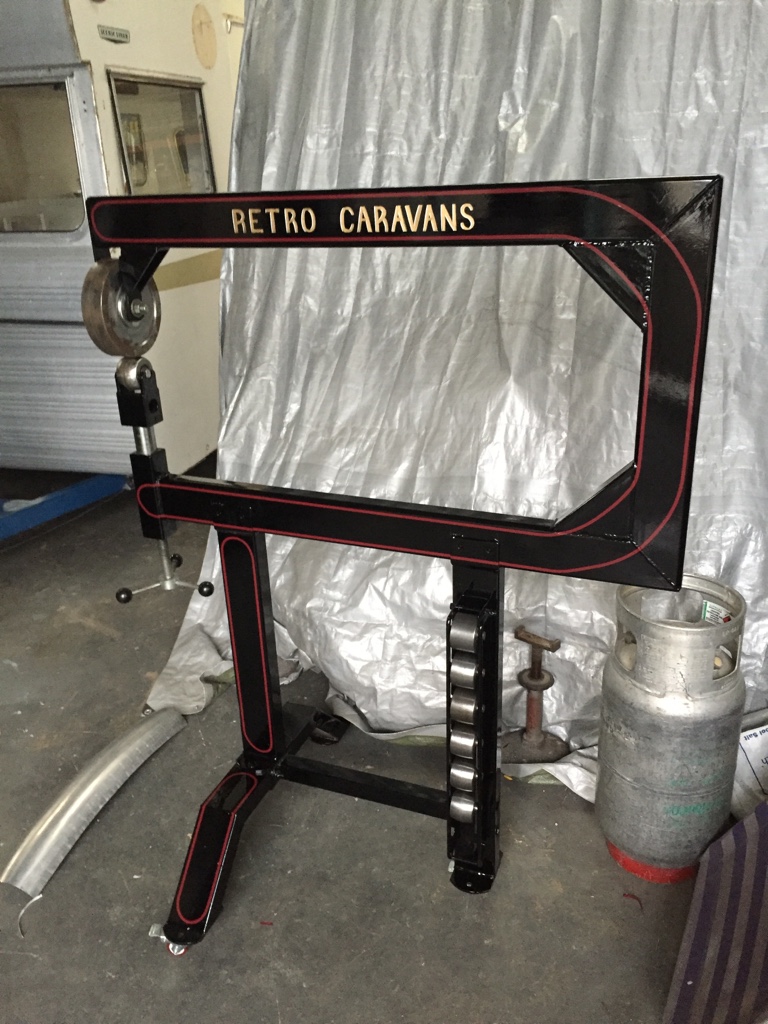

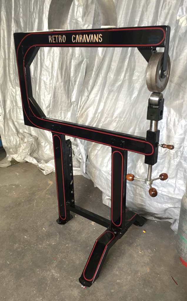

  10. Man, I really admire you get in and give it a go attitude! Good stuff mate. Love the English wheels modifications, here a pic of mine. I tried to make it look like an old cast iron one. ImageUploadedByH.A.M.B.1490173956.182407.jpg

    Beautiful!! I love the wooden knobs and the pinstripping!
