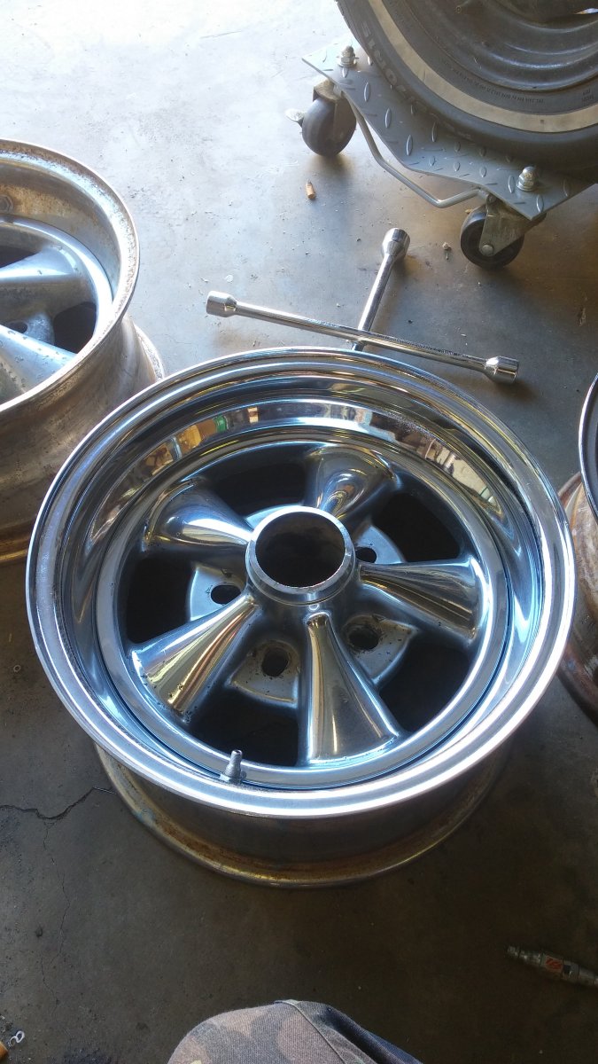

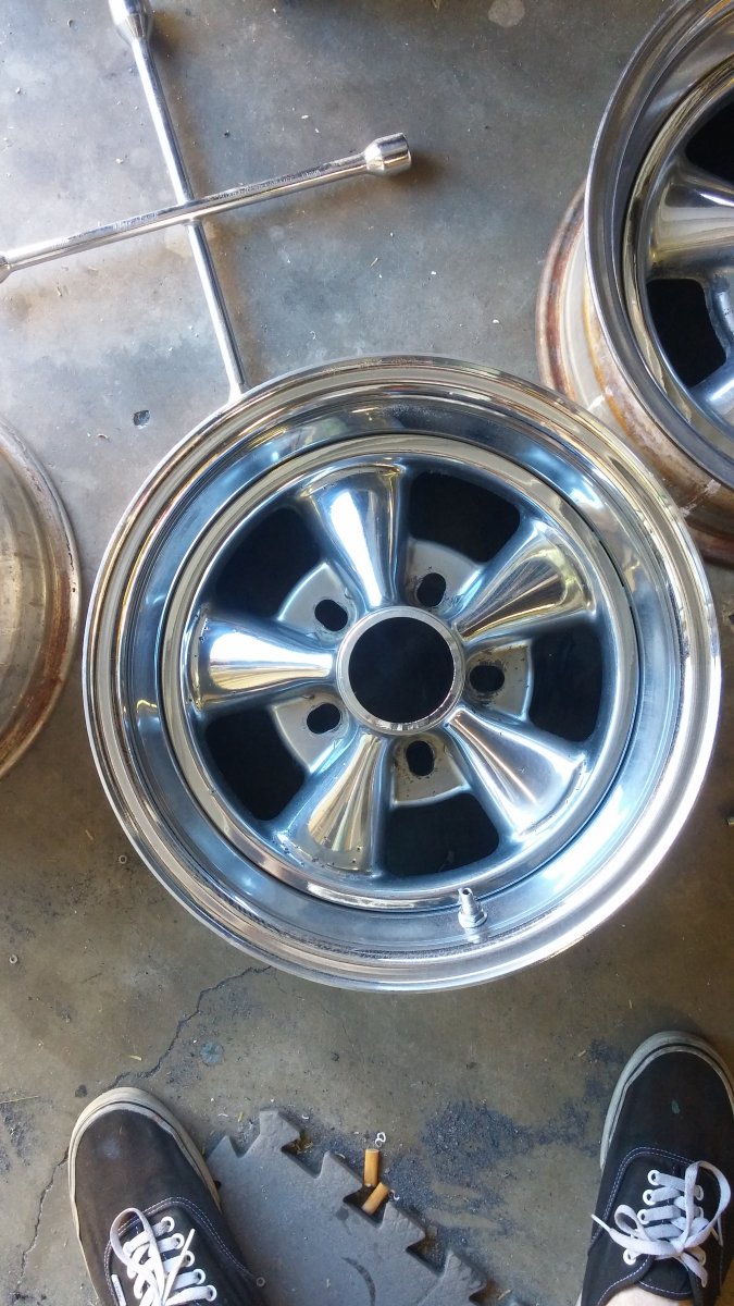

    Those wheels cleaned up great! What you use?

    SOS pads and water. Then Nevr-Dull to polish.

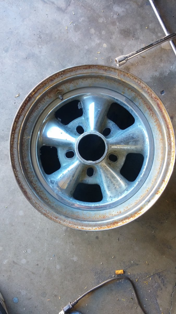

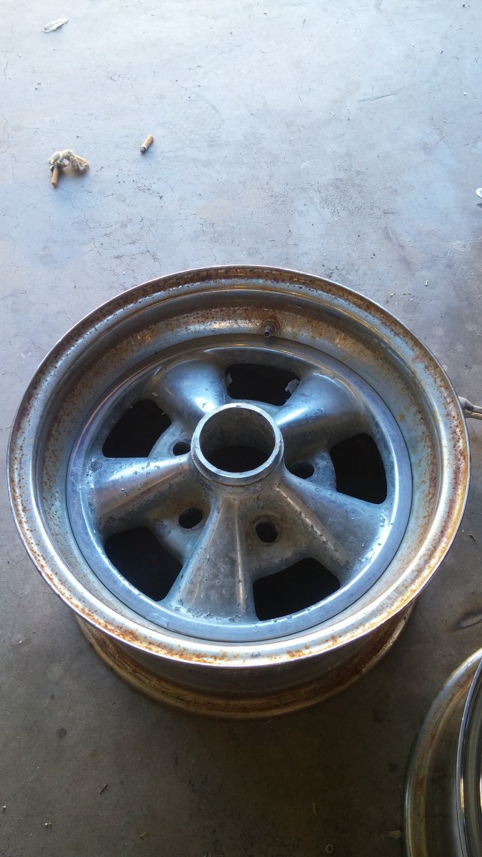

    Well I got some studs made to mount wheels... Found out 14s won't fit over the brakes. So now I'm looking for 15s. Anyone have any cragar ss for sale? Or a similar wheel?
