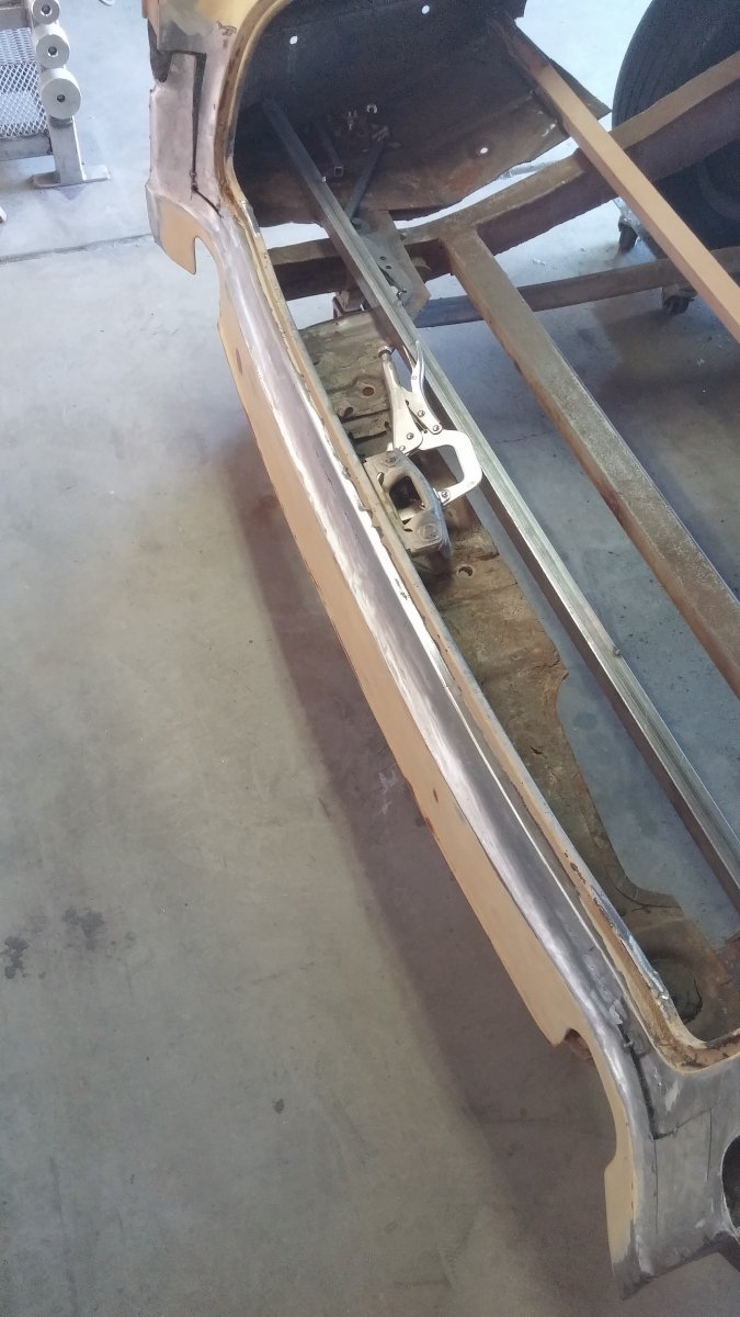

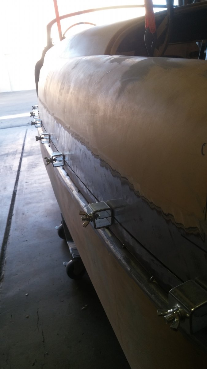

  2. Love this pic of the quarter panel
    chryslerfan55, RockinRivi and rytang like this.

    20160528_174029.jpg Well since you love it... Here's another for ya!

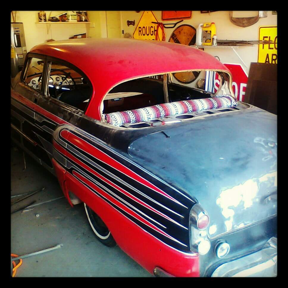

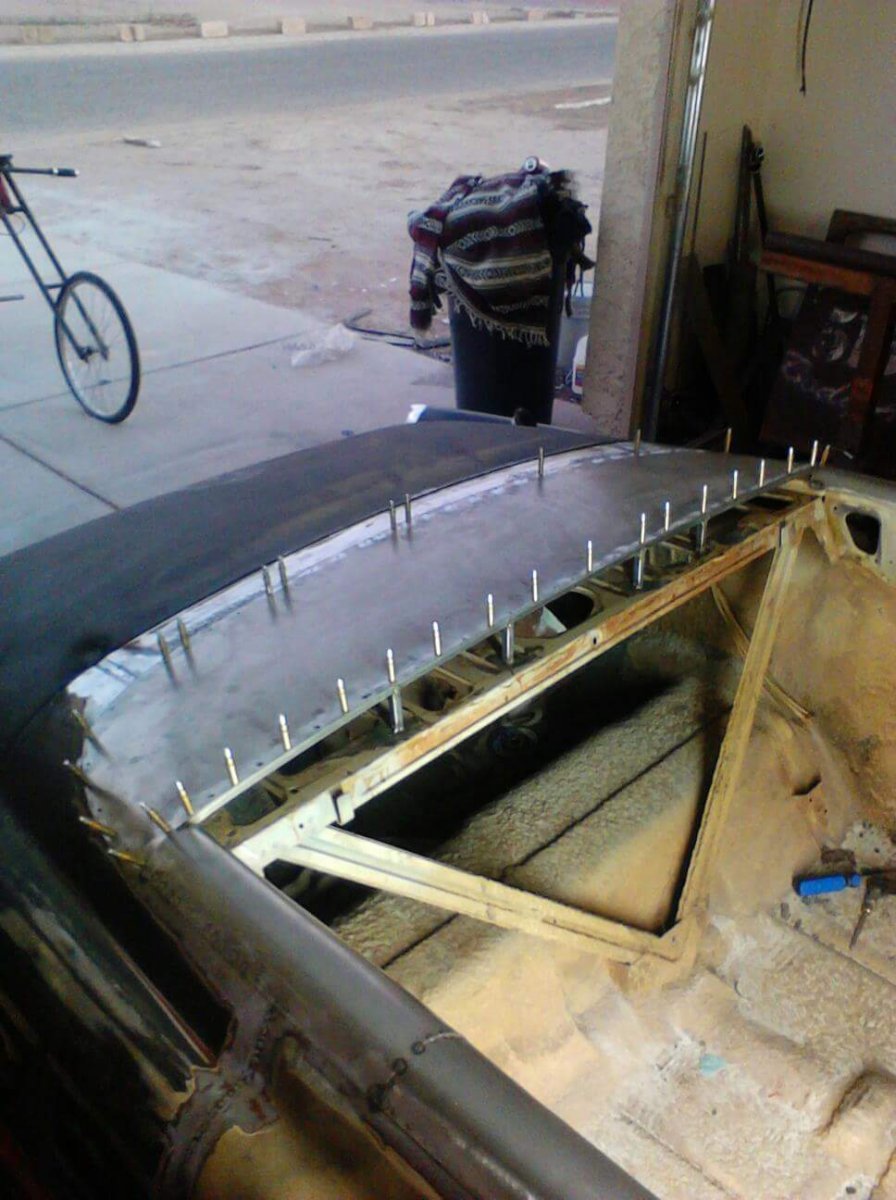

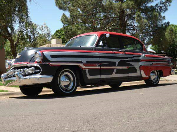

    I managed to find some old photos of the car when I started it. I bought the car to remove the roof. I've had chopped cars before so this time I wanted a convertible. I got the whole car about 90% done, before I got bored with it. I had been doing research on sections for awhile. I fell in love with the way sections make the car look, and not many people do them any more. So I figured I'd give it a try. FB_IMG_1467478896370.jpg FB_IMG_1467478901252.jpg FB_IMG_1467478939774.jpg FB_IMG_1467478944489.jpg FB_IMG_1467478948851.jpg FB_IMG_1467479060481.jpg

  20. rytang
    Joined: Jun 29, 2016
    Posts: 449
    rytang
    from Arizona

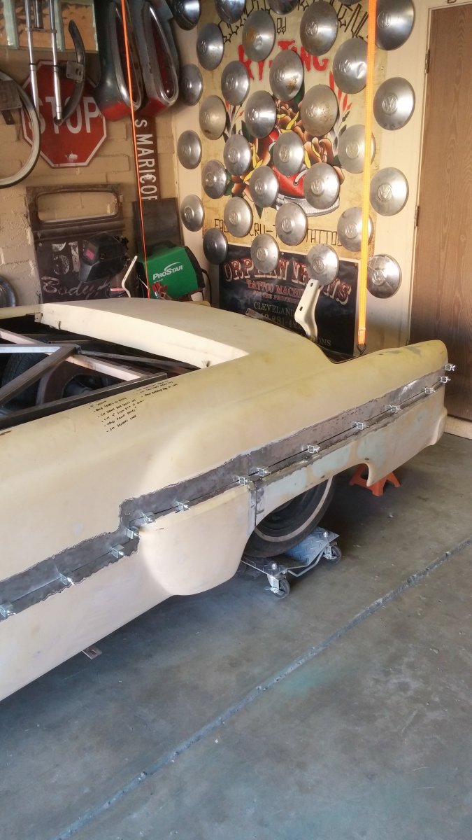

    20160602_182731.jpg Update. 4 inches removed. Tacked, and clamps removed. Lined up all the way around. Door jams are gonna fight me. But I'll figure that out when I get there.
  21. mikhett
    Joined: Jan 22, 2005
    Posts: 1,582
    mikhett
    from jackson nj
    How are you dealing with the inherent metal shrinkage? Are you mig or oxy acetylene welding?Welding low crown panels are a B@#$ch!
    rytang likes this.
  22. rytang
    Posts: 449
    rytang
    from Arizona
    Mig, hammer and dolly.

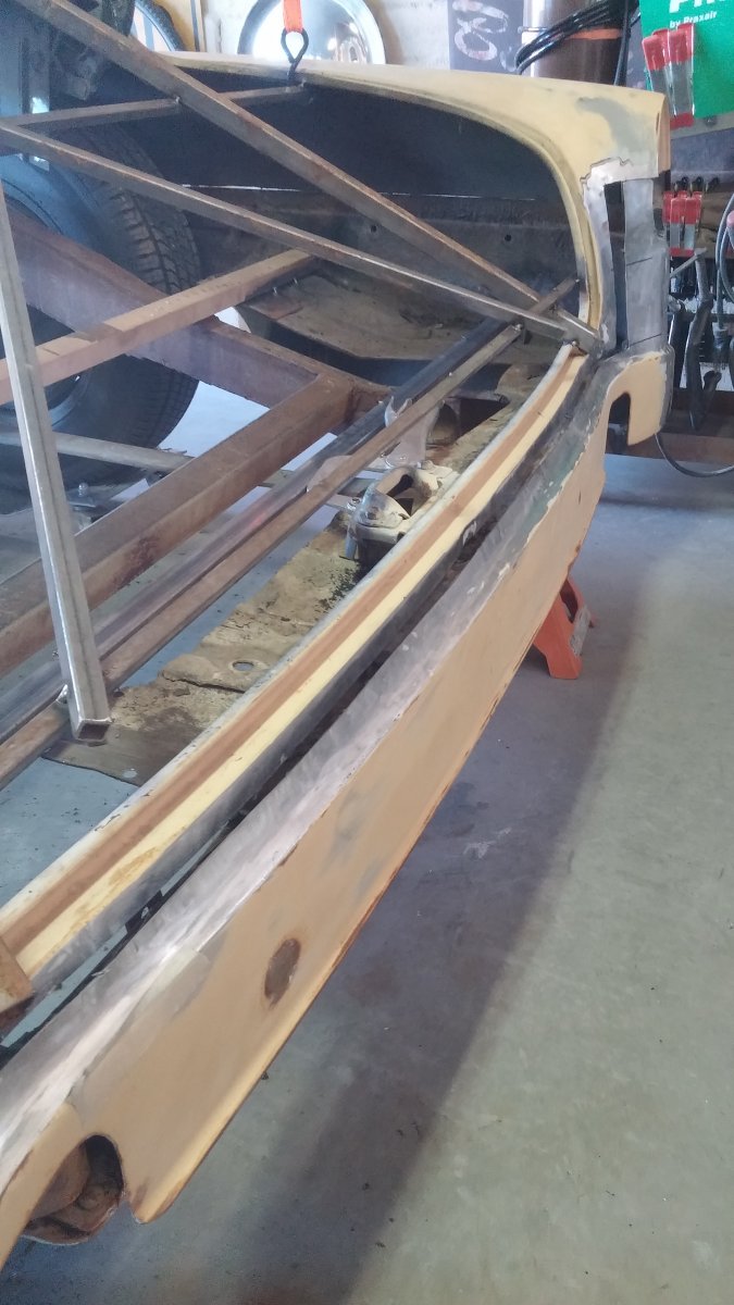

    20160609_164356.jpg Got the trunk area a little better. I'm not worried about finishing it near the taillights, I'm going to cut those out. I also have to go get smaller tires for the rear.
