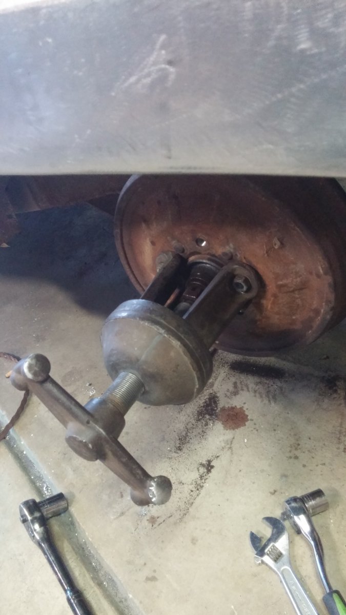

    Update* I'm still working on getting these wheels on correctly. I'm not happy with the studs my friend made, they weren't straight enough for me to trust. Now I'm trying to use press in studs like a few of you mentioned. I took the front 2 to a local shop to work on. But now another problem....... I can not get the 2 rear hubs off! Ugggghhh! This damn car! 20170426_184138.jpg

    Put tension on the hub with the puller, then smack the puller on the side of the round part.

    I have been all day. Won't budge. Breaks castle nuts pretty easy tho.

    Try the old trick of heating the hub and putting some wax on the threads. I have had some of those not want to budge. I made a hub puller I can strike violently if needed [emoji16]

    First always apply liberal amount of penetrant.
    Last step is to use a cutting torch.
    Many steps in between to be determined by level of frustration and availability of spare parts.:mad:

    Pros won't like this, but I would be "tappin" on diameter of the drum at 11 and 2 o'clock with the puller tight, around the outboard edge. I use a 2 pound hammer and hit it hard enough to make some noise.
    If you are worried about marks, hold a 12" piece of 2x4 against it.
    Not responsible for broken parts or fingers.

    Grind the head off of a rivet. Knock the remainder in. Tap the hole for a ****on head allen screw. Put one in. Repeat until all of the rivets have been replaced with ****on head allen screws.
    Then you have a removable drum.

    Which rivets are you talking about?

    The ones that hold the drum on the hub.

    I did this on the last Plymouth that I worked on, and then put in grade-8 bolts, from behind. A drop of red Loc***e kept them in there.
    That was 7-years-ago. Still going strong.

    Isn't the hub/drum splined to the axle? Is the axle nut loose on the axle? I see the nut still there but backwards? Looks like you would hammer on the hub while under pressure. Seems like I worked on a 8n tractor with this set up. Only thing holding together was the axle nut.
