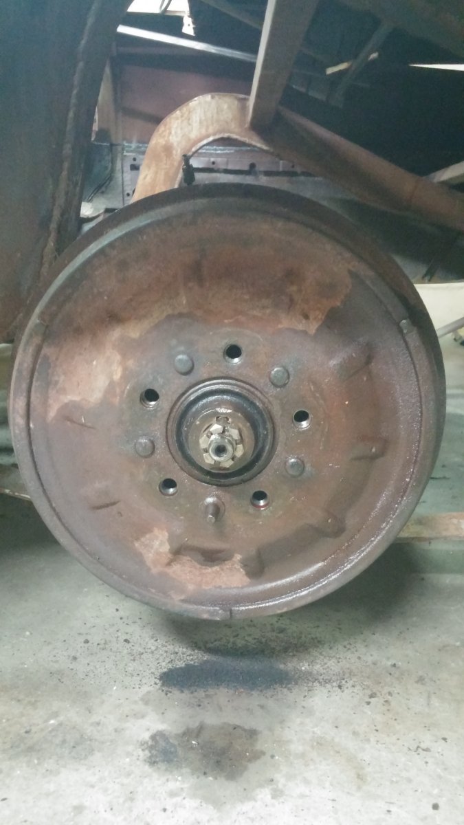

  9. rytang
    Joined: Jun 29, 2016
    Posts: 449
    rytang
    from Arizona
    I kinda understand what you're telling me... I just have never ever ever done anything like this before. I have NO idea what im doing. I even had my big ass friend come over and smack on it... He only broke the other castle nut. The hub didnt budge at all. Can you maybe tell me exactly what im doing when I grind them down? Im sorry! But thank you. I took the tool off, I'll grab a photo of my hub for you. 1493352353026.jpg

  11. gimpyshotrods
    Joined: May 20, 2009
    Posts: 24,399
    gimpyshotrods
    The four rivets that you see there hold the drum to the hub. The pin sticking out makes it easier to mount the wheel, as there are not any studs there to help you line it up.
    The basic procedure is this:
    Throw the lug bolts all in, just to keep it all aligned while you work.
    Gently grind the head off of just on rivet. Try not to grind the drum too much, if at all.
    Yours:
    Take a drift or a punch and pound the remainder of the rivet inward (you will get it out later).
    Take a 5/16"-18 (IIRC) tap, and tap that hole for threads. Put a button head allen screw in that hole.
    What it looks like done:
    Repeat that procedure for the remainder of the rivets.
    Put some Vise Grips on the locating pin, and use them as something to pry against to pull the locating pin out. Tap that hole, too. Put a bolt in that one too.
    Once you do that, you will have a drum that can be removed from the hub, easily.
    Once that is done, you can unbolt the drum, and put bolts (LH and RH as appropriate) in the holes, from the back, sticking out. Then you have wheel studs. Once you are sure that they are the right length, and everything fits, put some red Loctite on those bolts, and let it harden up.
    Then you can get LH and RH mag wheel lug nuts, and get rolling!
    13lav, Squablow, BradinNC and 2 others like this.

  14. The37Kid
    Joined: Apr 30, 2004
    Posts: 32,351
    The37Kid
    I think the hub to axle taper is just a really good fit. That nut is a good size and the guy that put it together may have used a bar with a piece of pipe for leverage when it was tightened. WARNING: Years ago the shop I was working at left a wheel puller set up over night with a lot on tension on it. It popped off and traveled a lot further than you would think. NEVER get any part of your body in line with it, you don't know when it will pop or how fast it will travel. Just noticed you are keeping the axle nut on there, so the above safety note doesn't matter, but if the nut was off things could fly. Bob

  15. gimpyshotrods
    Posts: 24,399
    gimpyshotrods
    Normally on these vehicles, the drum and hub are riveted together. They come off as one piece, or, at least they should.
    You were, as I was, on the right track with that puller. It should have come off that way, hub and drum together.
    I gave up on my job, and decided to find another way. That is when I came up with just removing the drum from the hub. On later model cars, there are no rear hubs, they are part of the axle shaft, and the drum just slips over the wheel studs and that round nubbin in the middle. My trick makes these drums removable, much like a later axle.
    The rivets are not stopping you removing the drum and hub, with that puller. The magic of rust and tension are.
    Drum, bolted on the hub:
    Hub, with no drum bolted to it:
    If you were to get your drum and hub off with the puller, it would look much like this:
    rytang likes this.
  16. gimpyshotrods
    Posts: 24,399
    gimpyshotrods
    This is just a cheat to get you access to the hubs , so you can get wheel studs (and brakes for service), in case the hubs won't budge.
    rytang and brEad like this.

  24. rytang
    Posts: 449
    rytang
    from Arizona
