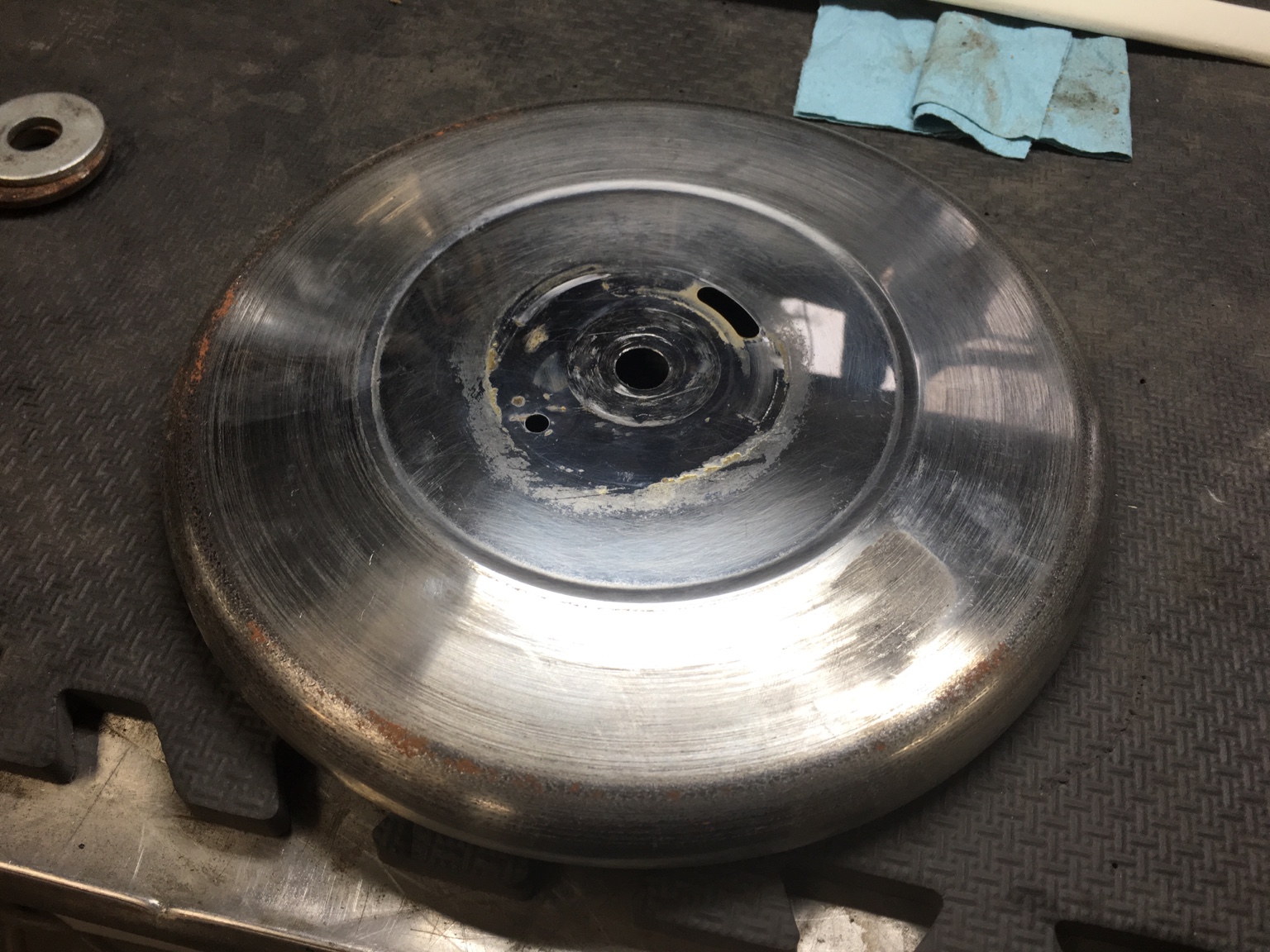

    I made my shrinking disk from a Goodwill stove pot lid.
    $.99 and works like a charm.
    brEad, koolkemp, rytang and 2 others like this.

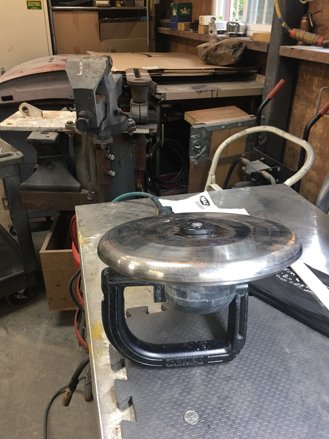

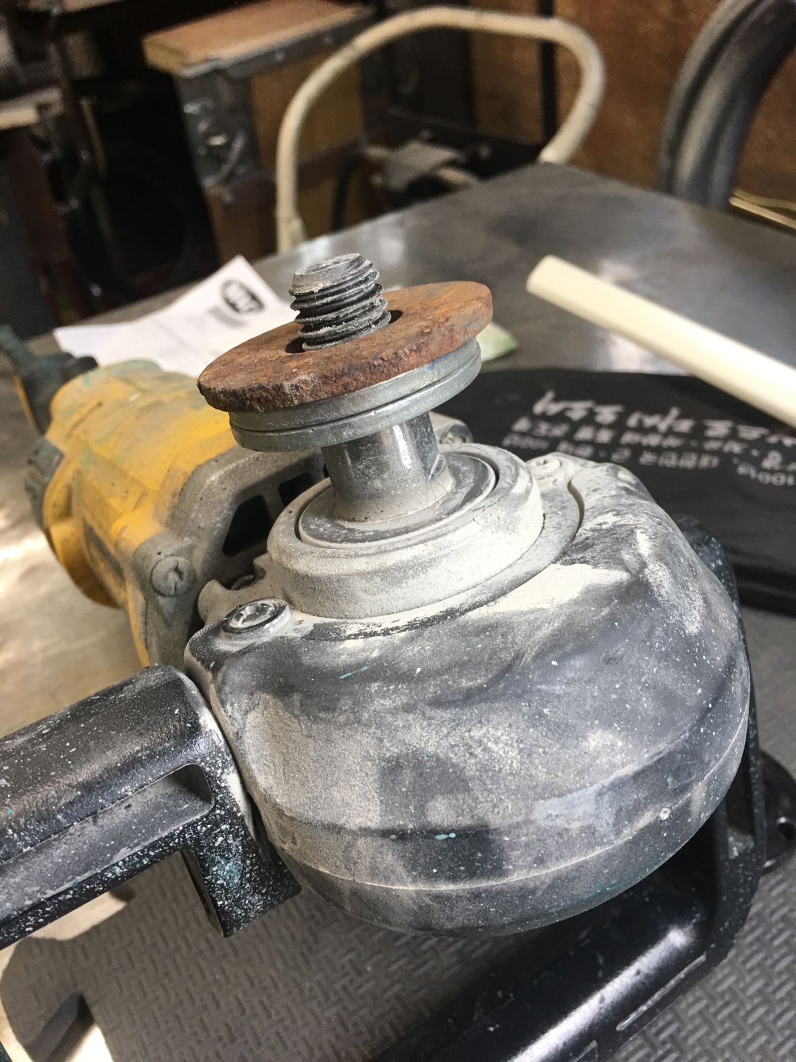

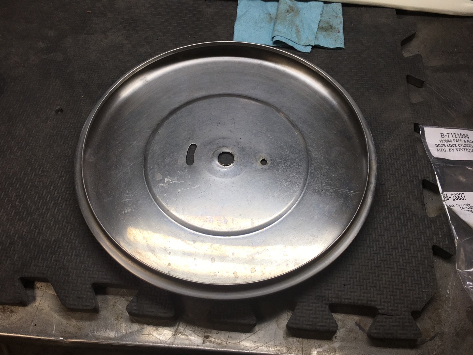

    [​IMG][​IMG][​IMG][​IMG][​IMG][​IMG]
    A few quick pics of the pot lid shrinker. There are a lot of you tube videos showing how to use it. The cutting disc backing is to keep the lid from warping and stress fracturing the center.
