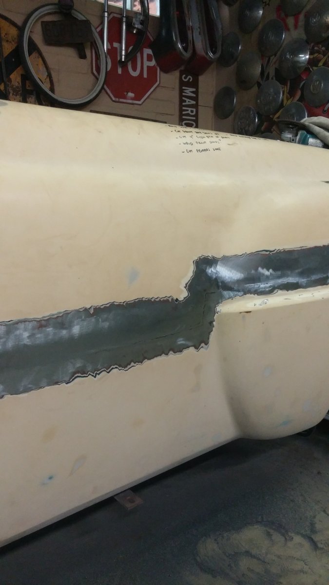

    20160607_172015.jpg Section is coming along nicely. Still tons of hammering and dollying to do...

    Looks great how are able to get the dolly behind the seam for the hammer and dolly work?
    rytang likes this.

    Interior is gutted. Cut out rear door insides and wheel wells. The body is really small now, so it's pretty easy to reach in with dolly.

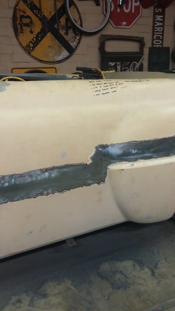

    20160607_172023.jpg Also had to do a lot of relief cuts to keep the round shape on the sides nice.
